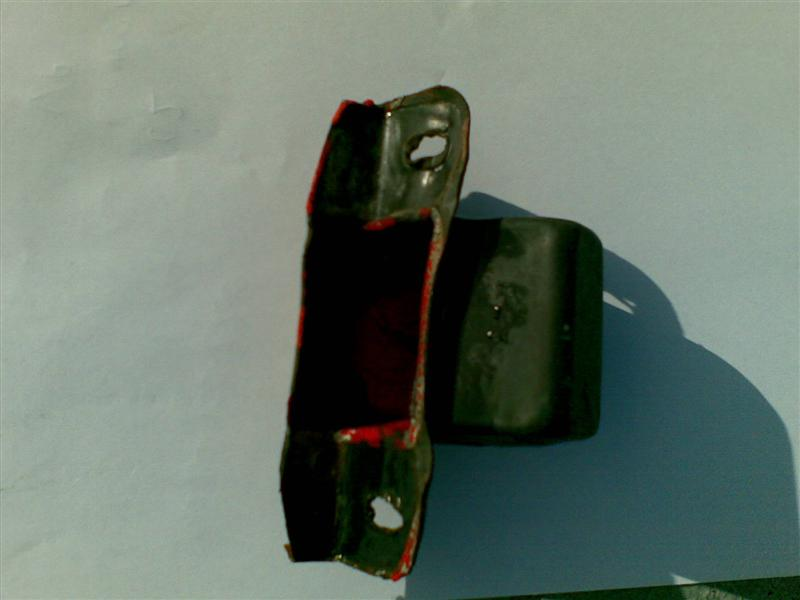

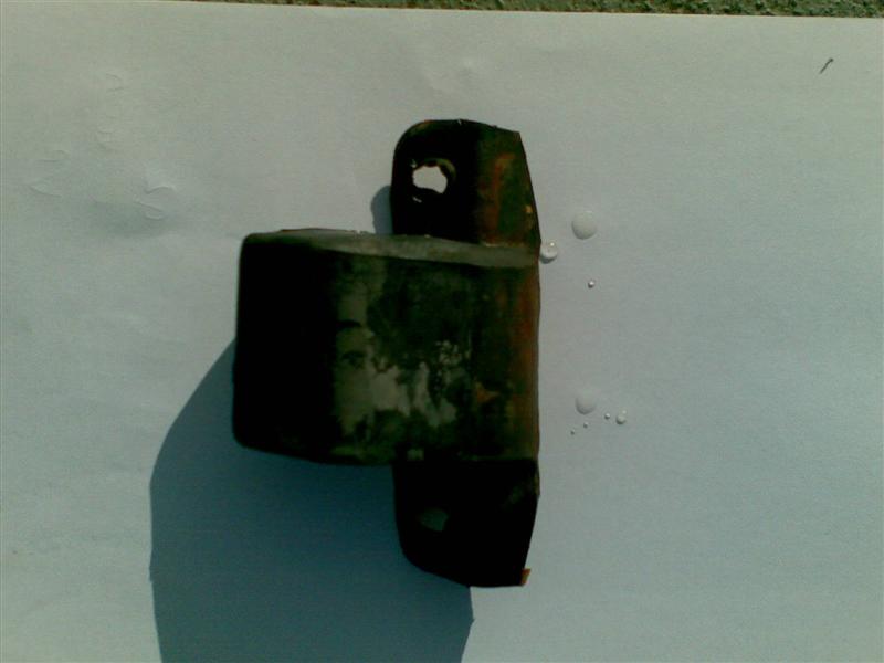

It's me who is making the rubber boots and I've nearly finished the right side mould, about another day and it'll be done, then I'll start on the left side mould
I'll post when they're finished, I've got the list of people on here who want a set and for the time being they will be made exclusively for those members and any other member here who orders a set....the reason being is that I can't mass produce them like sausages out of a sausage machine, I can only make one set a day or one set every other day if you know what I mean

A timeline for finishing the left mould would be about a month, maybe a little more, the right side one which took nearly 2 months, working on it an hour a night, but since I've gained the experience from making that one, the left mould will get done quicker
I'll be testing the right mould soon, then after I've inspected the first boot and tried it in my 240 for fit I'll post some photos
12 years has elapsed since I last made rubbers and metal castings, had to dig deep to remember a few tricks but they came back

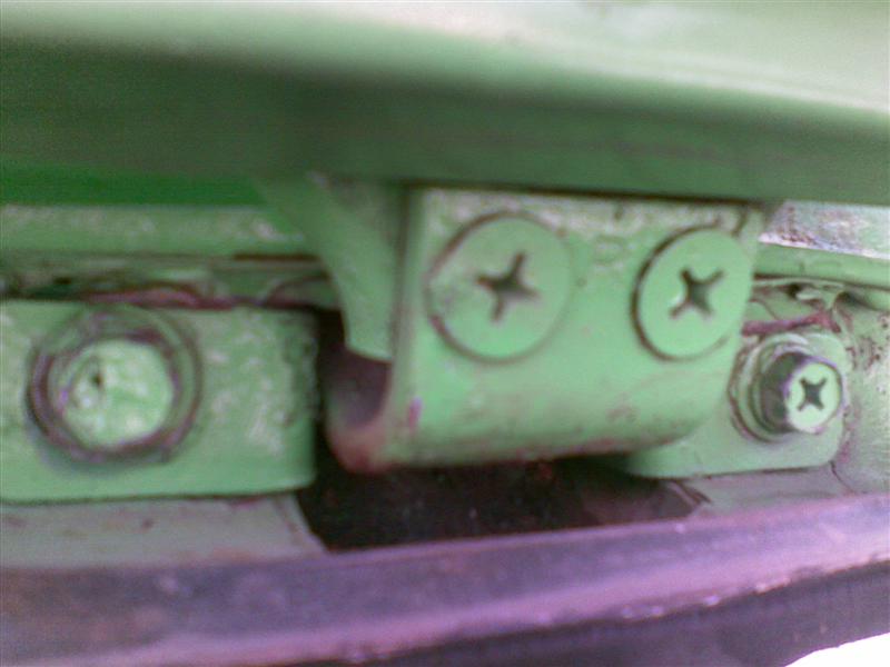

With hinge boots there's a little preparation to do before you fit them, I'll post about that too but you can either fit them right or make a mess of it....one thing that needs looking at first up is the square openings the boots fit into, they must be free of burrs and corners of ill fitting panels, one of mine was like that so out came the file! filed it off
