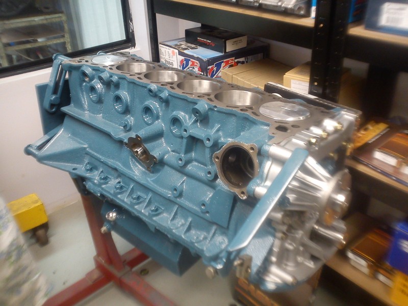

Hi All
Here are a few pics of the 26 im building at the moment.

#31 Ledge
Ledge
  • 871 posts
  • Website:http://www.customandclassiccars.com.au/
  • Location:Mount Barker
  • Tagline:PMC RB28
Posted 13 October 2011 - 05:02 PM
Hi
Brabham, Its a full race motor ie "H" beams, forged pistons , ported head , cams etc Got a custom twin high mount with a pair
of tomei turbos  and gone external oil pump aswell. Hoping for around 300kw at wheels on around 18psi, The motor will handle way more
than that but i built it for reliability more than outright power. It makes it easier when your mate is a race engine builder.
Z  Yeah Kevins 260 is a brute of a thing, Sounds fantastic aswell.
Regards
Paul

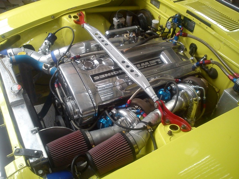

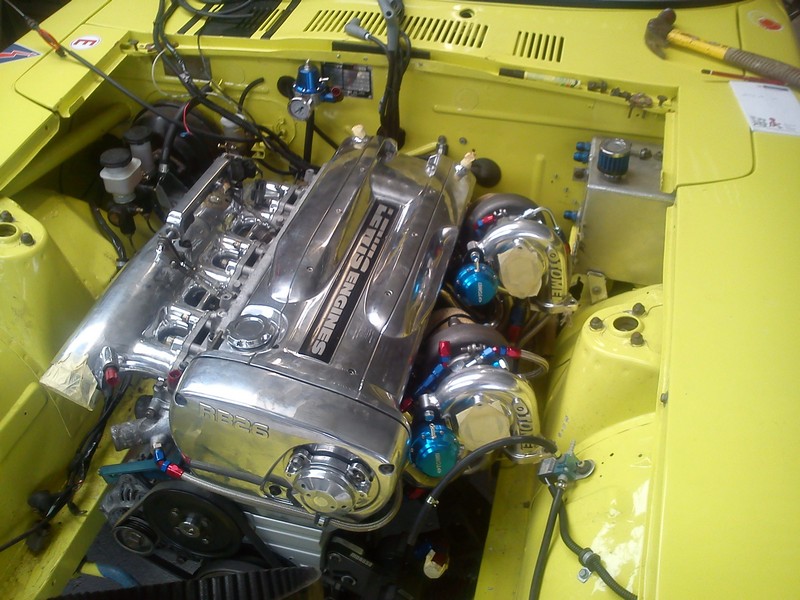

#33 Ledge
Ledge
  • 871 posts
  • Tagline:PMC RB28

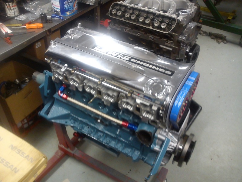

Posted 10 December 2011 - 10:20 AM
Hi
Motor assembled, Just need to fit manifolds and turbo's and its of to the dyno.
Hopefully will be in and tuned early in the new year

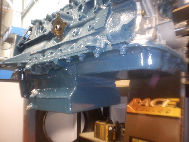

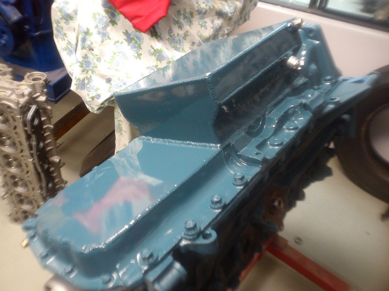

Posted 17 December 2011 - 06:48 PM
Howdy
Just have to do oil and water lines for turbo's and setup the external pump
Really looking forward to hearing this thing.
hopefully it will be in the car in the next few weeks
Regards
Paul
