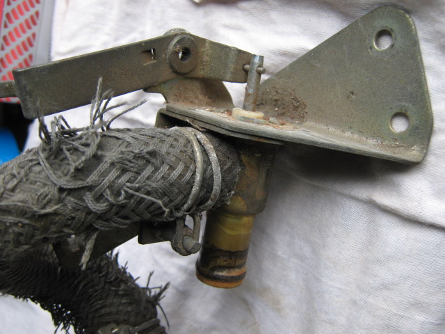

Are these what they look like ? These are useless to me, not 240

Any auto shops sell Universal heater taps.. I worked at Autopro and we sold them.
Posted Image
