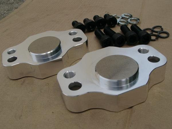

I ordered Roll Centre Adjusters (RCA’s) and Rear Control Arms from Techno Toy Tuning. I already have their front torsion/compression (T/C) bars and LOVE the strength and over-engineering of their parts. I had a T/C snap at 200kph on full brake into an 80kph 90o right hander and don’t need another similar scare again.
Unfortunately the box was pretty tattered when it rocked up and one of the control arms had been damaged in transit
But, Gabriel (the great man he is!) covered the cost of the repairs and so I sent them to a shop. In the mean time I got stuck into fitting the RCA’s:
This pic shows a modified arm on the right of the pic and the unmodified arm on the left of the pic. You can see how the control arm points upwards on the left and down on the right. Down is better =D. Another quality TTT part!
The close fit with standard rims. In fact I had to remove the wheel weights on the front right hand wheel because they fouled on the steering knuckle
The new look front suspension with both of the RCA’s fitted
