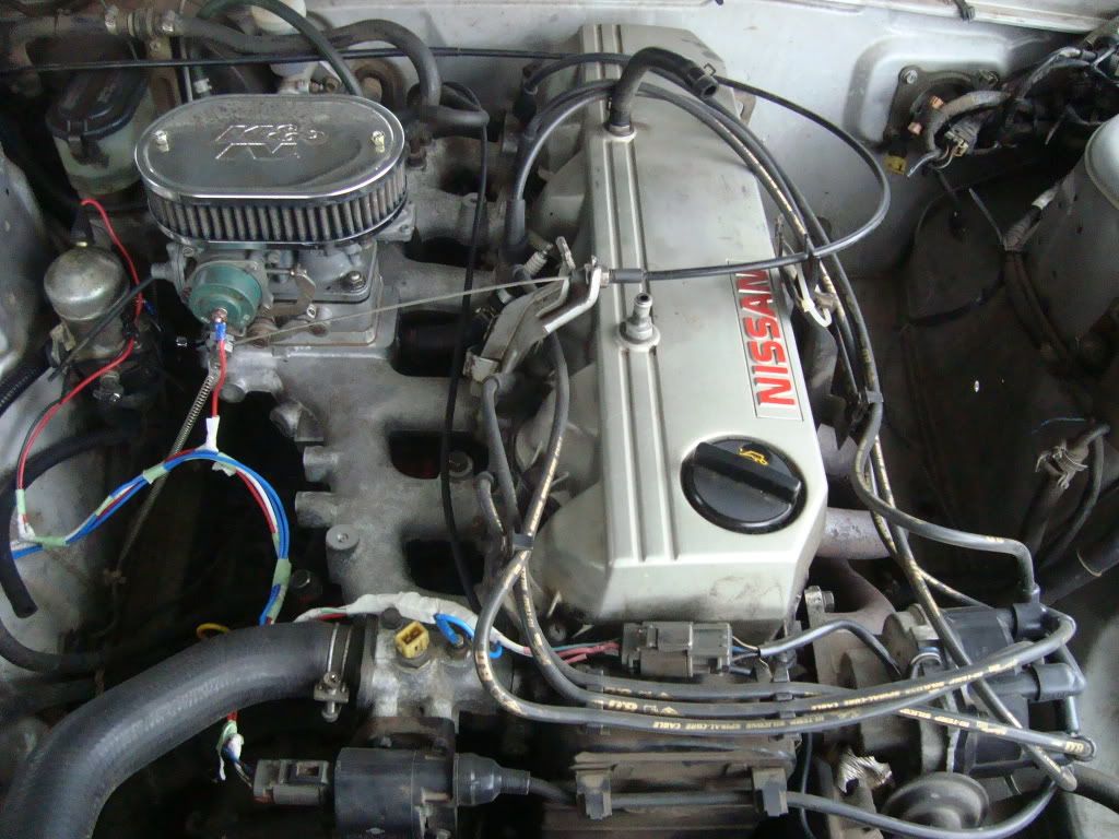

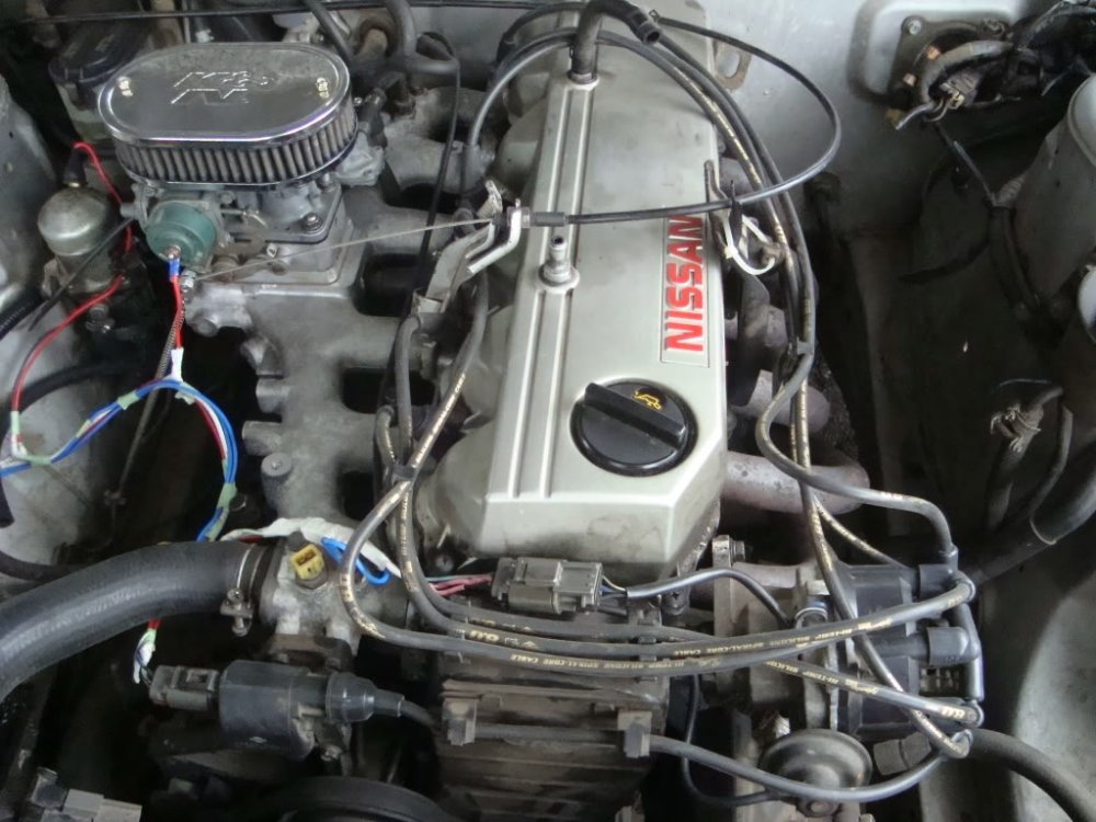

ive just finished my rb30s (carby) project so hopefully i can help you guys with a few things on this build
i have an rb30e in my hr31, last year i found a carby manifold and decided to jam it on befor xmas.... im runnin a standard carb manifold from a nissan patrol, with a falcon webber carb i took off a 4.1 litre falcon (just a dirty old 2 barrel around 300cfm), its now cammed up (290*Lumpy cam), and runs a 12lb flywheel and headers. very simple upgrades and ows me $300nz plus im not complaining yet  8)
Posted Image
(e/ i know the picture looks a bit shady but this photo was from when i first did it last year)
all that's needed to make it run was a vacuum advance dizzy..... with this i can run ANY carb i like if i could be bothered making new manifolds. triple side drafts are expensive and 4barrels cant be modified to fit the stock carby manifold but im sure would make a bit more of a difference.
as for using a dohc head id really like to see this done so if any of you figure out how to do this properly please "LET ME KNOW!!" (mad_max_hq@yahoo.co.nz)
heres what i do know about it.......
first things first your goin to have alot of trial and error testing out ways to make it work (like i already have)
second of all the cam angle sensor will work with out any of the other sensors plugged in and with out the injectors plugged in .... ie exhaust sensor, afm, and tps
i know this because if you unbolt the cas and spin the shaft you can physically watch the spark do its thing in sequence and its a good way to test for spark :P
ive also ran the engine for a short time on start ya bastard haha..... i had no sensors plugged in except the cas and of course no injectors.
only thing im not sure about is it would have only ignition timing with no advance (or just set it to around 25-30*advanced hahaha) and where it advances from. im pretty sure the timing advance is done at the ecu depending on a few variables
eg. throttle position, afm,
but possibly if we're lucky it just does this on revs from tacho signal from the cas
so for a start id just do it!! its goin to work with the standard ecu & cas and is really one of the only ways to find out if it advances at the ignitor pack. if it advances at the ignitor pack/ecu with out the use of other components your done  ;D eeezz peezzy
if not probably best bet is an msd ignition or simaller
sorry bout my SA hopefully this helps and also if anyone can give a second opinion on the ignition side of things it would be a big help.
basically these two questions.....where is advance controled? and what variables does the ecu need to advance the timing?

Factory ecu variables to advance spark would be engine temp. Are you finding that it feels sluggish or retarded and you want to try it advanced more? You can just increase your base timing and see how it goes then. Remember these spin opposite to l series engines. What dizzy did you use?  I think you are a legend for attempting to do this and succeeding. The latest performance imports mag has a few writes up of old jap workshops including rocky auto who they say is doing a lot of na rb30 engines these days. I want to build an na rb30 with dcoe carbs. That would be saweet.
