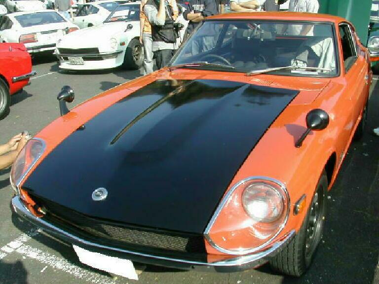

#9 Hunter
Hunter
  • 723 posts
  • Website:http://www.facebook.com/mankiniadventures
  • Location:Rosebery, Tasmania
  • Tagline:www.facebook.com/mankiniadventures
Posted 21 April 2010 - 07:20 PM
432 images

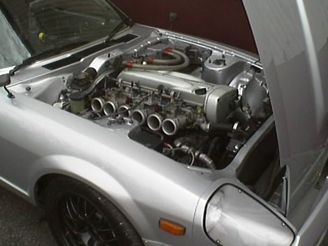

Posted 21 April 2010 - 07:56 PM
Also check my thread out on my Triple DCOE Throttle Bodied RB25/26DE setup. I am thinking I might hunt down some Mikuni 44 PHH or get some new OER 45 for the carb setup....I am very seriously thinking of doing this and have been for sometime - comes down the $$ I already have tied up in the DCOE throttle bodies and ECU
My thread http://www.viczcar.c...pic,3490.0.html
My zed is a Z432 project theme also - but Green with a matt black bonnet, RB engine painted silver like the S20 blocks, twin exhaust setup like the Z432 - it will never be a Z432 just a modern take on the theme. PS30 = 2000cc DOHC Z432. My car RS30 = 260z so factory L26 2600cc (well close enough) now RS30 = 2600cc DOHC Z432 theme 260z. I have 2 sets of 432 badges, 1 set NOS and 1 set close to new with 2 of them missing holding pins.
I am going to custom make/modify a rocker cover also but with 2600 on the top not 2000 again for the overall theme of the keeping with in the original car and a modern Z432.

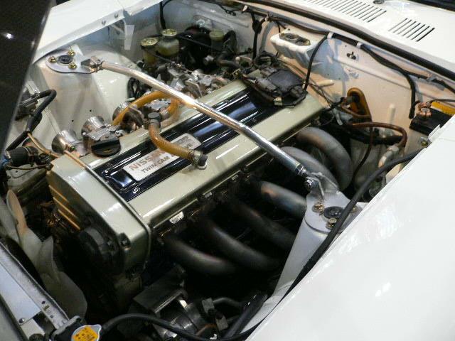

Posted 22 April 2010 - 12:19 AM

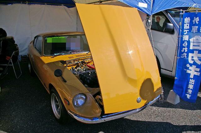

To answer my own question yes it can be done. The Carbs are hiding over the side of the motor.
Found this on Rocky Auto.
http://www.rockyauto...ail.php?id=1641
Maybe I could buy parts off them to get it done.
#17 zzzzed
zzzzed
  • 2,691 posts
  • Location:south australia
Posted 22 April 2010 - 03:37 AM
i could be wrong but that looks like ITB injection
#18 Hunter
Hunter
  • 723 posts
Posted 22 April 2010 - 04:50 AM
it did have solex written in the description, bit hard with google translate.
but if you look carefully it looks like the top of carbs on the intake

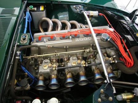

Posted 22 April 2010 - 07:36 AM
If they are carbs on that RB engine above, they look as if they would have to be mounted fairly closely to the head like the picture below of an S20 engine.
Also that exhaust manifold looks dangerously close to the battery, but could be the veiwing angle.

I checked my PC but I don't have any pics of when I had the engine in and I was test fitting the intake/exhausts up. But if you check my website there is a pic in the galleries section showing you the length of the RB26 intake manifold with the TB's installed and the trumpets.
Now I can tell you that stock clutch MC would not work with these trumpets where my engine sits but I replaced the MC with a Titlon 75 Series unit of the same bore as standard. These 75 series are nice and short in the body and bolts right on to the zed mounts with no mods :) so that has to be good right? But to give you the idea the bell/widest part of the trumpet was close to the clutch MC.
Having said that when I did all this test fitting the car was still on the rotisserie (well lowered the body over the engine and then removed and place on axles standard) and I only installed the cross member with the engine/gbox so no suspension and stuff so things might still move a bit more when I install in the hole later.
