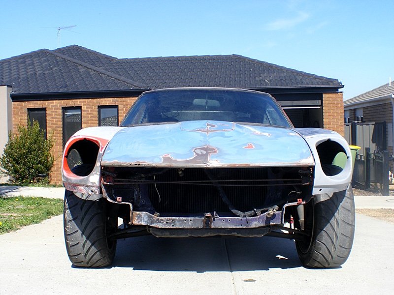

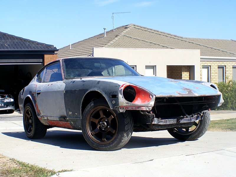

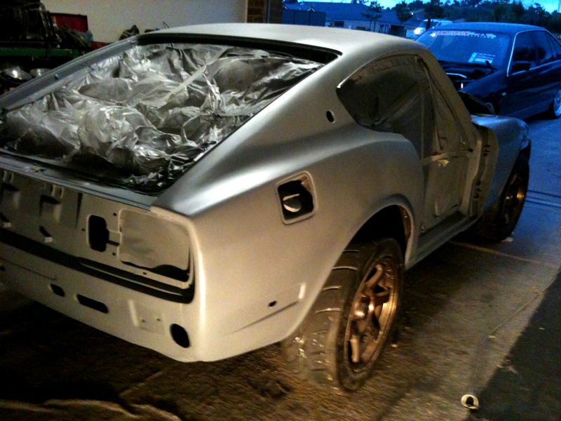

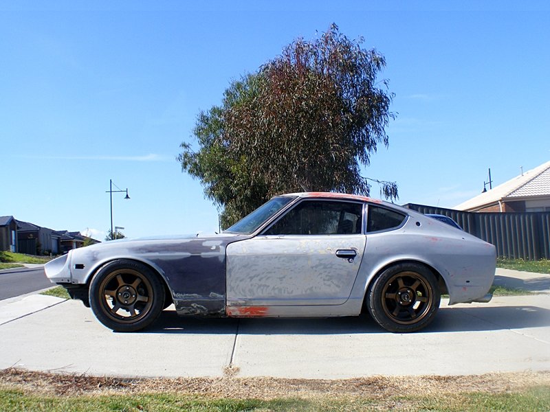

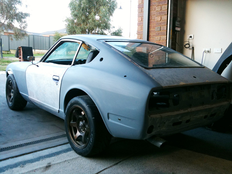

I bought this a little while ago from a member on the forum.
It had a hit in the front passenger side and the chassis was twisted slightly.
I stripped it down, tar deadened the floor, dynamatted the interior straightened out the body a little and sent it in to the body shop to have the car straightened out and the panels gapped.
The plan is to make the car like a new car. I have coated the underside of the panels with body deadener, am fitting new rubbers, updating the paint. I have chosen an orange in 2pac thats similar to the original orange but a metallic.
I am going with a black interior but with a tan colour to offset it.
I have a few photos so far.
