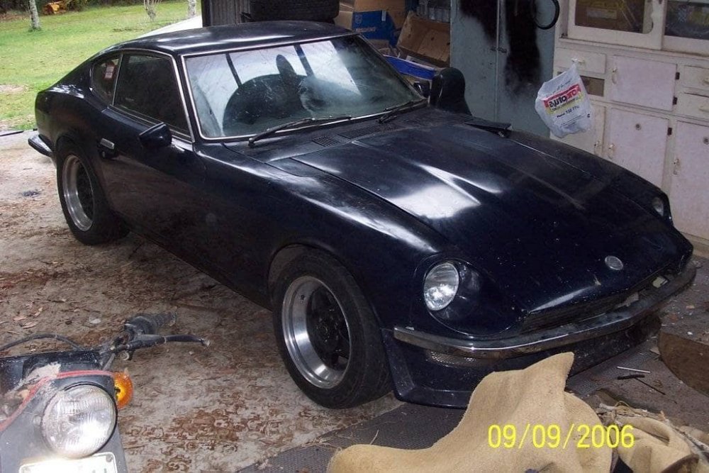

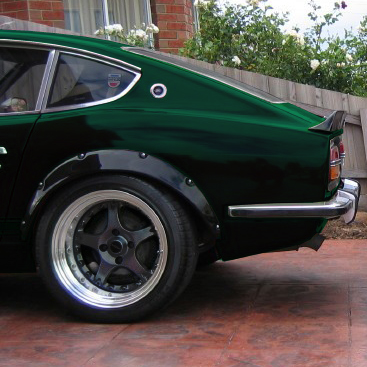

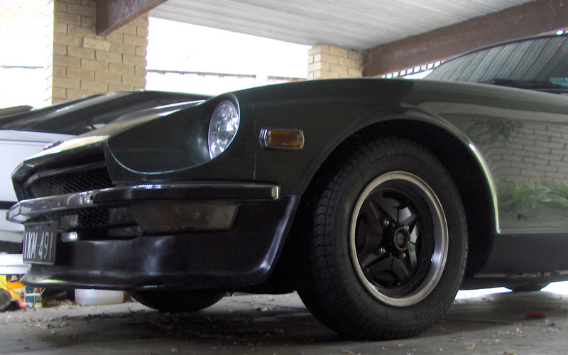

Sulio
Not a big fan of the blue below but just FYI the wheels are 16x7 with 225x16x50.
Posted Image
...and the 15x7's
Posted Image

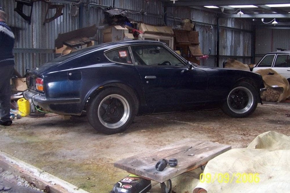

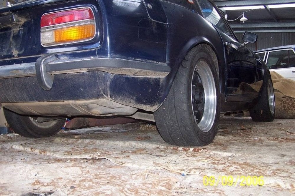

I have B45 16" simmons x8 on the back wearing 225 Kumho semi's. +16 offset I believe. They did scrub with the car fully laden with crap to take to the track, but were fine when racing. I have since lipped the rear guards just in case.
I have also put the 8s on the front (as in the following pics) where they clear the lower spring perch by a bees dick. Don't know how they would go with front guard clearance. Will depend a large part on whether you have increased front negative camber. I had to flare the guards about an inch as well as lip them with ~-3.5 camber.
Here are some pics:
Posted Image
Posted Image
Posted Image
Hope that helps,

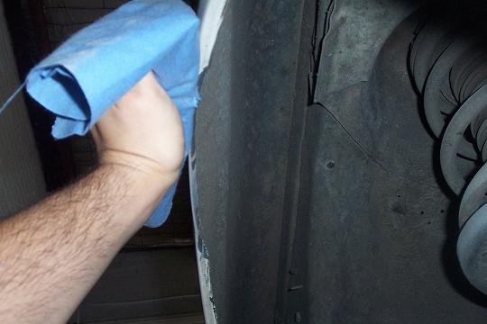

how did you lip/flare the guards? does it destroy the paint where you do it? or by lipping it do u mean you bend up the ridge around the inside of the fender?
Posted Image
just found that thanks to google, along with a how to, and thats what i'm trying to say, and i'm guessing its what you were talking about, just i didn't know the name of it! out of curiosity how did you flare the front fenders?
