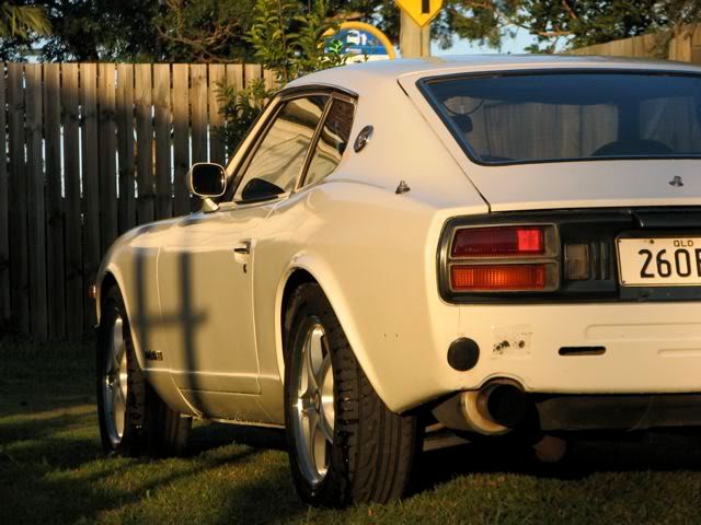

Posted 29 March 2010 - 08:20 PM
This is a 235 tire on a 7" rim (yes I know everyone will tell you that is too small a rim for 235s but the way the tire fits on the rim is actually quite good, these rims might be a bit forgiving though) with standard guards and not rolling. I have about 10mm to stock springs.

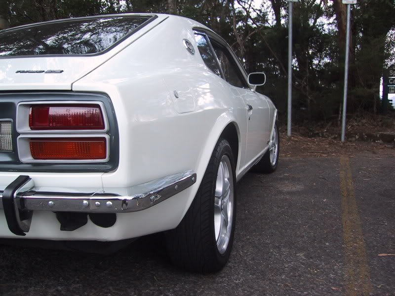

Posted 29 March 2010 - 08:49 PM
I'm running Panasport 16 x 7 with 225 x 50 RE55's with coil overs though, no problem, untouched guards.

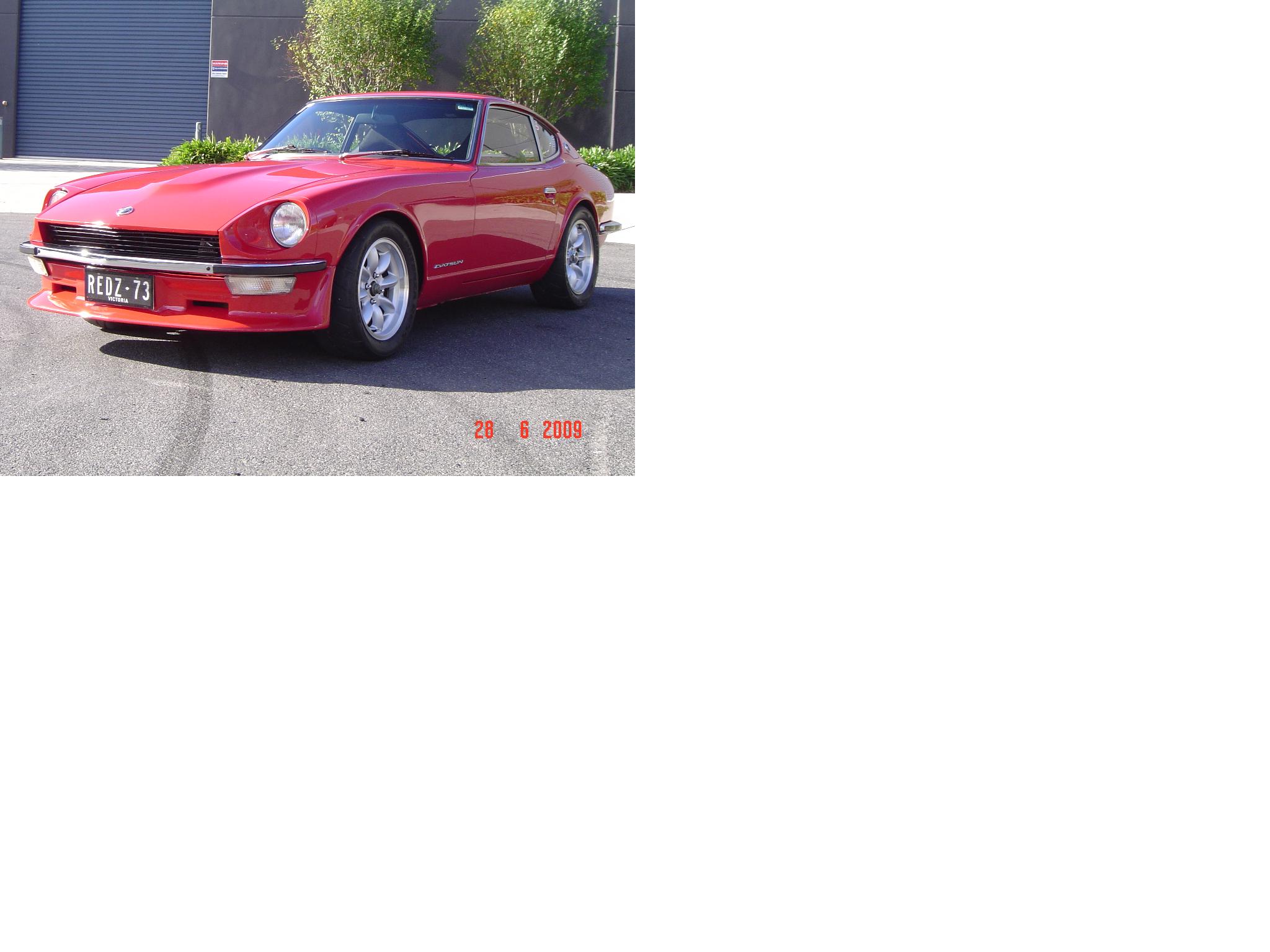

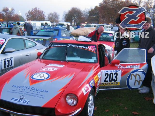

When I imported the Rota RB-R I also got some Rota RB in 15x8 +12 and here is a pic of them on a 240z with a 225/50/15 with stock spring purches, toy 4x4 calipers. The +4 would give more spring clearance but would move the setup closer to the outside lip.
I think I have some pics of these RB 15x8 +12 on the front of my old 240z without tyres and you can see how they work.....will post those up as attachments when I find them
Pics as follows.
1. My old 240z with the 16x9 on all 4 corners with 225/45/16
http://zclub.org.nz/....php?pic_id=827
2. The Rota RB 15x8 +12 with 225/50/15 on Andy targa 240z (guy I sold the 15x8 too)
http://zclub.org.nz/...php?pic_id=1562

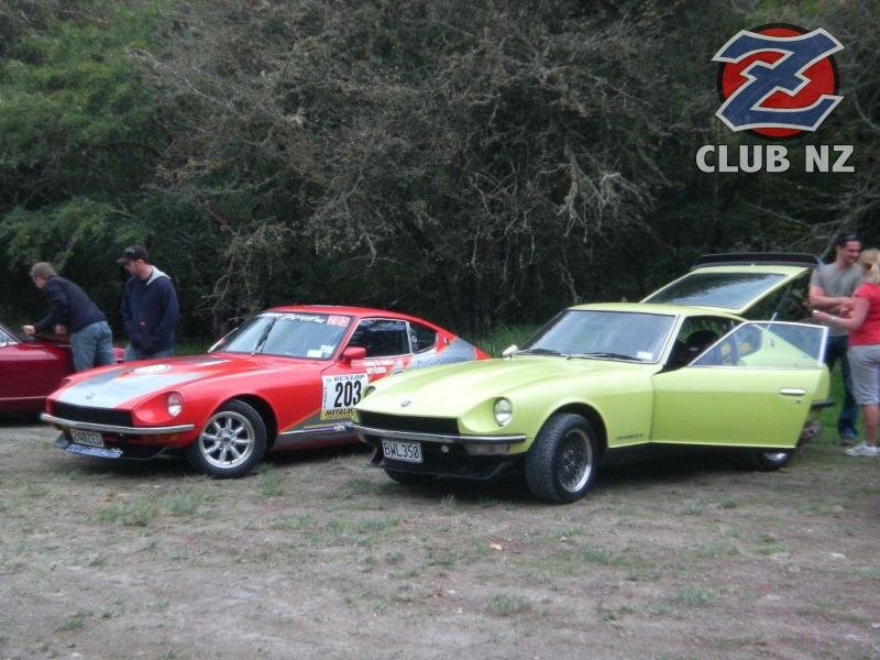

3. My old 240z with the 16x8 Rota RB-R +10 with the 225/45/16
http://zclub.org.nz/....php?pic_id=969

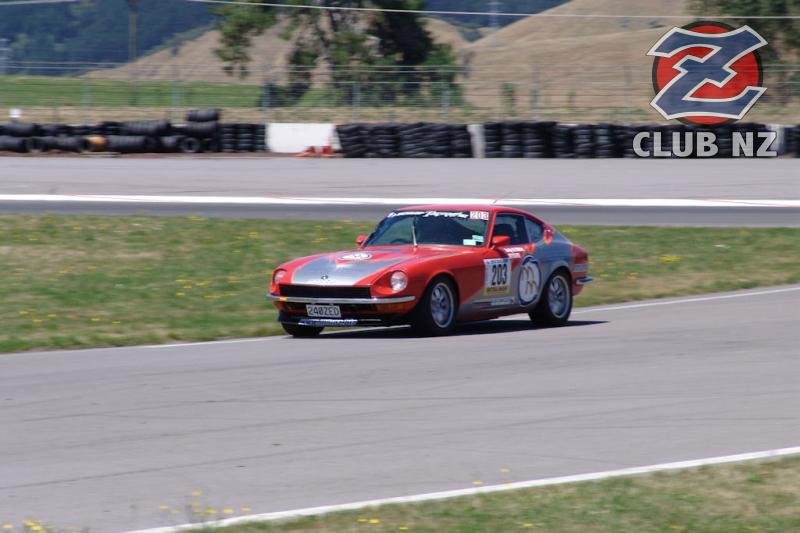

4. Andy's 240z again with the 15x8
http://zclub.org.nz/...php?pic_id=1329
http://zclub.org.nz/...php?pic_id=1369
