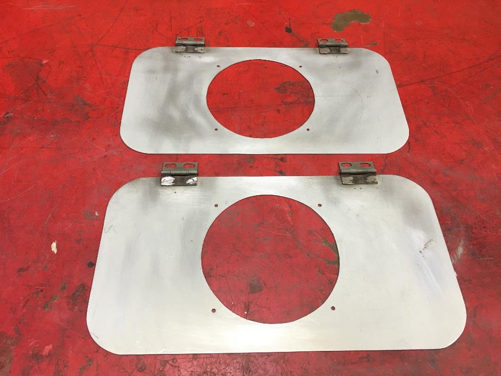

KatoKid Posted August 26, 2017 Author Share Posted August 26, 2017 Guess what? Quote Link to comment Share on other sites More sharing options...

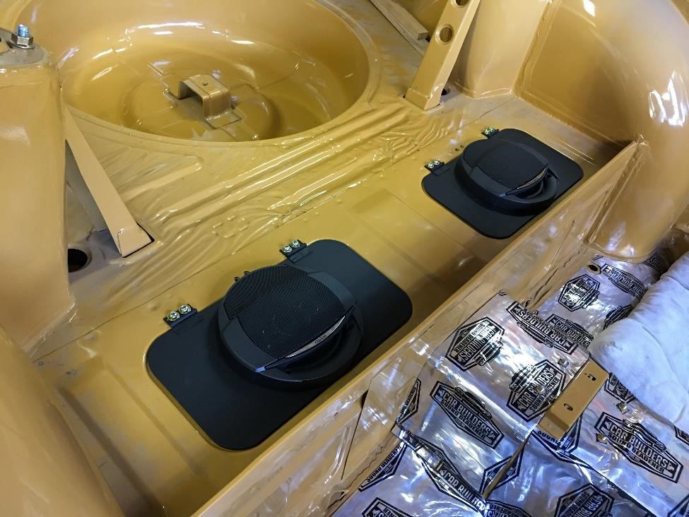

Enzo Posted August 26, 2017 Share Posted August 26, 2017 Toolbox covers and setup for speakers behind the seats? Quote Link to comment Share on other sites More sharing options...

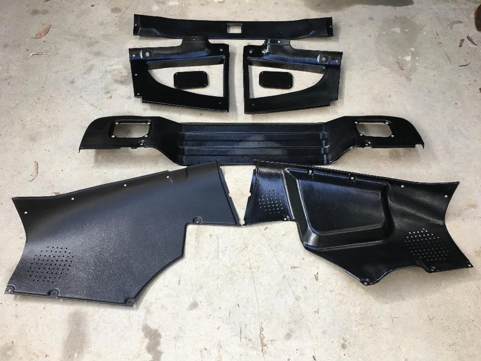

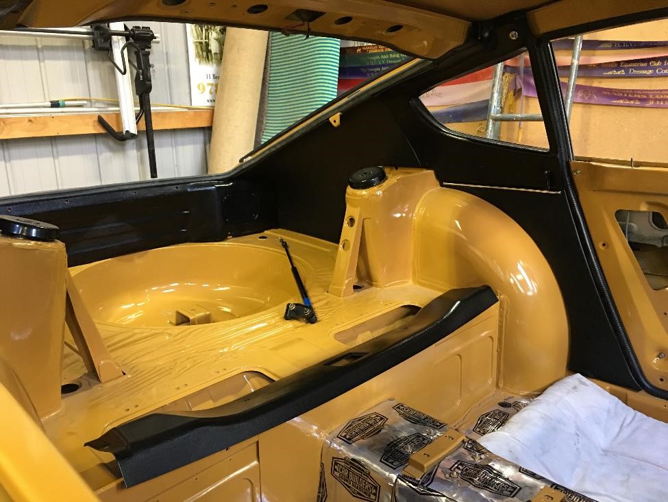

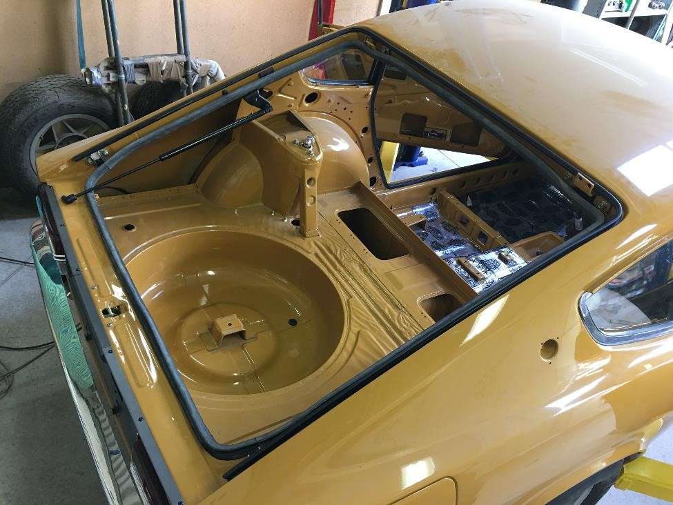

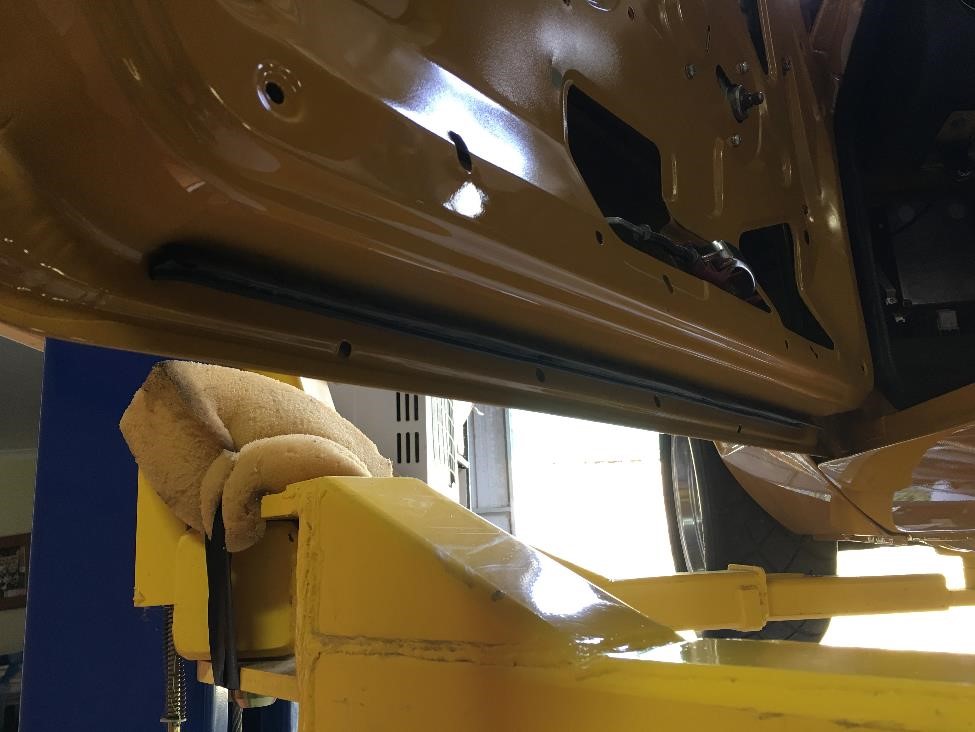

KatoKid Posted August 27, 2017 Author Share Posted August 27, 2017 (edited) Spot on David! For various reasons this is my preferred location and I didn't want to chop up my pristine original lids so a couple of hours got these made. 35mm hinges from Bunnings were spot on, just had to elongate the holes a fraction. Got the lower door seals and the outer hatch seal fitted. Decided that removing the hatch was the right choice for this, you could do it with the hatch in place but would make it way harder than necessary. Spent a few hours cleaning up my rear interior plastics and they came up pretty well. They were in good condition except the LH rear side which I had to buy from MSA. They haven't replicated the finish very well so it does stand out but once in the car you don't really notice. Edited August 27, 2017 by KatoKid gav240z, Ponyo240z, nizm0zed and 1 other 4 Quote Link to comment Share on other sites More sharing options...

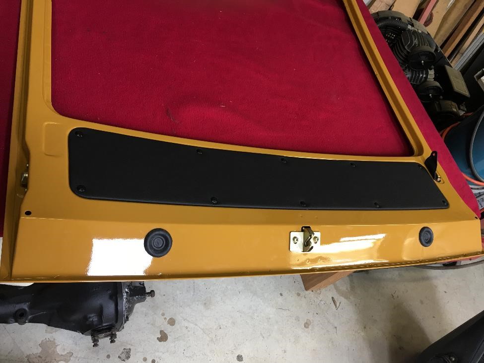

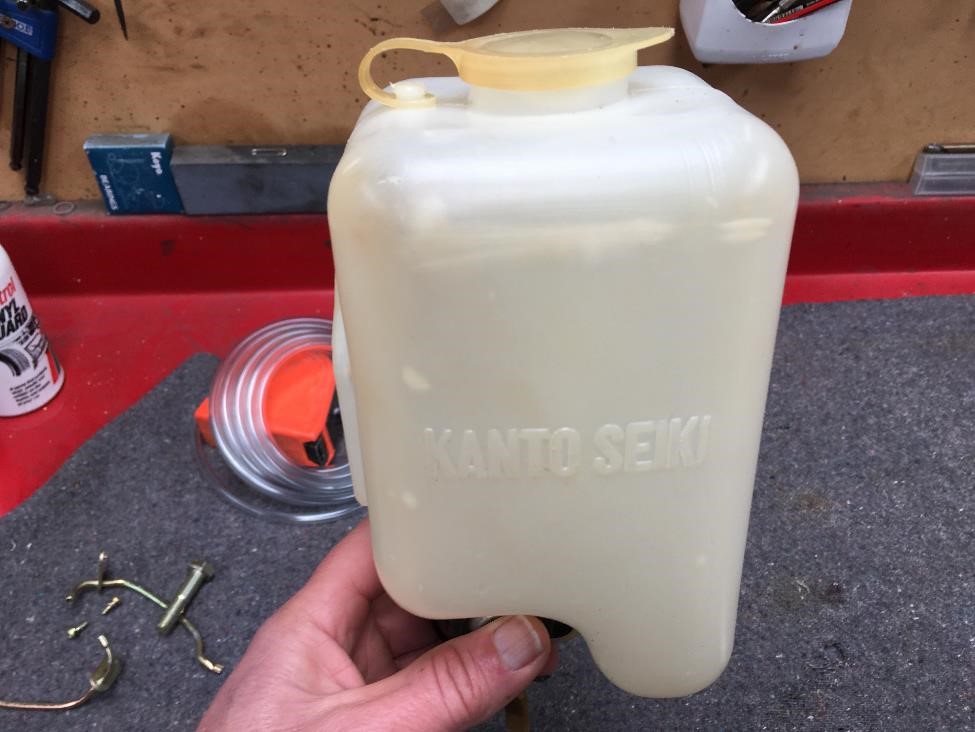

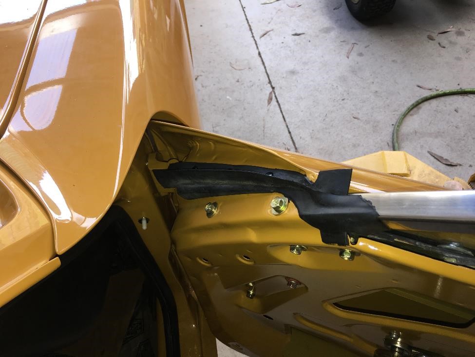

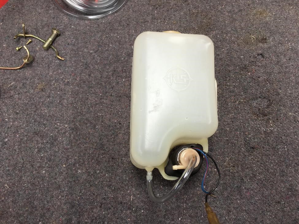

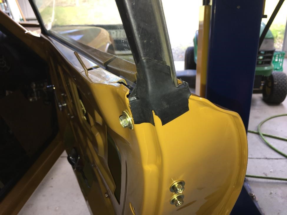

KatoKid Posted September 1, 2017 Author Share Posted September 1, 2017 (edited) Got a bit done the last few nights.... Refitted the drivers side door glass after having the scratches polished out http://www.viczcar.com/forum/topic/16465-all-glass-polishing-melbourne/?do=findComment&comment=195629 highly recommend his work and much cheaper than new repro glass. Once the glass and frame was back on I could fit the two remaining door seals, fiddly little buggers and patience pays off. Fitted the new hatch interior trim panel and grommets while the hatch was off. Fortunately my washer bottle was in pretty good nick, just the lid was a bit yellowed. Gave it a good clean. Checked the motor still works and installed with new tubing and T piece. Tick another thing off. I've been extremely fortunate that when the previous owner stripped the car he bagged and tagged everything and most things have been there but one thing that was missing was the spare wheel retainer. After hunting around http://www.viczcar.com/forum/topic/16460-wanted-240260z-spare-wheel-retaining-bolt/#entry195781 I ended up making one using some M10 all thread which cost $7.00. The all thread passes through the original bracket (without drilling) and has a lock nut underneath and then I have a nut with a large washer underneath the Masonite cover that I made and a fabricated wing nut on top so I can tighten it down without the Masonite bowing. Too easy! I had to buy some suitable tyres to put on Gordo's borrowed rims for the engineering inspection. Gordo's race tyres were BIG 225/60 x 15 for the 7 inch rims and really filled out the guards both in width and diameter. I need something that was a bit smaller so ended up with 205/60's which were satisfactory for the purpose. Don't worry Gordo, I've got your original tyres and will have then refitted before returning the rims!!! Seatsafe seat-belts have arrived but cant fit them until the interior is done. I'm away for work a bit in September so I've booked in to have the VASS inspection done on October 2nd.....I've got a deadline to work to now...but not much more to do ......scary! Edited September 1, 2017 by KatoKid ScottyD, GongZ, potter260 and 2 others 5 Quote Link to comment Share on other sites More sharing options...

nizm0zed Posted September 3, 2017 Share Posted September 3, 2017 this is really coming together now!Those speaker panels are cool, makue sure you put some insulating foam around thier underside where they rest against the body, otherwise they'll rattle and make the speakers sound horrible. Quote Link to comment Share on other sites More sharing options...
KatoKid Posted September 3, 2017 Author Share Posted September 3, 2017 Thanks gents. Yes Jeff, just pull the bike apart....not a fan of racks for carbon bikes. I've got Thule 594 which hooks over the front wheel which works well for MTB and roadie and no risk of damage. Yep, already did the foam things, 4.5mm neoprene foam from Clark Rubber. Getting closer. Quote Link to comment Share on other sites More sharing options...

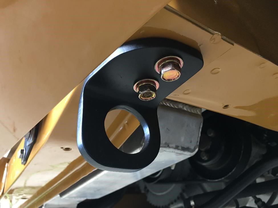

KatoKid Posted September 3, 2017 Author Share Posted September 3, 2017 Some people have asked about the quality of the glass polishing I had done on my drivers door glass. I hadn't really looked at it critically but gave it a good clean and have to say its pretty damn good. I cant see any waviness or other defects. There was one scratch on the inside that was pretty deep that he didn't want to take out as that would make it wavy but the mass of lighter scratches on the outside was no issue. Cleaned up and pained my tow hook. I was going to leave it off but decided that you never know when you may need it! Better safe than sorry. I picked up some recovered and refurbished seats from Mossy a few years ago, pulled these out and gave them a dust off. They were a lot firmer than my old original seats so I will need to take the seat height spacers out for more headroom but otherwise they look grouse. Away for work this coming week so no more progress. mossy, gav240z, potter260 and 1 other 4 Quote Link to comment Share on other sites More sharing options...

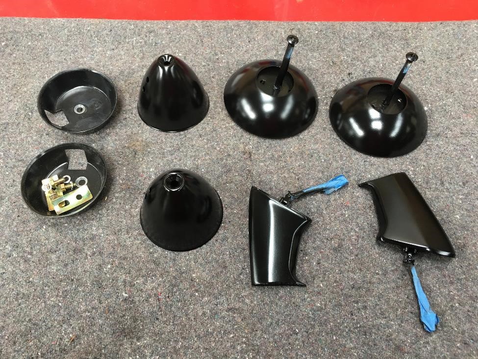

KatoKid Posted September 11, 2017 Author Share Posted September 11, 2017 Picked up my fender mirrors after having them painted, came up very well. gav240z and Ponyo240z 2 Quote Link to comment Share on other sites More sharing options...
