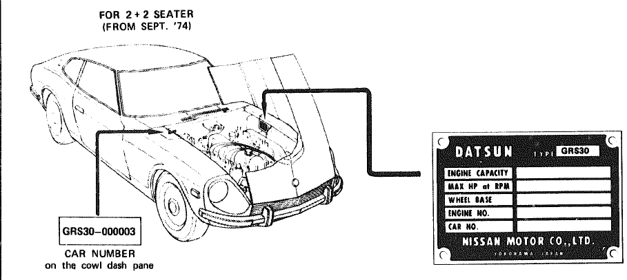

- Where do I find the chassis number on the 260z 2+2

- Is the body of a 1/76 260z 2+2 the same as a 2/77 260z 2+2 - Yes.
- Will all of my parts fit the earlier model shell. - What model shell are you referring to?
- Where do I find the chassis number on the 260z 2+2 - On the firewall above the brake booster.

Here is a pic of where the ID info should be (already stated by Lurch but thought a pic might help ;))
