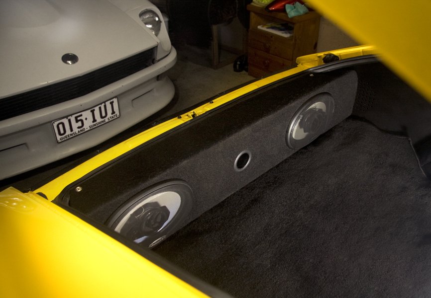

When available, could you throw a pic up of one installed or sitting in place?
What is the hole in the middle for?

I'll take a pic of the on I've got in the car already. It should turn out exactly the same.
You can be first on the list and it doesn't have to be a commitment to buy, you should see the final product/cost first. I'lll just send you a msg first when I get them finished (hopefully around mid Jan when all of the shops have opened up again)
The hole is a tuning port (it will have a nice plastic insert there when complete).
There are generally 3 types of boxes, sealed, ported and a passive reflex system.
Basically a ported system will allow the speaker to move further out (ie go louder) with less force. The port is also 'tuned' to complement the roll off or natural bass limit of the speaker. This is why most people go for this option.
I usually build sealed speakers (ie the box is airtight). These require the speaker to use more power to fully extend, but the pressure in the box will suck the speaker back into place quicker making for a nice crisp sound.
The 3rd option, passive reflex, usually has a sealed port that can flex (like a speaker sitting in the box but not connected). This is a bit of a trade off to get the best of both worlds and this is how I built my home theatre speakers.

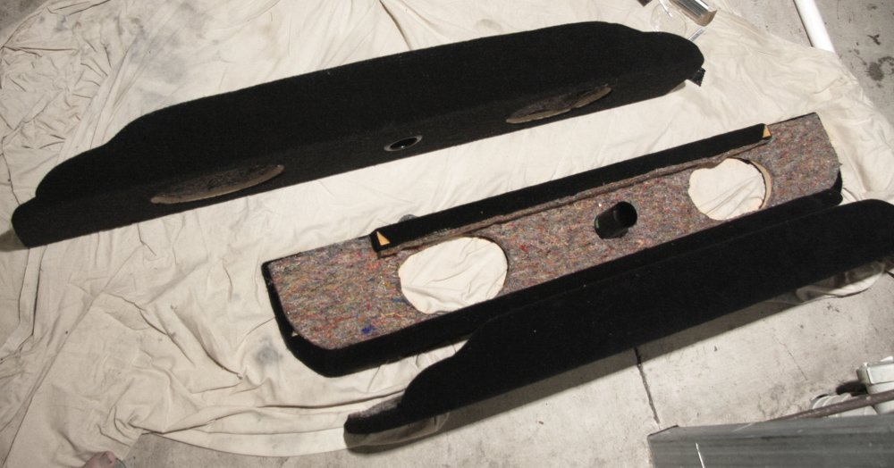

OK so I have the speaker boxes and they are looking pretty good. Just need to get some insulation for the inside of them and then wait for the invoice from the upholsterer to get the final price for the boxes.
Here's a sneak peak, not very clear but I'll get some better photos in the car, out in the sun, once they are done.
Posted Image
Turns out they also fit the 2+2's but remember they will fire straight into the back seat.

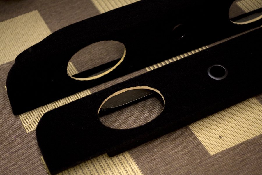

OK final price $125 for a finished box. That is carpeted, insulated back and with tuning port and mounting hardware.
You will need to drill two holes in the box to secure them (I will supply the screws, finishing cups and quick nut tabs for each box) . The reason I didn't pre drill them is so you can line it up directly with the mounting points on your car. More on this later.
If I end up buying the speakers for everyone I will pre-drill the 4 screw holes per speaker to mount them. If you use your own you will just have to drill them yourself (not too hard even Steve could do it ;) ).
