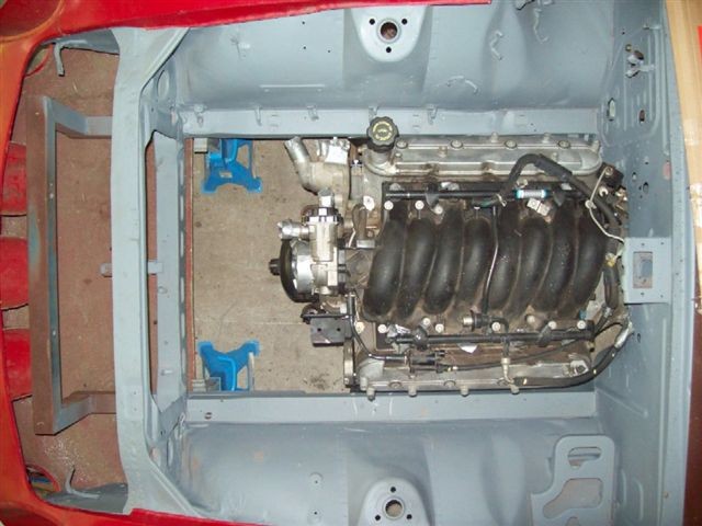

LS1 and t56 adds only 15 kg to a standard 240Z. It's an all alloy block and when set back in the engine bay the extra weight is all over the rear wheels.
Gavin made an important point I missed. With an LS1 you will need big brakes to pass engineering.
