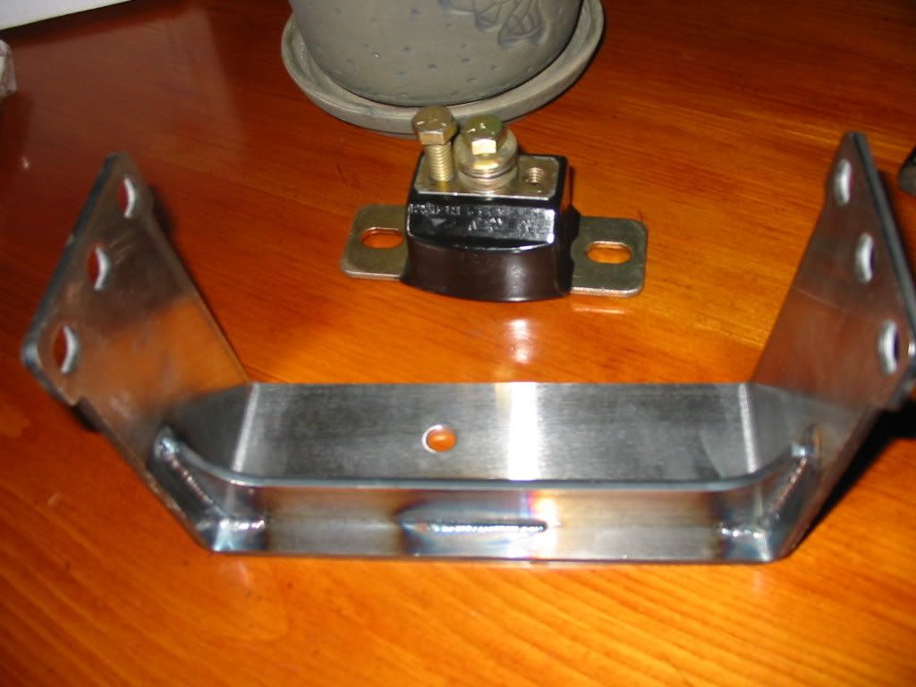

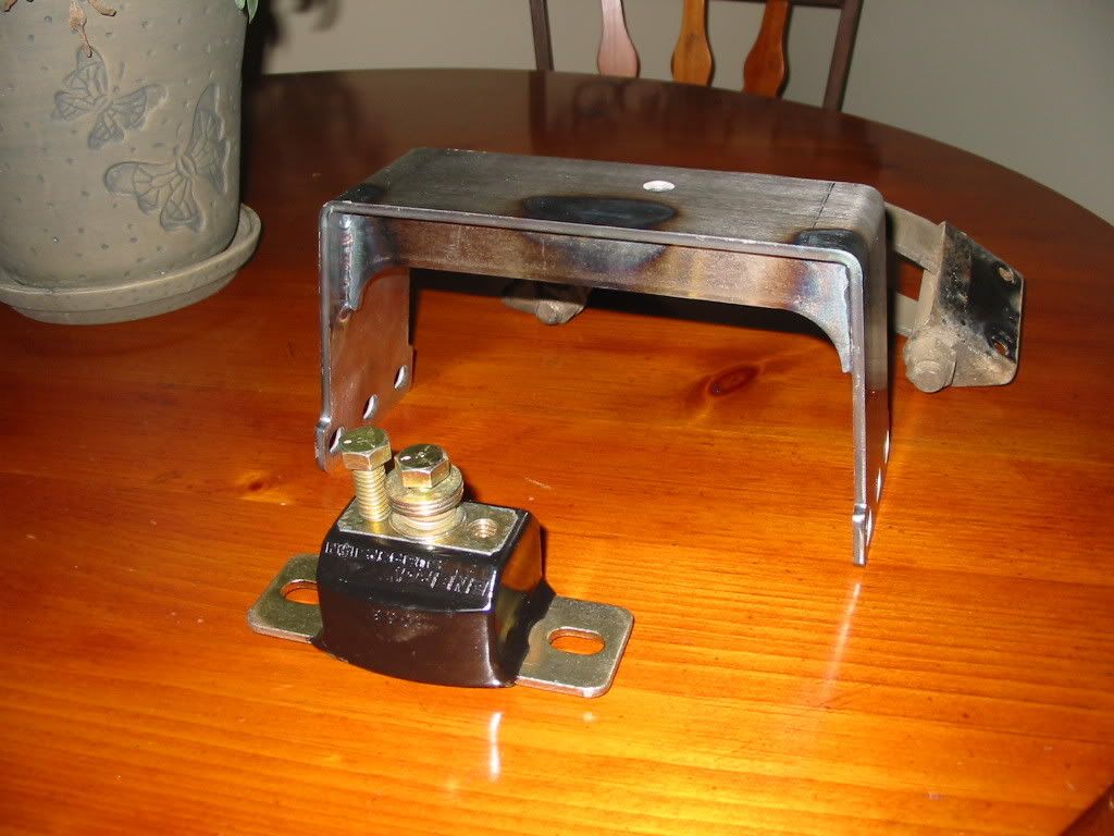

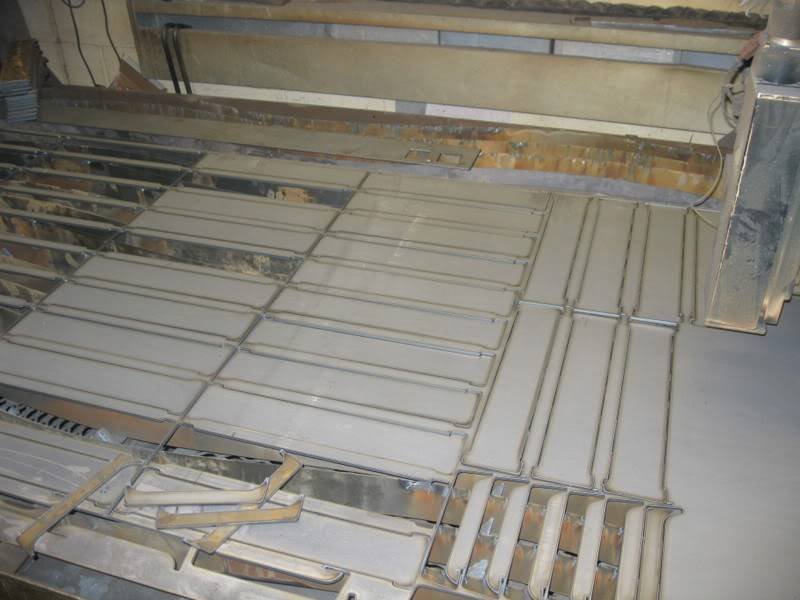

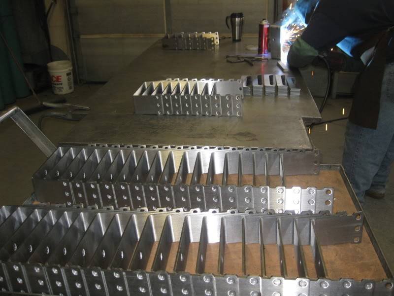

Here is some pictures from the third thread
Posted Image
Posted Image
Posted Image
Posted Image

the largest difference is these ones from the US are Stainless Steel instead of Mild so would never rust. I could be interested depending on the price, as the smaller changes make for a nicer part also (main shape is bent instead of 3 pieces welded together, rounds on welded in brace to minimise stress concentration onto side faces, and an extra hole for screwing into the car body)
one thing i don't understand about the brackets (the one i have from Chris also) in general is y they are only using one bolt at the top, instead of 2 or 3?
