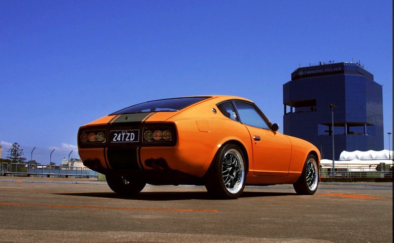

I was thinking about this as well. I Photoshopped this pic to have dual exhausts
Posted Image
But i think in reality it's just gonna be another project that delays the progress on my car even more.
There are a couple of guys on hybrid with true dual exhausts. Have a look at their setups.
