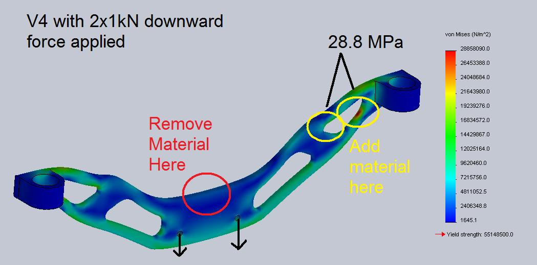

Posted 04 November 2009 - 10:11 PM
Ahh I see, so the rear of the diff is being pushed downwards like I initially modelled!
In that case, now that we have strengthened its resistance to torsion can I suggest you make a couple small changes to the model to increase its strength against transverse loads like the one in the picture I've attached.
I would suggest decreasing the size of the cutout near the yellow circles, and removing 'lazy material' where I've put the circle in red. This will allow you to add material to other areas without increasing the weight.
I think that since the stress is still concentrated in one location its worth editing the model a little bit more to improve its performance against this downwards loading

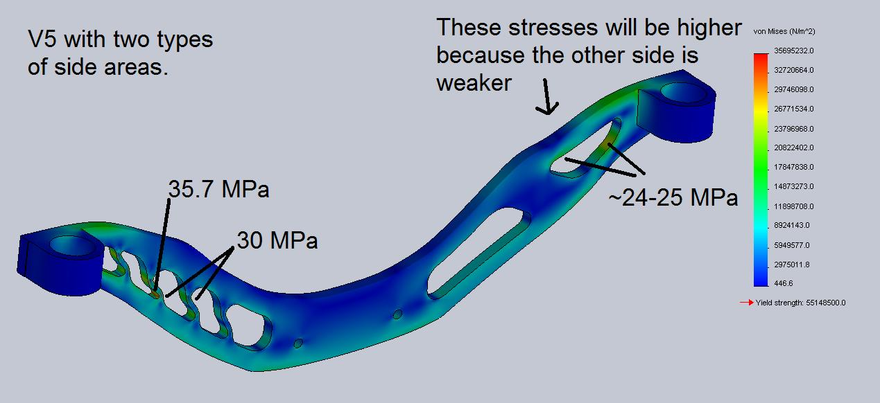

Posted 04 November 2009 - 10:46 PM
Ok, in this example each side has two different types of holes. This means that neither side's results are accurate because the stronger side will be displaying higher stresses than it would normally get, and the weaker side will be showing lower stresses than it would normally get.
However it IS possible to see the high stress concentrations in the side with many holes.

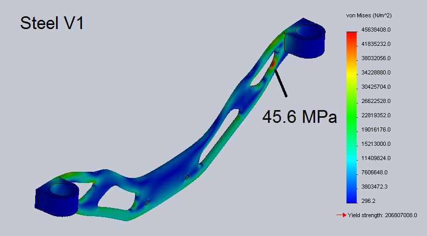

Posted 05 November 2009 - 09:29 AM
Mass of Steel bar: 6.25 kg  about 3 times the mass.

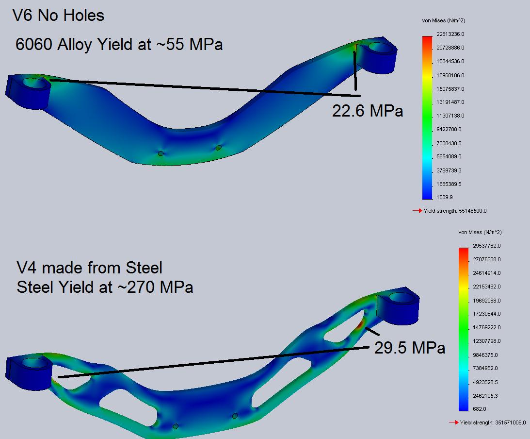

#60 stevo_gj
stevo_gj
  • 1,561 posts
  • Location:Brisbane
  • Tagline:Steve
Posted 05 November 2009 - 02:26 PM
Use the FEA above where there are no holes in the design as a guide. The best places to put holes are where the local stresses are low, which are the blue areas.
