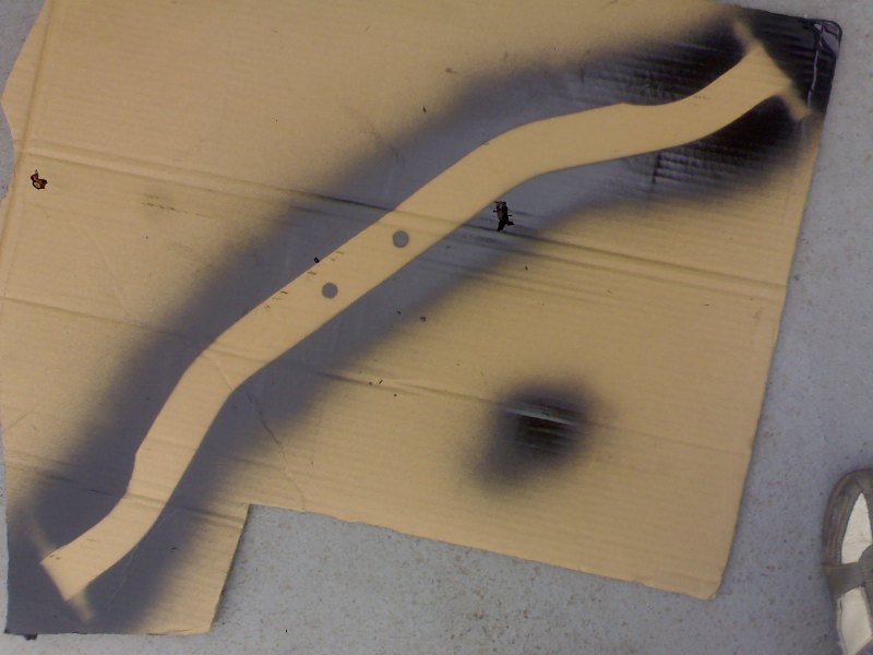

Posted 04 November 2009 - 03:47 PM
This is the template so i'll cut it out and send it up Tomorrow.

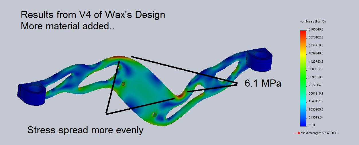

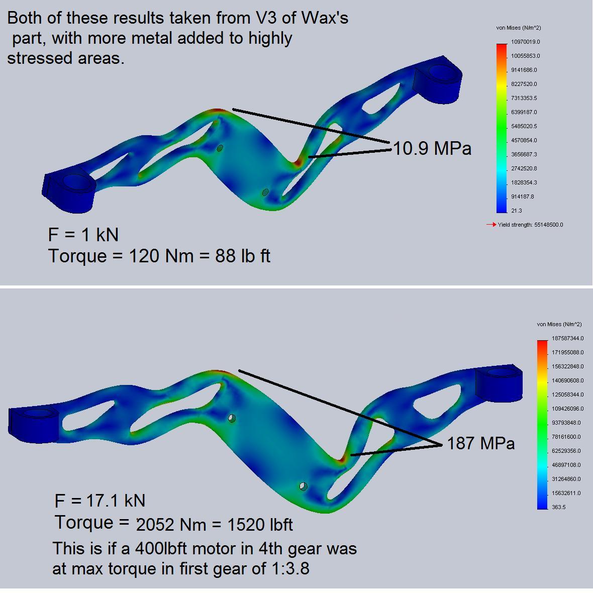

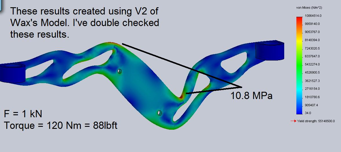

I think there is potential for this design to perform well. The way I see it, the holes are removing 'lazy material' in the design, which is material that does not have much stress acting on it during a stress cycle.
You are right that a design with holes may have higher stresses than a design without, but what if the material removed from the holes was added to areas where the stress concentrations are high?

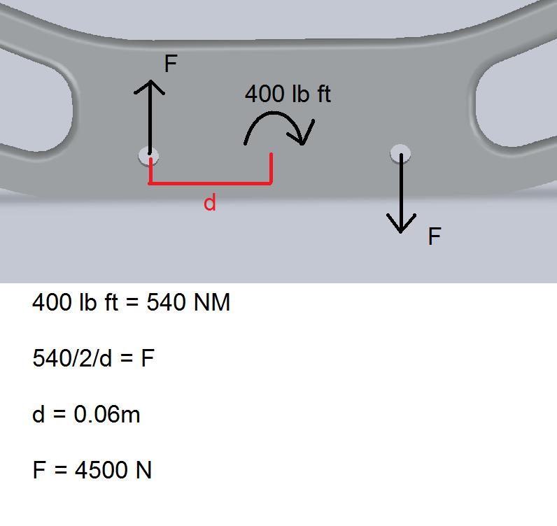

I'm just working on the latest stress analysis using Straus7 atm will post results soon. I'm going to use some of the torque figures that were supplied as estimates and see what stresses you get if the front diff mount goes and the entirety of the torque is transmitted through the mustache bar when you drop the clutch. In other words I'm going to apply the entire torque of the motor through the two bolt holes.

There is one thing you may be overlooking here.  Most torque figures picked off a dyno are done in 3rd or 4th gear.  If you use 1st gear, surely the amount of torque produced is far greater, due to the gearing change?  Likewise the diff ratio would probably have a similar effect?
