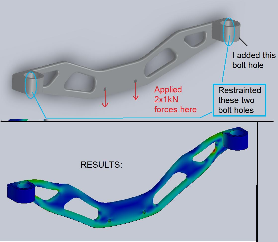

Hey guys, I'm gonna post here what I emailed Wax:
"Hey mate,
My professional FEA software (Strand7) is on the fritz on my PC, so I've used Simulxpress which is a small FEA package within solidworks. I've applied 1kN on each of the bolt holes for the diff, which is an overestimate of forces involved, and then restrained the two large bolt holes on either end.
Since I do not know the size of the forces involved I am not able to give you accurate figures for the stress, but I will be able to use the ‘guessed load’ to qualitatively show you the highest stress areas. This will allow you to compare one design to another by applying the same load and see which has the highest stresses.
In other words, the stress analysis is only useful if you have more than one model for me to test. Knock up another design when you get a chance and I'll apply the same loads and see how it compares.
Cheers,
Steve"
I've attached the results of the FEA.

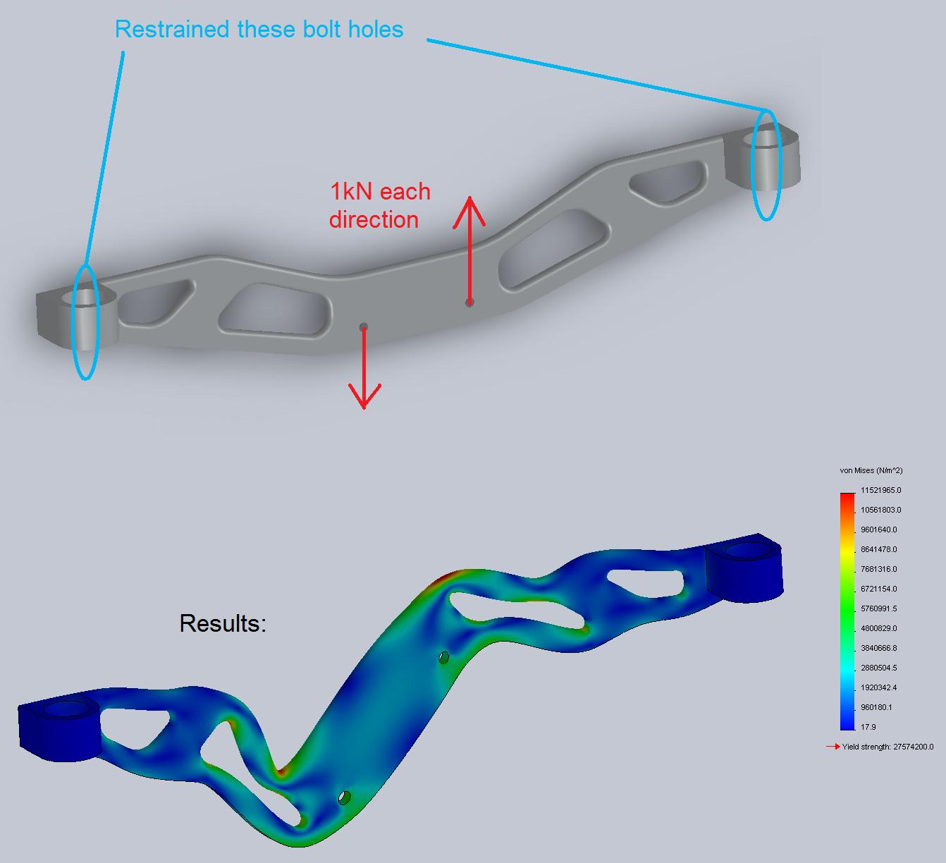

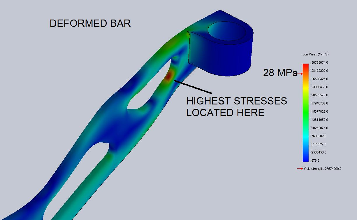

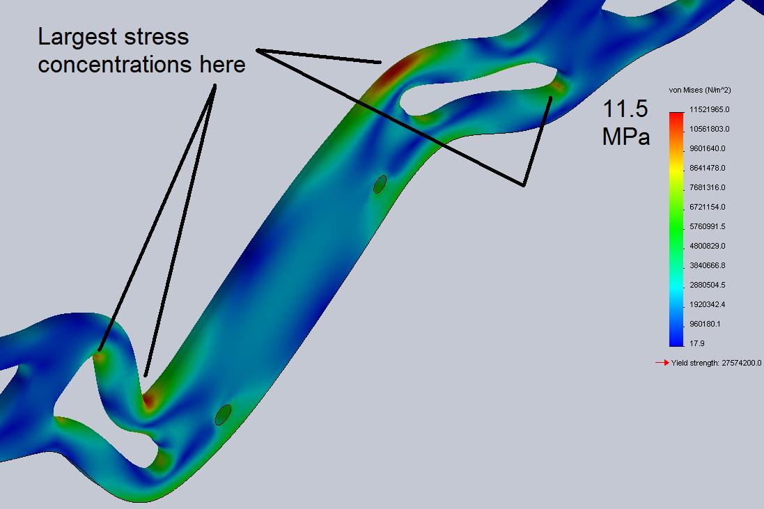

#20 stevo_gj
stevo_gj
  • 1,561 posts
  • Location:Brisbane
  • Tagline:Steve
Posted 03 November 2009 - 09:53 AM
Hey guys,
I will change the loading conditions to reflect the torsional force involved. Which alloy were you going to make it out of btw? I need to choose a metal and so far I've just chosen 1060 aluminium alloy.
Eww simulxpress doesn't let you show the stress contours without showing displacement, so I have to show you the deformed model...
