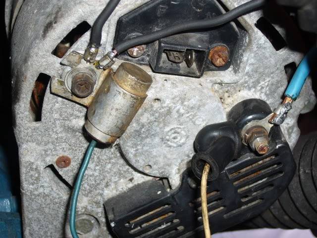

OK, I've spent the day in the shed with litres of sweat dripping off every hour but I kept telling myself, I love Datsuns ;)
I tried Nzeders advice, I hooked up an external voltage reg which came with the 240 but don't know what model it is actually from. Still getting too high voltage to the battery.
Can anyone tell me if this 280zx alt has a built in voltage reg?
Posted Image
And this is the one originally on the 240.
Posted Image

#16 Ben
Ben
  • 313 posts
  • Location:Adelaide
Posted 30 December 2009 - 09:15 PM
REgarding high voltage at high rpm's - get an under-drive pulley
Regarding the images above - yes it looks like an internally regulated alt. to me.
Note regarding the (rather good) tutorial above - the ADM 260Z doesn't have the seatbelt interlock system mentioned, so that isn't a variable in the upgrade process.
Long story short; - S to battery, L to lamp (ideally with diode, but a decent lamp will do the same job) insulated post to battery via fusible link. IGN is black with white stripe, and it should all fall together.
Any excess wires in the old external reg harness can just be left unplugged.
