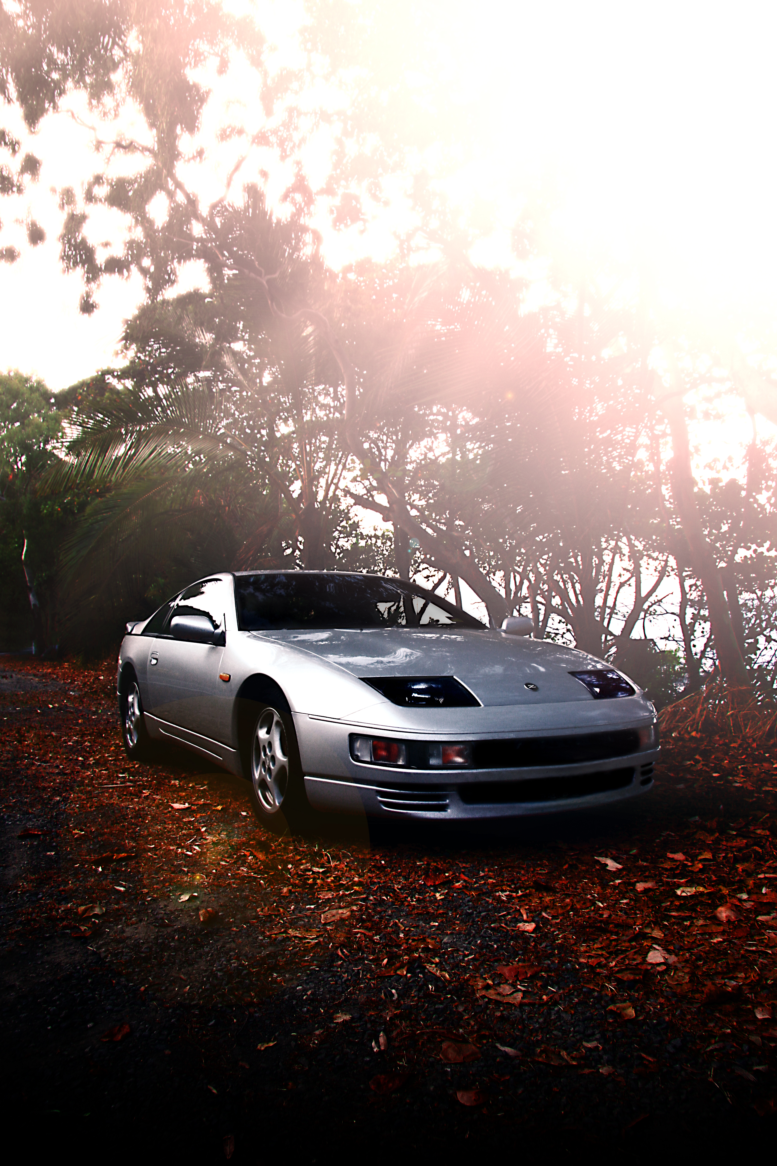

My parents own a NA z32.
In my experience, I would say they are a very comfortable and fun car to own. Solid gearbox and very solid handling. If you can get a reliable one, you'll be laughing. If you get one with a few issues, you'll be selling body parts to pay for it ;)
The aircon on my parents car went and they had to pull the whole engine to work on it. Most parts are pretty expensive too. Their airflow meter was playing up. I think it was $800 for a new one or $400 for a reconditioned one. They ended up buying a "new" one for about $600 I think but it turns out it was a reconditioned one that broke only a week or two later.
I would say go for a NA as opposed to the twin turbo (less to break/replace and less stress on the engine over the last 20 years, also they are cheaper to buy). Also the "bogans" that would be more likely to flog the car would usually go for the twin turbo versions but that's just a very big generalisation. And try to find one without the t-tops, just looks better IMHO.
I suppose the upshot is that they are so cheap now that the money you save on buying it can go towards maintaining it.
Parents car (+photoshop)
