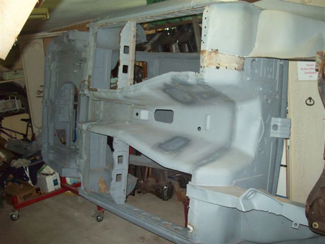

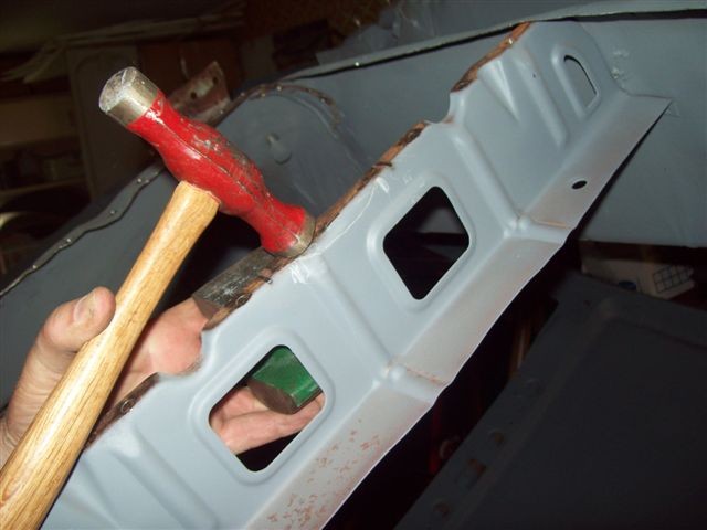

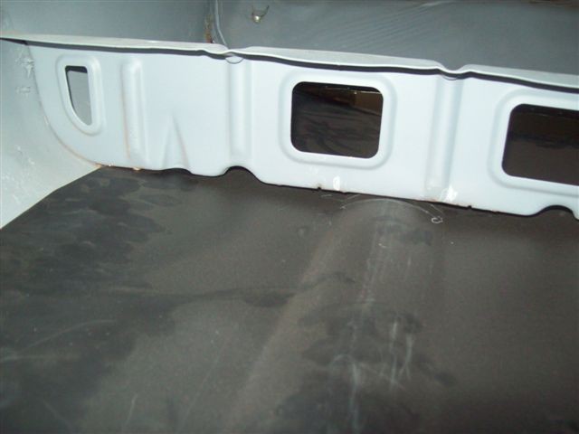

Posted 15 December 2009 - 07:03 PM
hi all i have my pc back so i have a few photos to show you
getting the zed ready for blasting
1.cut out most of the roof rust ready for the carbon fibre roof
Posted Image
2 new floor panels are installed and welded in
Posted Image
Posted Image
Posted Image
Posted Image
Posted Image
Posted Image

#48 Sirpent
Sirpent
  • 2,294 posts
  • Tagline:John.O.
Posted 15 December 2009 - 07:39 PM
Aj Kurumba Loui !
Cant believe you didnt brace the internals while doing that to keep it all in square considering the hole in the turret, no rails, no pans etc etc etc while hanging on the rotiesse ........
If she's all still square I take my hat off to you !
Can I make a suggestion though, may sound stupid, but maybe hang position and lock the doors in place before you finish the rails off, its amazing how much movement may occur which will cause you grief later, at least that way you can manipulate the shell before its all butted up to make sure the sill and slam pillar gaps are correct.
Sorry to be a pesamist Bro.......
John
#49 FLEXZED
FLEXZED
  • 779 posts
  • Location:sydney
  • Tagline:Loui
Posted 15 December 2009 - 07:50 PM
hey mate
had the shell off the rotissere when i cut out the floor and welded in the panel , did 1 at a time so i didnt affect the flex in the car, i did brace he roof but have taken them out now to install the 120y turret brasces
thanks mate i will be bolting everything back on before i do the rails, then weld in my half cage
scraping of all theunderbody sealer over the next 2 days and then hoping to have it at the blasters by monday with a xmas eve pick (fingers crossed)
Loui

#53 PeterAllen
PeterAllen
  • 1,348 posts
  • Location:Sydney
  • Tagline:Manana!
Posted 15 December 2009 - 09:58 PM
John - divert your eyes.
I am of the opinion that there is very little, if any, structural integrity in the floor pans and roof skin. I spent a few years crash barrier testing vehicles and unibody shells contain an underlying main structure. Basically flat sheet panels are not stress bearing.
The danger lies in either rust or crash damage having weakened the load bearing components and you are correct to advise on extra bracing as a precaution. I was only prepared to do this to mine once it had been seam welded.
Loui - Just check that your seat front mount will match the centre rib that runs the length of the new floor pan. For some reason on my passenger side OEM the rib stopped short of the mount and I had to modify the mount for the new floor.
