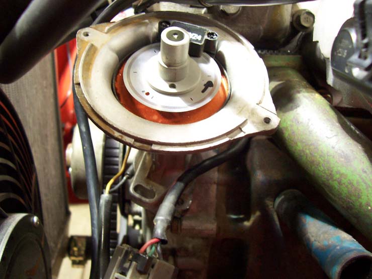

Finally had some success tonight. Got the L24 started! Couldn't run it for too long as the neighbours won't really like the open headers! Had to lock the timing in the ECU to 10' and play with the distributor. Tomorrow I'll play with it some more and take a video of it all. Next thing is to figure out how to set it all up properly; the distributor isn't sitting in the best place.

L28ET distributor works like a charm along with the Wolf ECU so I would recommend anyone going to EFI, to do this conversion too. I think MSD make a system so you can use carbs and get rid of your distributor as well.
