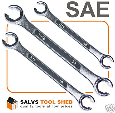

sco_aus Posted July 22, 2009 Share Posted July 22, 2009 I have never even heard of a flare spanner, let alone own one. Whats the difference? Quote Link to comment Share on other sites More sharing options...
Zeddophile Posted July 22, 2009 Share Posted July 22, 2009 I have never even heard of a flare spanner, let alone own one. Whats the difference? They have 5 out of the 6 sides of the nut, so provide a very positive drive, while still being able to go over the brake line. a better way to do it, but requires an assistant. Get a very snug fitting spanner, maake sure its a flare nut spanner. get your assistant to hold the spanner with pressure on it to undo the nut. ideally they need to hold enough pressure to just be at the point of rounding the head. Now, get a pin punch, place it on the head of the nut, and give it a good wack with a hammer. the shock of it will jar the thread loose and the assistant will suddenly go flying as the nut comes loose. remember to warn them that its going to happen, otherwise they may hurt themselves, or your car. This is a great trick, which I have used many times with great success. Actually did it one day for a mate on an auto cooler line (15/16 spanner!). No amount of muscle would shift the damn thing, so got him to put some load on, put the punch in place and gave it a (very small) warmup tap as I was working out where I could swing the hammer back. He just about fell over backwards onto the ground, that tiny little tap it got was enough to crack it! Quote Link to comment Share on other sites More sharing options...
sco_aus Posted July 22, 2009 Share Posted July 22, 2009 Oh so its a pipe spanner? Never heard of them being called flare spanners. Quote Link to comment Share on other sites More sharing options...
Mr240z Posted July 22, 2009 Share Posted July 22, 2009 Oh so its a pipe spanner? Never heard of them being called flare spanners. Quote Link to comment Share on other sites More sharing options...
