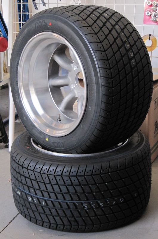

Ok I've decided to go with a fresh set of Watanabes on my 110. If anybody is interested the Rota RBs seen on this thread are for sale:
Two 17x8.5 +4 with 215/45 Bridgestones, about 6mm tread
Two 17x9.5 -19 with 235/45 Bridgestones, about 4mm tread
The wheels are essentially brand new - never driven on.
$1100 for the set.

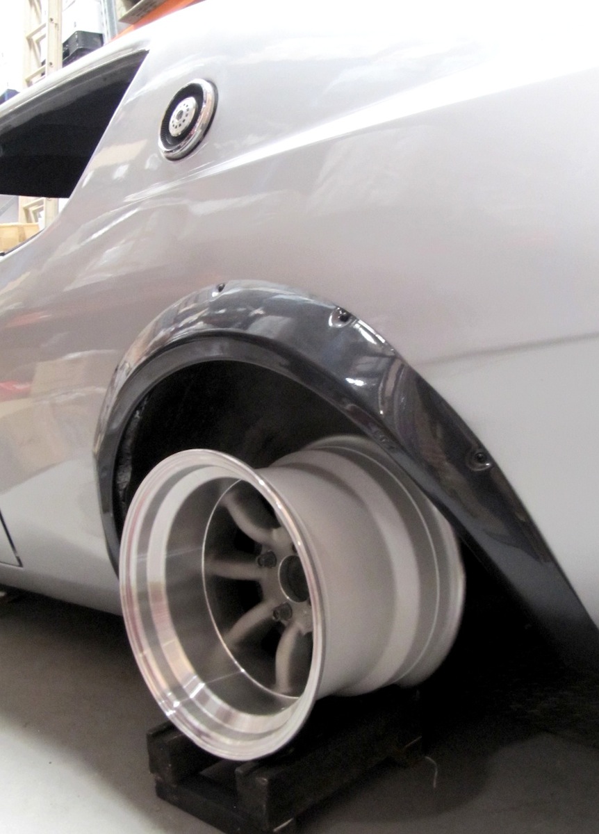

Posted 21 April 2011 - 08:38 AM
think i better ask first.. Is the front off set on these rims ok for a 240z?
Watanabe normally recommend a 16x8.5 -6 for the front with ZG flares, but some people prefer the 16x9 -13, which effectively sits the outer edge of the wheel 12mm further out.
I think you could safely fit the 17x8.5 +4 Rotas with a 20mm spacer, as this still puts the outside edge 2mm further in than a pair of 16x9 -13s.
I will include a pair of 20mm spacers if anyone wants to do this.

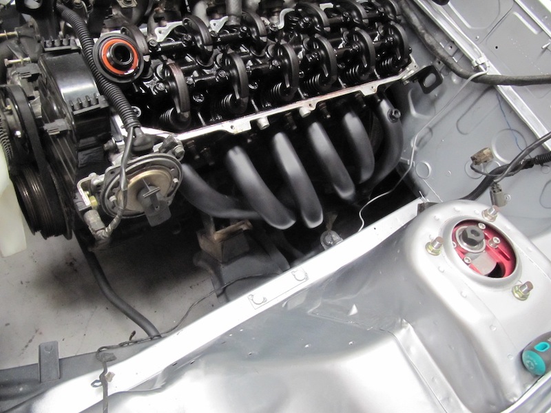

Posted 27 May 2011 - 01:12 PM
Ok back to the car. Some good progress now, I have got the RB30E engine and gearbox sitting in the car, pretty much a perfect fit. Only needs plates welded onto the original mounts for the engine, not sure about the gearbox mount yet. 240K tailshaft will be fine without mods. Gearlever also in the right place.

Posted 20 June 2011 - 11:50 AM
The engine is now sitting in place properly. With a bit of mild violence I got the R31 mounts to fit in the 240K crossmember.
Also picked up a set of used extractors and had them ceramic coated.
