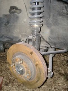

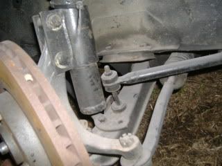

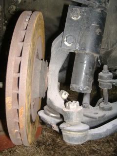

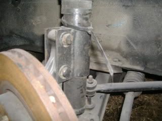

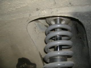

Heres the pictures of the suspension set up.  As you can see, the silvia coilover has been modified. I think this is because the as you know on some coilovers you cannot adjust the height of the coilover by screwing the threaded sleeve into the bottom bracket to lower or raise it. Im not too sure what theyve done with the strut tops, ill have to have a look when i get them out.But i believe cusco do a top hat to suite the s30's. Using the s13 hub also enables you to chose from a wide range of brake setups such as the standard R32 GTR/R33 gtst front brakes. Let me know what you think!!

Cheers for that link mick. I think they used the r33 contorl arms in my zed because theyre a bit longer therefore it give the front wheels a fair bit of negative camber. Im just waiting on some s13 coilovers to turn up so i can measure the top and get some cusco strut tops and wack them on. Ill post up some pics when its all done.
