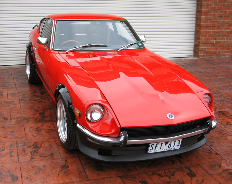

Installed the urathane front spoiler today. Amazing how forgiving it is! You can twist it or push it right in and it still jumps back into shape. I definatley think it's worth spending a few bux more and having this sort of peice of mind! It came as in the pic above. Not sure wether to paint it matt black or gloss like the flares and fin? I know 2 pak has a bit of flex but how much!?
Hmmm...will post pics soon!

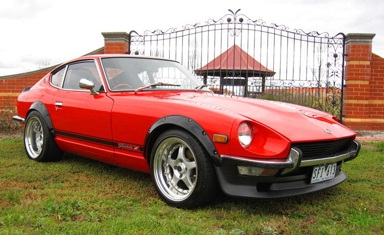

Posted 08 July 2006 - 06:07 PM
pics

Posted 08 July 2006 - 07:22 PM
That looks really nice Sulio! Great spoiler car - becoming better and better!
The only thing that I dont really like a bout it - is the difference in color between the spiler and flairs, but thats just me being picky i guess :D

Posted 08 July 2006 - 07:40 PM
it looks nice, but i also liked your old one, all three of those styles are nice front spoilers! it changes the look of the car quite a bit...take the verticle bits off the bumpers 8)
i like the gloss black flares on your car, i have no idea if i want mine gloss or matt, i think whatever this roll on paint ends up being!

Posted 09 July 2006 - 04:36 PM
Thanks Mike. Blue leaf I just used a pressure pack to spray it as I was eager to mount it so yer might still go gloss not sure as I reckon the satin colour does give it an aggressive edge.
Evan, I don't mind the over riders but when I get the front bar rechromed i'll get rid of em.

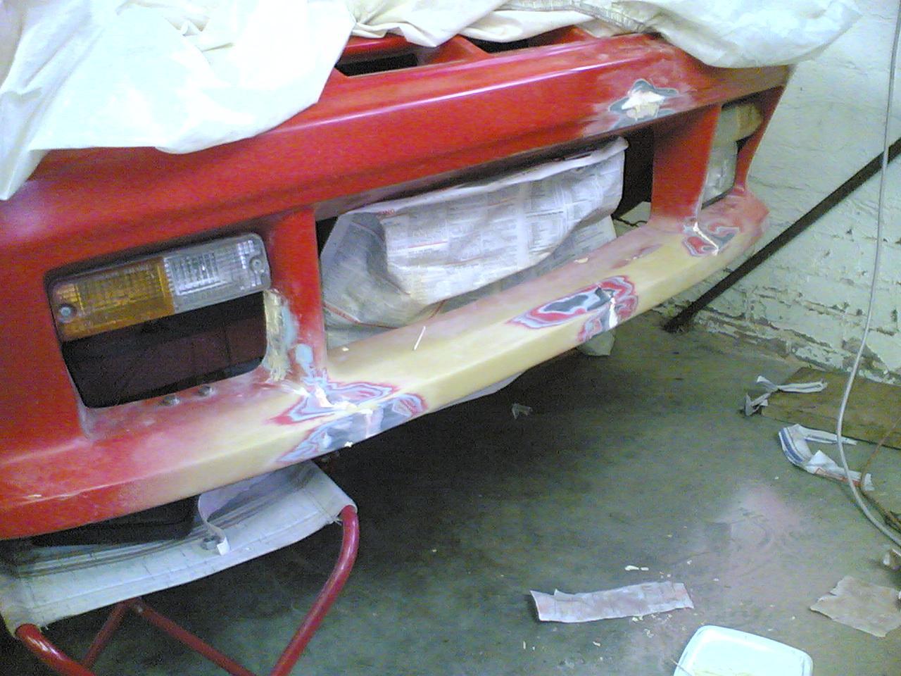

Yeah i have a fiberglass front spoiler, i like the idea of the slightly flexing type ones, but my glass one can take a bit of knockin and i like the look of it. Not that id know! ive driven the dam thing for only 2 weeks!!!!
Anyway when i bought the car it had 4 small but major cracks in the front spoiler so ive got round to fixing them. basically i re-glassed 2 or 3 of them from behind coz it was cracked right through and flimsy and then used filler and sanded on the front of all of them. and also fixed up a tiny bit of chipped/crappy paint that the filler/primer paint wasn't gonna fill in. ive filled and sanded little bits trying to make it as good as i can 3 times now, at least its easy as to whip up some filler and apply, i think im nearly happy enough to start applying coats of primer. heres a couple of pics i took an hour ago:

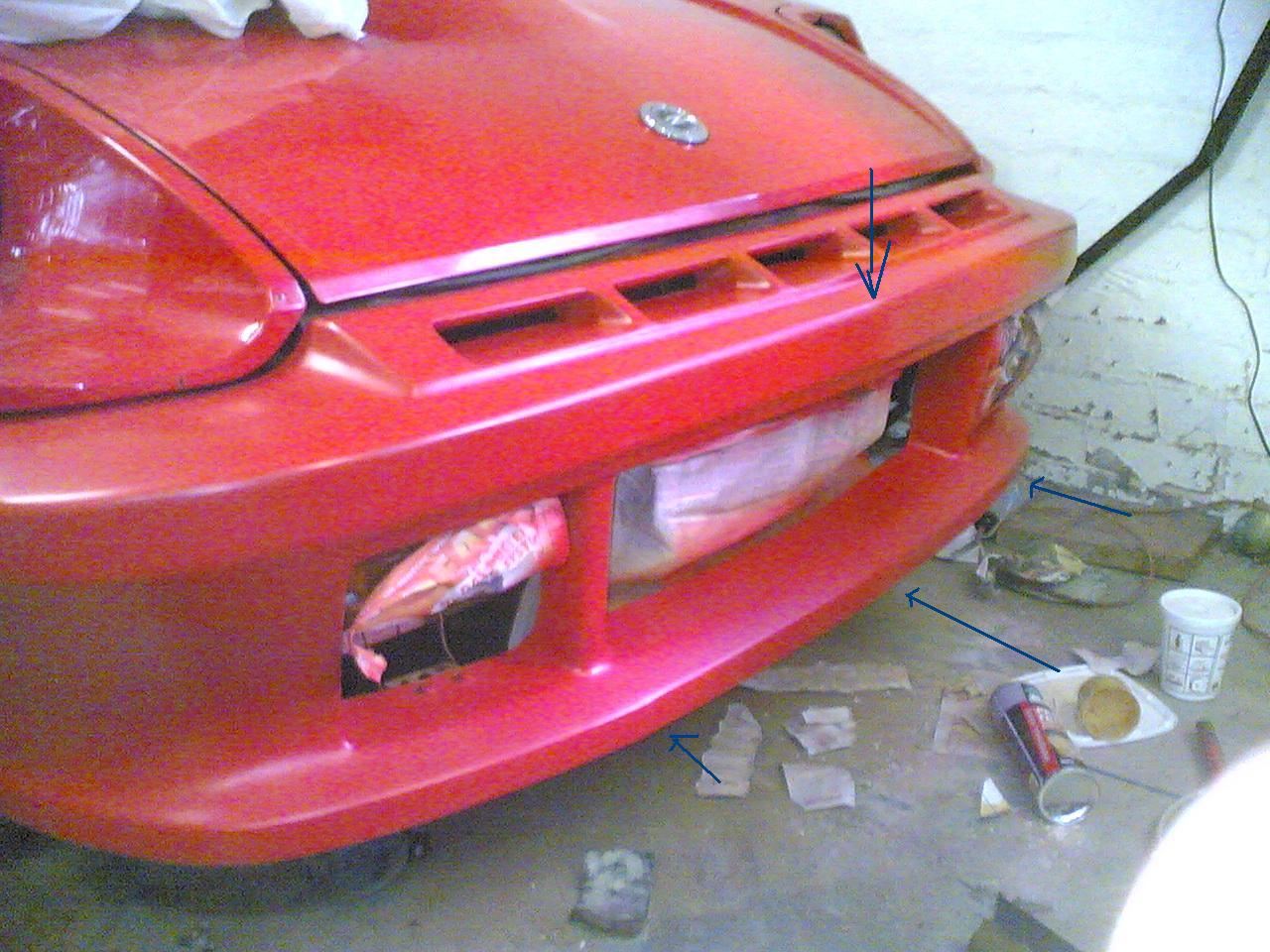

Posted 23 September 2006 - 05:50 PM
well i finished priming the front and then painted it yesterday with some custom paint the car came with. you can tell where the massive cracks were but only tell if your looking for them. and the paint matched reallllly quite well... looks a little fresher then the older paint on the front spoiler but blended pretty good otherwise so im happy with how it looks.
i took a pic just before... dam phone camera sucks so its even harder to tell where the cracks were, but here it is anyway...

Posted 23 September 2006 - 06:12 PM
looks nice, just avoid wrecking it! i'm glad i never bothered fixing mine as i've cracked it once on each side, and keep parking in car parks and forgetting that my car sits lower now. luckily i haven't been reminded by loud cracking noises yet! just keep walking back to my car and noticing it and thinking "dam that was lucky" hehe
