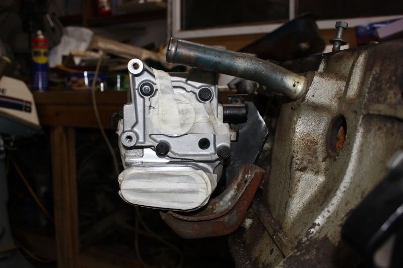

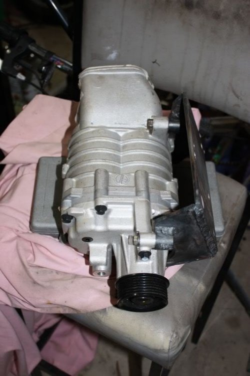

Here's my effort (on an L18)
It is pretty tight getting it all to fit on the passenger side. I am in the process of making custom extractors as I couldn't find a standard set that went anywhere close to clearing the blower that's mounted in the air-con compressor's spot.
For me, an issue was that I couldn't mount the blower any lower down, as it fouled on the engine mounting bracket - I'm not sure if the mount is set further back on a six cylinder block, may not be a bad as it is on a four cyl ??
I used an Eaton M45 off a mini cooper S - would be too small for an L28, but perhaps its bigger brother, an Eaton M90 off a supercharged commodore, may be a cheaper alternative to the sprintex ? The Sprintex would be nice though !!
As far as intercooling goes, I'm using a Subaru RS Trubo water-to-air setup. It will be mounted in the front of the passenger side of the engine bay (between the strut tower and the radiator support panel). Gives a very simple pipe arrangement - a few inches of pipe from the blower to the intercooler, the another few inches from the intercooler back to the throttle body. Again, I'm not sure how well it would cope with the demands of the bigger engine. The issue I had with an air-to-air one was pipe setup - since the blower and throttle are on the same side of the engine, it makes arranging piping more difficult (and longer).

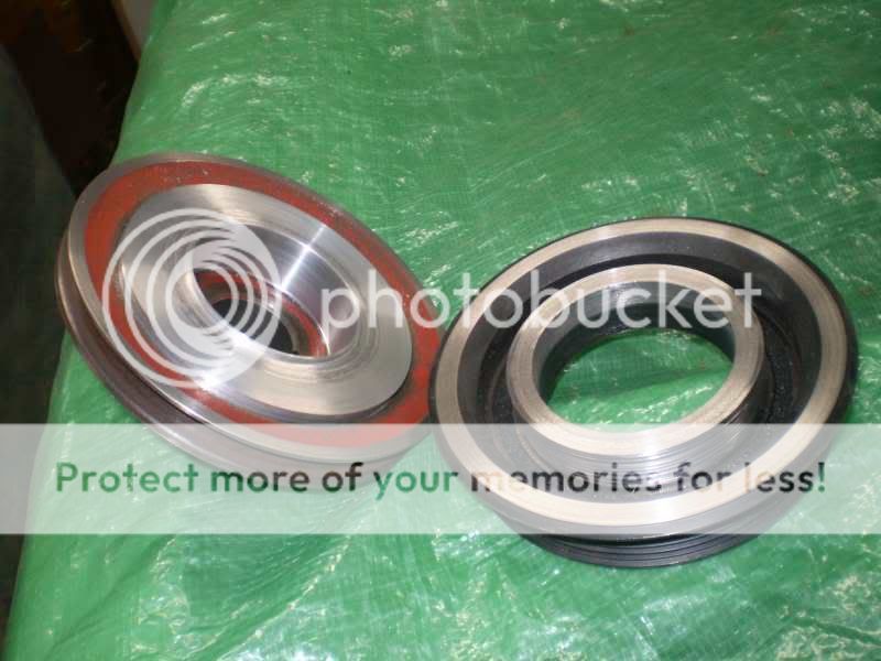

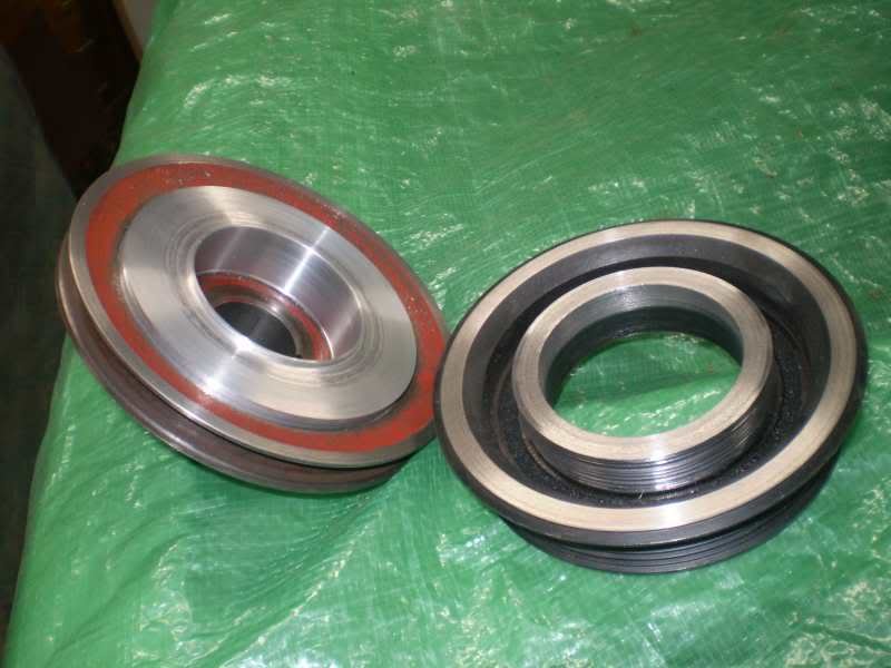

1600Dave, Can you clarify how you attached the multigroove pully to the front of the old single groove pully? Was it purchased or manufactured? More info please.
Datsport sell one that is designed for the SC14 supercharger off a Toyota, but it mounts the ribbed pulley section behind the "V" pullley (ie the other way around to the one in my photo). For me, that moved the supercharger another 2 inches or so further back, resulting in more problems with supercharger and engine mount trying to occupy the same spot. So, the one pictured is home-made to better suit the Eaton M45 supercharger I'm using.
Basically, its a stock L18 pulley that has had the inner surfaces ( ie the face where the crank pulley nut is, and the "underneath" part of the "V" pulley) machined flat on my lathe, combined with the ribbed section that I machined off a CA18 pulley. The CA18 was used as its an appropriate diameter to give the amount of boost I wanted. To join them, I turned up a lump of aluminium so that it was a shrink-fit inside the L18 pulley and also had a little locating ring to accurately locate the ribbed piece. Eventually the ribbed section will be attached to the aluminium piece with bolts, and there will be another set of bolts from the rear of the L18 pulley into the aluminium block (in case the shrink-fit isn't enough to hold it in place).
At the moment, its all held together with the big vicegrip you can see in the photo ::)
In the photo below, the ribbed section is on the right, the red pulley on the left is the original L18 one, and the shiny alloy bit inside the stock puolley is the custom-made part that joins the two pulleys.
Posted Image

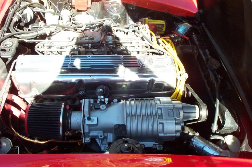

This might be interesting.......
http://www.cardomain.com/ride/2349143
Also...    http://www.zcar.com/...s/read/1/675982
#19 Mr240z

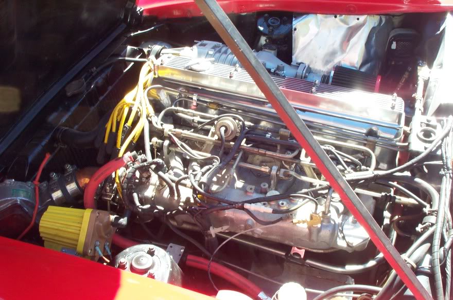

Kens blown Zed
http://www.flzclub.c...811ac9593f&t=42
