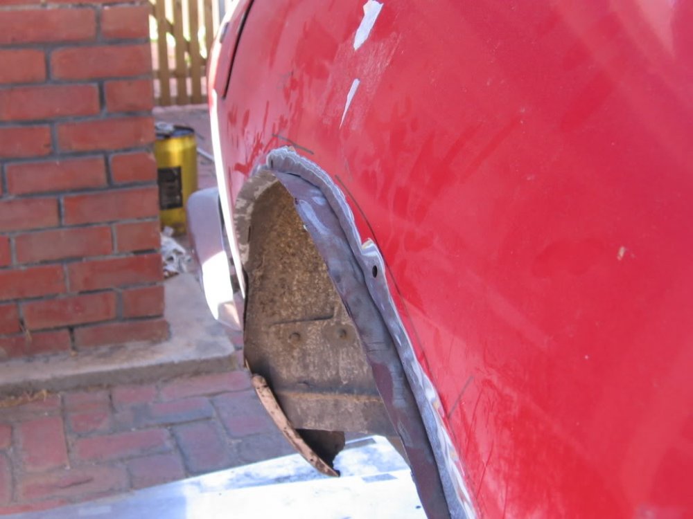

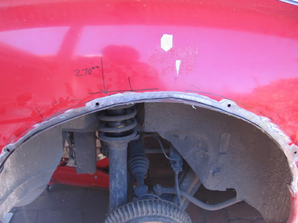

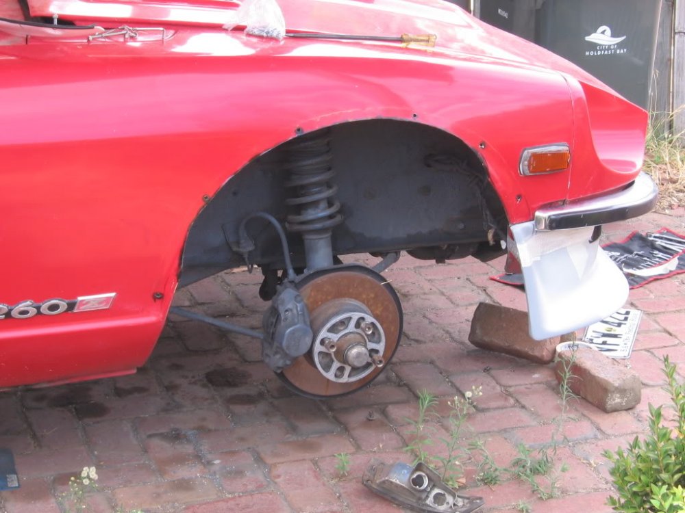

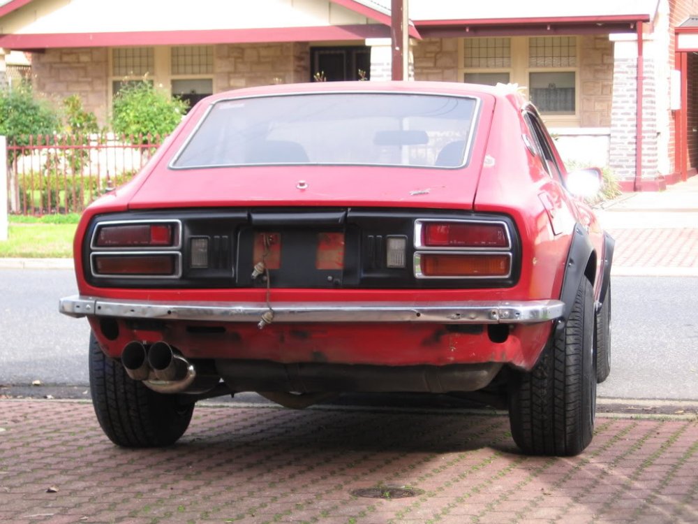

GTS-Retro Posted June 23, 2009 Author Share Posted June 23, 2009 test fitting and cutting front guard Ok so i sticky taped the flare into place and marked out the position with texta. I then added a second line 30mm below. The first line is cut but only thru the outer guard skin. The second line was cut thru both the outer guard and inner guard skins. The trust engineers mallet was used to slowly bang up the inner guard up and out to that it met the outer guard. i don't have photos of the welding in progress, but i slowly added tack welds along the join. then cut the excess metal away. as you can see i have some work to do getting the rear beaver panel correct and the rear bumper need some love. Looks like she had acne on her ass. After painting and a hand polish. Quote Link to comment Share on other sites More sharing options...

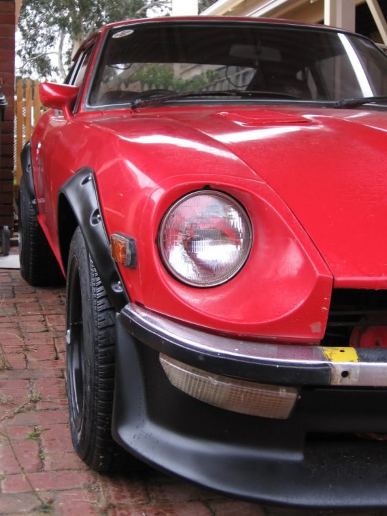

luke_mcmahon85 Posted June 23, 2009 Share Posted June 23, 2009 looks great.. where did you get the wheels? thats what i want my 2+2 to look like, but with silver, with a BRE front spoiler in black Quote Link to comment Share on other sites More sharing options...

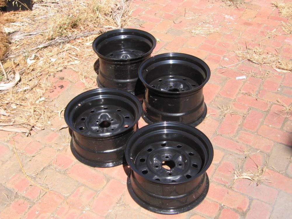

GTS-Retro Posted June 23, 2009 Author Share Posted June 23, 2009 I had the wheels done myself. there is a place in Adelaide that dose it. The new shells were ROH by manufacture so I guess they are good quality. The wheel centre have been welded around the entire circumference so they are blood strong. standard stockies just have a few spot on them. All up I think it was $780. Quote Link to comment Share on other sites More sharing options...

Moderators Zedman240® Posted June 23, 2009 Moderators Share Posted June 23, 2009 Zedevan, I've heard steel wheels aren't really suited for track use, they end to flex alot more than good alloys. For the street they are fine, but for track work you're better off with some good quality wheels. I agree those widened steel wheels do look cool on that zed! You do find alot of import motors in zeds. Back in the 80's alot of places like RPM engines used to install a lot of import L28's into zeds and Skylines for customers. Only way to check is with the ID plates for matching numbers. I doubt they were factory fitted. Edit: replaced the are - aren't! oops! Quote Link to comment Share on other sites More sharing options...
Cdr Zero Posted June 23, 2009 Share Posted June 23, 2009 Love the wheels, I think it's a look that more people should use to be honest, steelies with dish. You see a lot of that style in Europe. Quote Link to comment Share on other sites More sharing options...
stevo_gj Posted June 23, 2009 Share Posted June 23, 2009 But but its a 260.. 26, as in L26! You have one of the more common Air dams btw GTS-Retro, a few places sell them the one I know the best is Adelaide Z cars. It sure does improve the car hey. Those brake rotors sure have a lot of surface rust on them, does that mean they need to be replaced soon? Or does that disappear with use? Quote Link to comment Share on other sites More sharing options...
