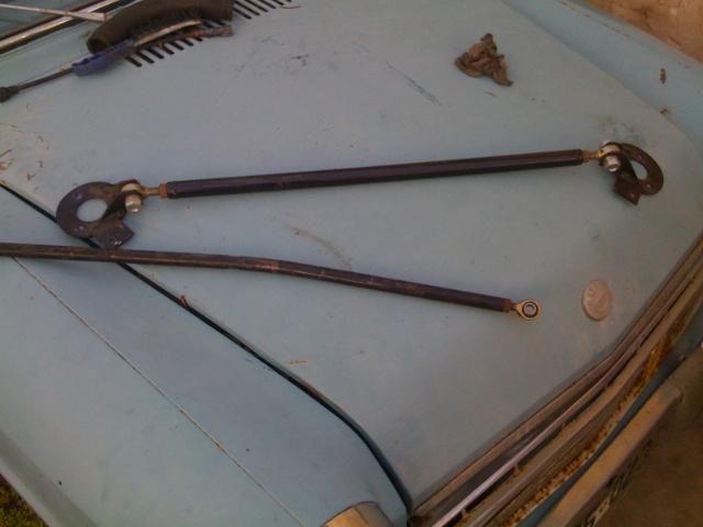

you could have some made by an engineer. mine have been made up and have tensioning nuts. If you would like some picks i can dig them out of the shed and take photos  ;)

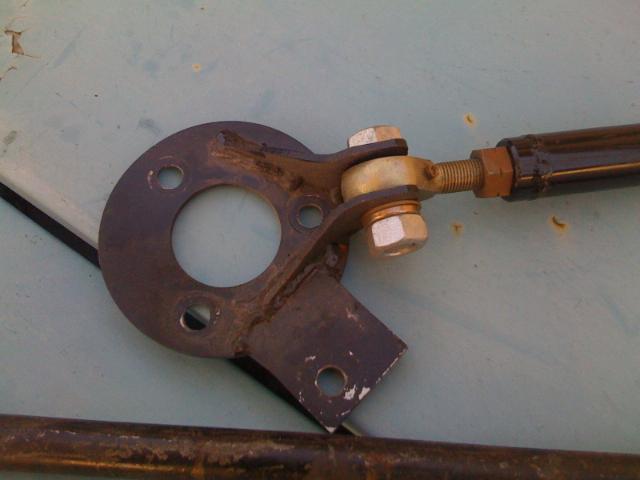

Here are my strut bars. I could not find the ends for the front bar, but they are pretty much the same as the rear. You will notice the bend in the front bar to clear the engine. The front bar is solid where as the rear is hollow As you can see there is adjustment to tension both front and rear bars
