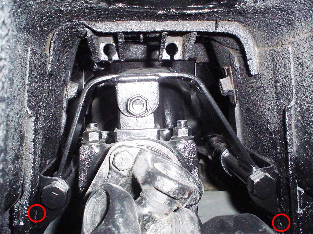

#39 zedevan
zedevan
  • 1,347 posts
  • Location:Melbourne
Posted 25 June 2009 - 06:02 PM
after looking at the picture of rbz260's car more, are there holes there that are currently not being used? (circled in red)
