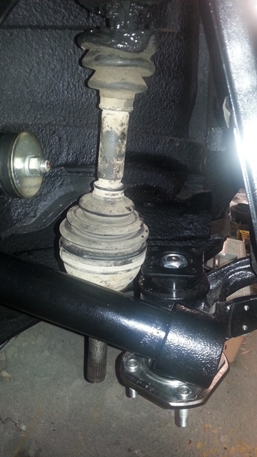

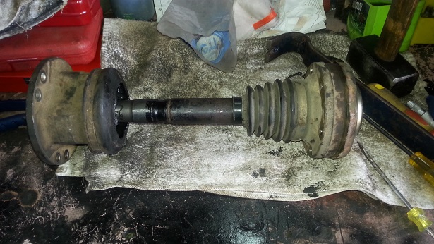

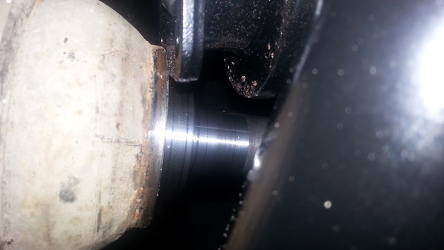

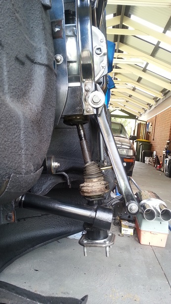

Nice work on picking up the S15 Helical :)  I finally got round (what is it, 2 months later?) to cleaning up my diff and installing the S15 helical centre.  I'm gonna try sticking with the 3x2 output flanges for now given the Pathy D21 4cyl axles mate up to them.
So findings so far - I've eliminated the possibility of cutting the shaft off the Pathy outer CV and welding on a flange - total assembly ends up about 3/4"-1" too long (passenger/short side of the S30)
See attached pics - one pic is the shaft at full extension out of the tri-pod end, the next is me pushing it in to make it short as possible.  That's with camber bushes fitted at full outward setting (ie. track width is wider than stock by about 10mm per side).
Any suggestions?

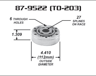

Atm I'm thinking I'll try another suggestion you had on hybrid Z... http://forums.hybrid...axles-bad-idea/
Empi 87-9522.  There should be heaps of old camry's etc at my local pick-a-part, so I might have a wander through one day soon with the vernier in hand and see if that Camry inner CV will fit on the 27 spline outer of the Pathy axle.  If so I'll grab one and see if it results in an axle that's the right length (once a custom flange is added to bolt it to the 4x1 s30 Stub axle flange of course).

Thanks for pointing me back to one of my old posts about the camry cv I forgot about that. Well I know the 300zxt Z31 4x1 on one end and the 5x1 on the other end of a pathfinder axle works (pathfinder axle needs to be modified with a snap ring groove cut so the 300zxt 4x1 can be installed)
On the short side it just works does not bind but gets really close to binding.

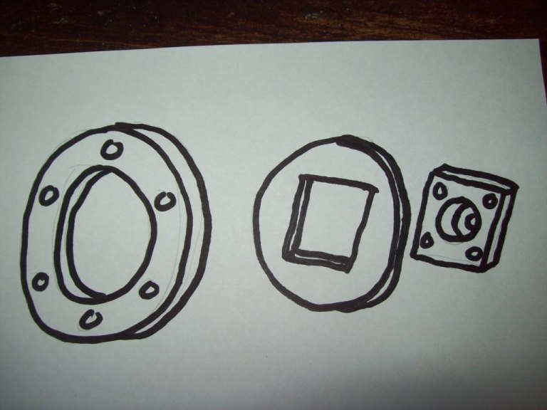

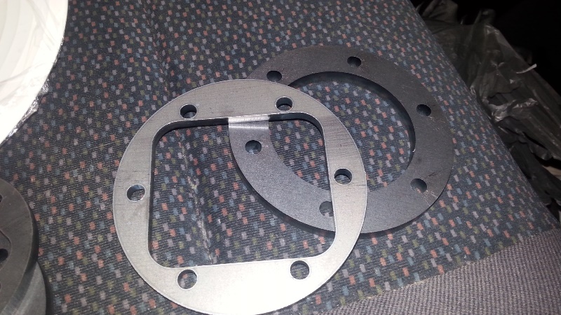

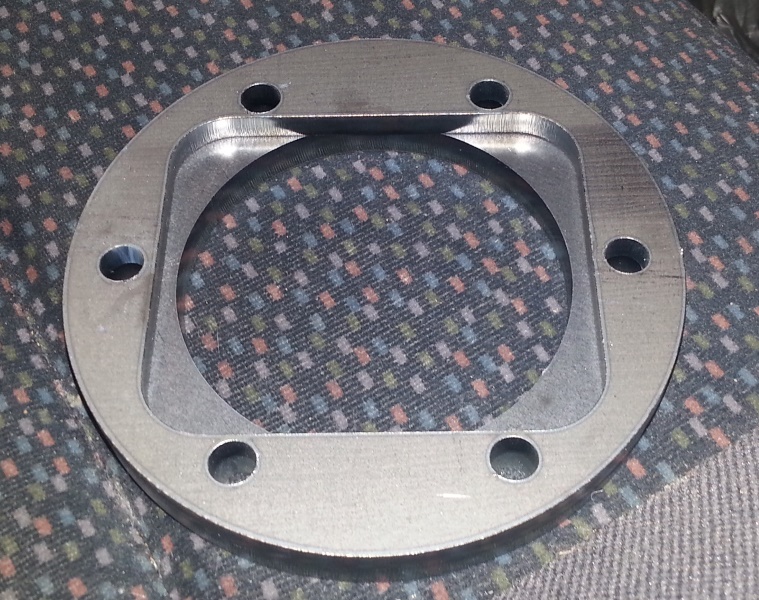

I assume you're using the Z31 4-bolt outer joint with something like a Modern Motorsports companion flange, or a custom adapter of some sort?
A couple of weeks of hard googling :P and some pick-a-part action has seen me come up with an unexpected combination... The D21 Pathfinder 4-cyl Inner CV (tripod), Pathfinder shaft, and (wait for it...) a VT commodore outer CV joint!  Has 27-splines and is the right diameter for the pathfinder shaft's outer spline'd section (noting the inner of the pathfinder shaft is a smaller diameter despite also being 27-spline).
No grooves to be cut as the Pathfinder's spring retainer on the end of the shaft works perfectly to hold the commodore CV in place too.  I was going to fit a circlip into the groove but the one I had didn't want to fit and the spring clip seems to do a perfect job or retaining the CV... just makes it slightly harder to disassemble later (few hard whacks to get the CV off instead of just removing a circlip).
Apparently the commodore joints are effectively Porsche 930 108mm types, and from what info I can find, appear to be the same on V8 and V6 commodores, suggesting it'll be strong enough for most decent zed applications (Mine is likely to have an RB25DET or VQ35 eventually).
I'll need to make/machine up an adapter flange to mate the 6-bolt Commodore CV to the zed's rectangular stub axle flange.  I noticed PeterAllen made up such a flange in this thread http://www.viczcar.c...ic,14440.0.html ... Might hassle him for a CAD file or drawing and see how I go ;-)
Overall length seem nearly perfect, maybe slightly long on the S30's short side, so i'm gonna try to keep the adapter flange as thin as possible (probably about 10mm thick overall... roughly the minimum required to let the inner race move through it's range without hitting anything (the standard cap fitted to the joint has a 16mm bulge in it, which seems unnecessary)

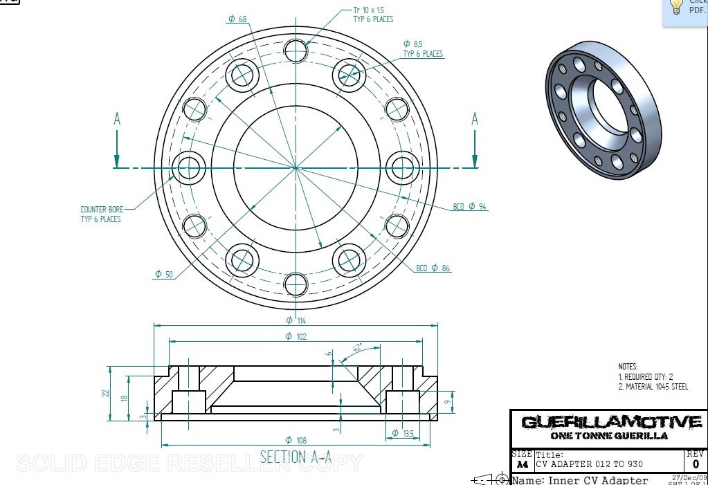

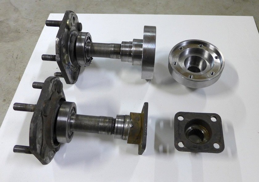

See this page on OZdat for my commodore CV's for a r180.
I machined up an adapter plate out of 6061 t6 alloy to suit the outer flange. 1600's are the same as a zed so might give you some ideas
http://ozdat.com/for...=20290&start=90
My previous 1600 came with a set of CV's with a nissan inner joint and a commodore outer to suit a r200 diff. I wonder if it was a pathfinder shaft?

Took a look Lampy - very nice work there!
Perhaps it was!  I wouldn't be surprised if someone had figured this out before - just a shame whoever it was didn't share the knowledge!
You would by any chance have a CAD file for that adapter would you? ;)

Posted 02 January 2015 - 09:12 PM
Unfortunately i dont have a cad file. Just knocked them up on my own lathe.
I dont think you will be able to make them any thinner without sacrificing some plunge on the outer joint. Mine was about as thin as you can get because the steel cover fouls on the bolts holding the adapter to the datsun flange
