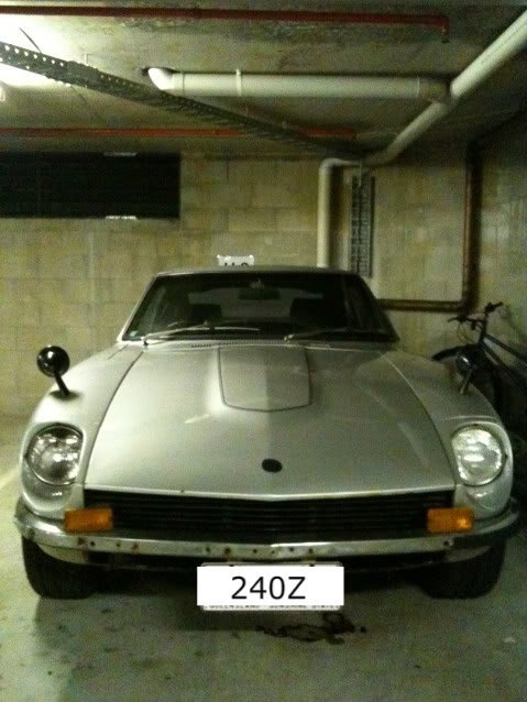

#5 d3c0y
d3c0y
  • 2,932 posts
  • Location:Brisbane
  • Tagline:Forum Jerk
Posted 04 August 2010 - 07:17 PM
OK so epic thread dig i know, but i installed my mirrors using the above diagram and it looks wrong compared to everyone else's mirrors.
They look forward and inboard what does everyone think?
Posted Image
Posted Image

#8 Riceburner
Riceburner
  • 3,265 posts
Posted 04 August 2010 - 07:58 PM
I recently fitted my fender mirrors using the diagram above. Looks fine to me, they actually stay inside the outer line of the car which is probably good in terms of safety, doesn't affect vision at all. You don't even notice that they are in slightly different positions.
Vision is how shall I say.... Interesting! They look awesome though
#9 d3c0y
d3c0y
  • 2,932 posts
  • Location:Brisbane
Posted 04 August 2010 - 08:14 PM
Vision from mine is really good i can see right up the driver's side of the car and the passenger's one shows the blind stop clearly.

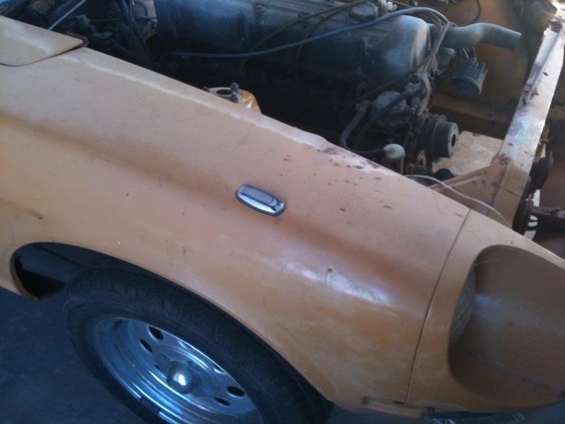

#19 RBZ 260
RBZ 260
  • 1,174 posts
  • Location:Adelaide
  • Tagline:S chassis Nutter
Posted 19 August 2010 - 09:59 AM
here is a pic i found floating on my work pc from my S1 240z #227 with the nissan plugs where the fender mirrors were.
i can't measure it till the weekend.
Posted Image
#20 d3c0y
d3c0y
  • 2,932 posts
  • Location:Brisbane
Posted 19 August 2010 - 10:57 AM
Great pic - shows how different it really is to the diagram.
