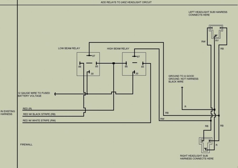

and then i have to get a relay for the H4's
either buy the one from black dragon auto
http://www.blackdrag...ll.aspx?Page=61
or make something like this
Posted Image
then just chuck it all in

ive got the diamnond h4 lense conversion with standard globes. though i have r32 wiring so its still up to the job.
i dont find much difference between this and the more modern cars. ie the S14 which u can compare to.
so ur idea is ok. it will be a big improvment over stock. expecialy if u get fresh wiring and new relays.

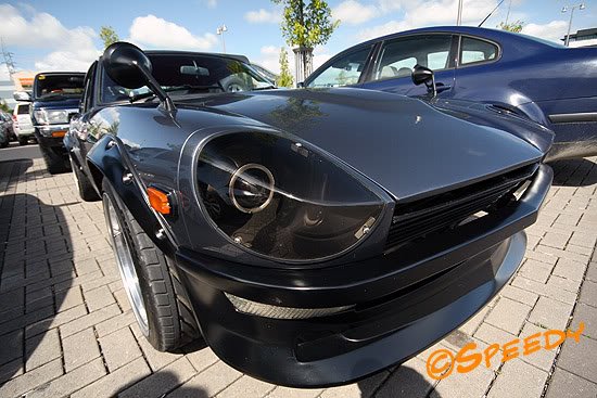

You should really use projectors with the HIDS,  Too much light escapes without them and you end up blinding oncoming traffic........Ive just finished installing mine.

your's look awesome jay, i'm wanting to go dual projectors and have them floating behind a headlight cover like you've got
there are factory hid setups that use reflectors, they use modified bulbs and generally dont produce as nice a light, and dont have anywhere near as nice a cutoff line
projectors are not all the same so its not as simple as getting a 7" housing that has a dodgy projector floating about in it thats made for H4's - not even all hid projectors are the same
this is how you want it to look
Posted Image
just need to find some damaged honda accord euro lights to steal the projectors from! i only have e46 projectors, which spread the light out evenly, but the beam is not as wide (not really an issue as the zed buckets block half of it anyway) and the cutoff isn't as sexy :(
