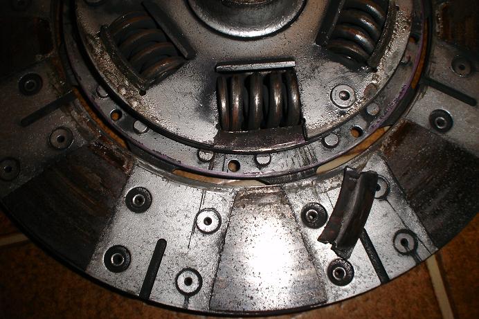

got it out. just over 2hrs not bad doing it on the ground and by myself. few casualties to my fingers but ill survive.
as expected the clutch plate was shagged. note the broken bit around the spring. also had few cracks around the other ones.
now for flywheel machining and new clutch hopefully tommorow.

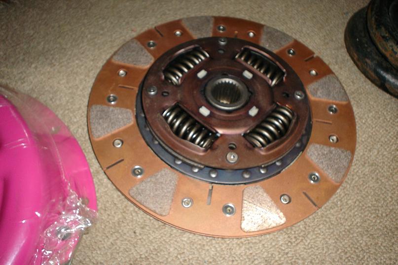

welll this is what i can do to a $1200 excedy clutch ...... time for carbon
#8 RBZ 260
RBZ 260
  • 1,174 posts
  • Location:Adelaide
  • Tagline:S chassis Nutter
Posted 30 April 2009 - 09:48 AM
looks like you rougher than me  :P
than again rb25boxes are lot stronger. i think my gearbox will blow quicker than the new clutch.

So it wasn't pad failure rather localised stress around the dampers......now we have evidence that you drop the clutch!  ;D
