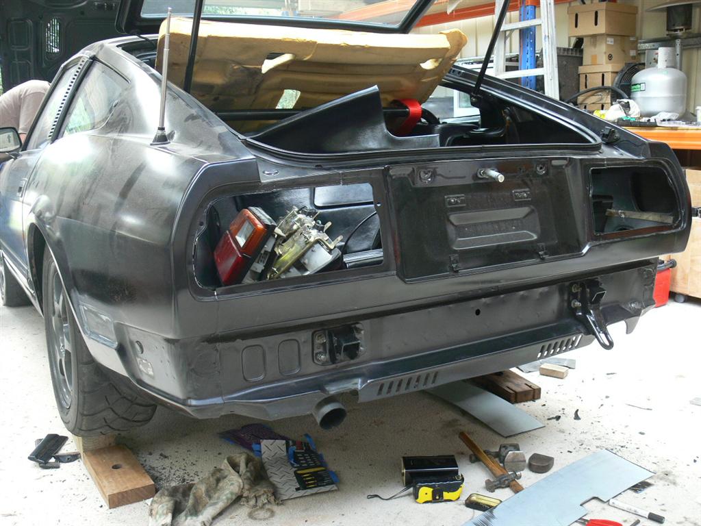

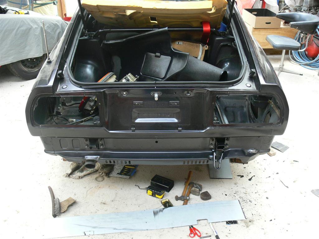

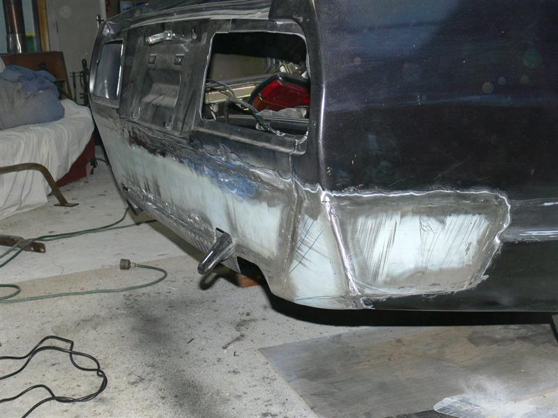

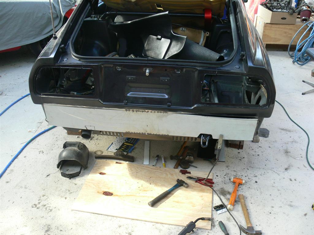

Here are some pics of my progress on filling the rear bumper.
Taking longer than expected.
Dad is working on the front bar at his place, slowly.
So it should look and go like a different car pretty soon.

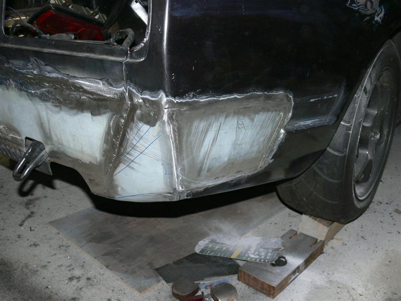

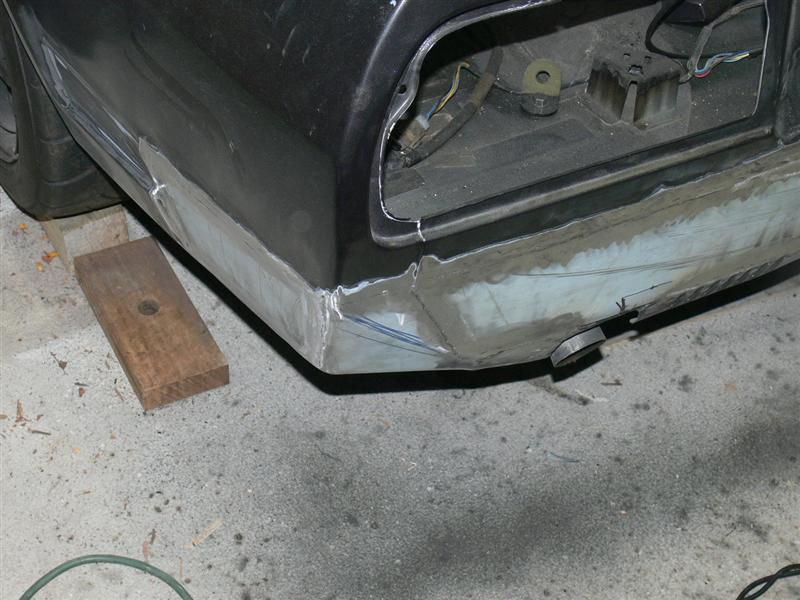

Posted 23 May 2009 - 08:54 PM

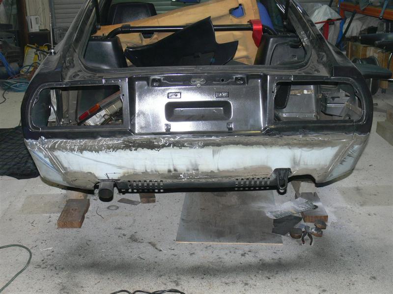

Update
Got some time through the day to work on the car. I realised that I haven't driven it since last year, gotta get crackin!
Finally borrowed a mig welder, this time with gas.
Pretty happy with the outcome, but still not over yet.

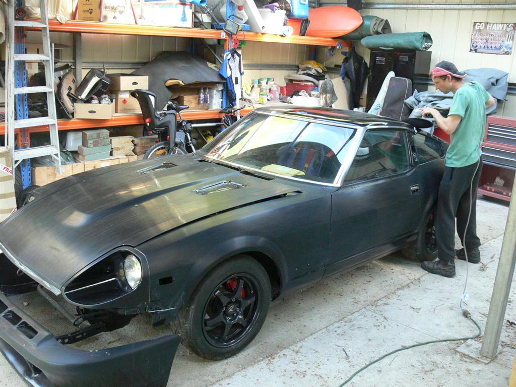

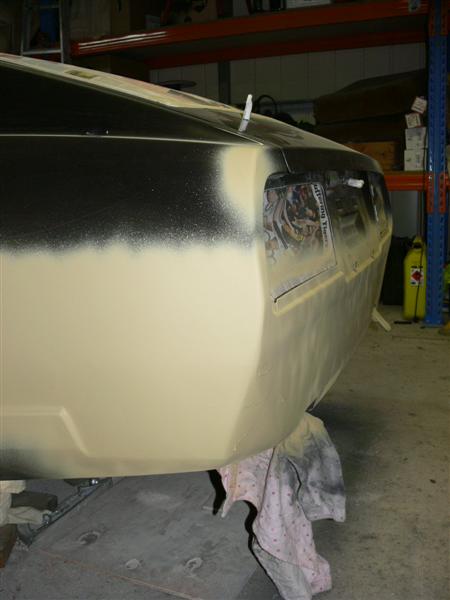

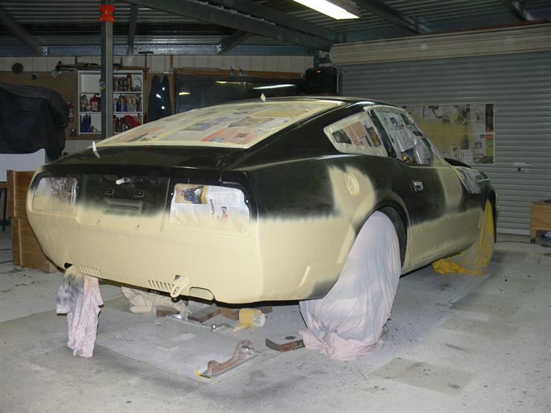

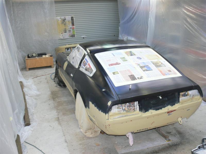

Posted 23 July 2009 - 07:12 PM

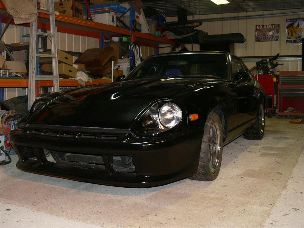

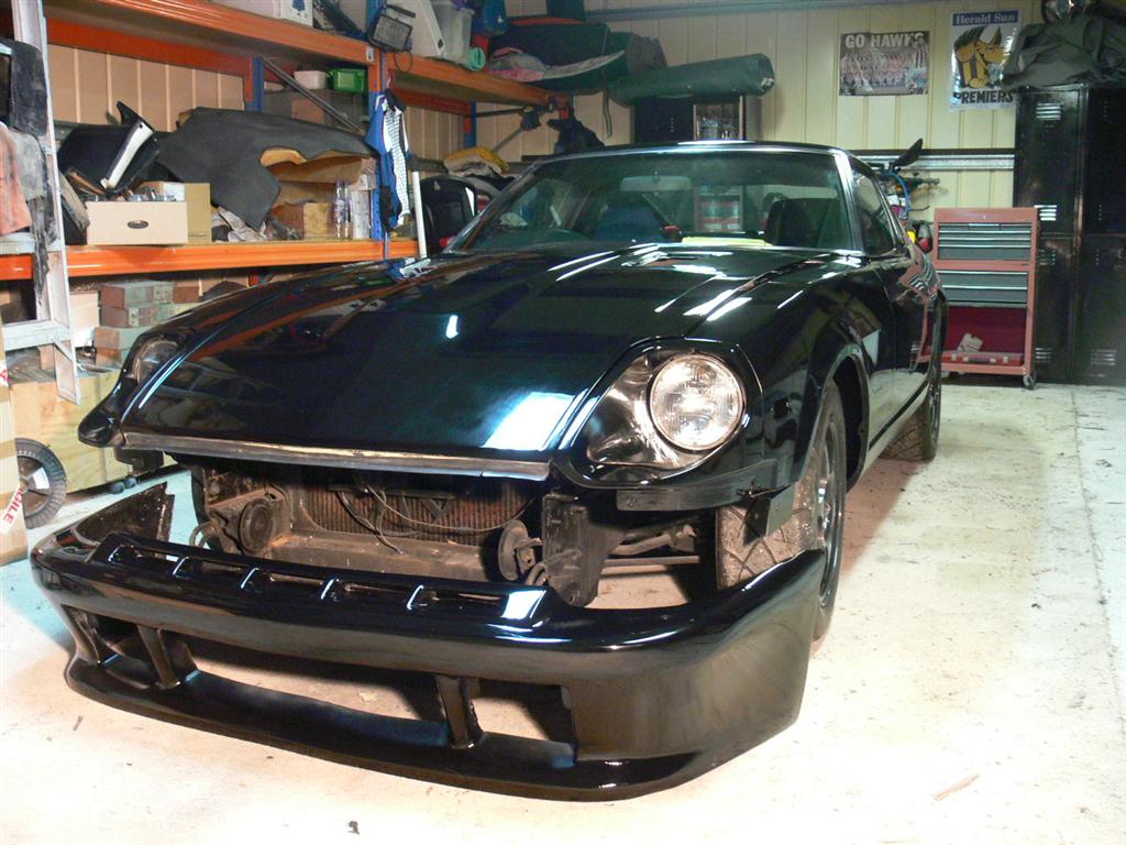

Here is an update from last weeks work.
It has all since been rubbed down with 800 grit and is ready for paint.

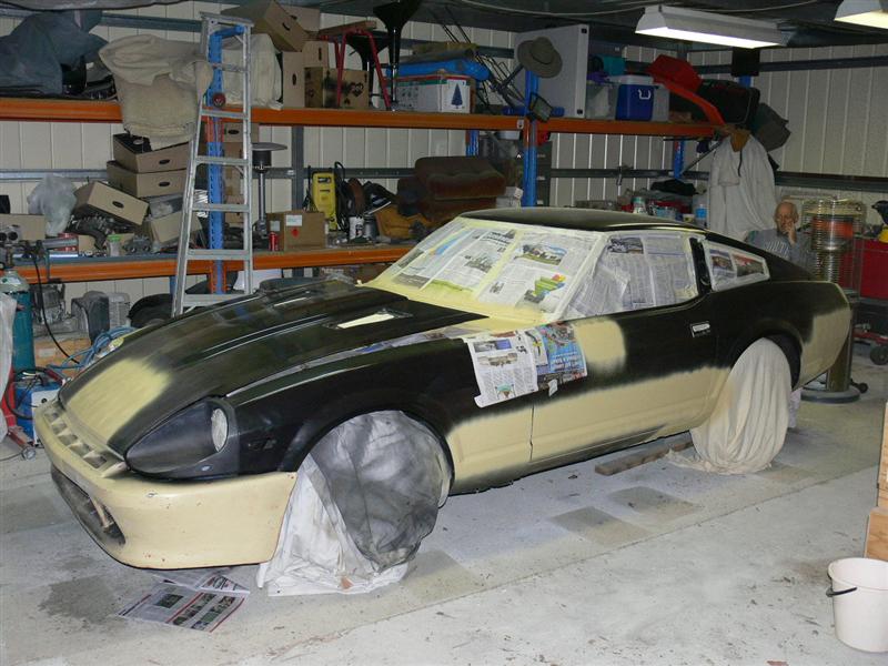

Went into the hospital to see the new addition to a mates family, a new baby boy. And I was talking to him, he is a panel beater by trade. He offered to take the Z around to his workshop to paint it in the spraybooth  ;D Woo Hoo. Thats gotta be better than my makeshift booth with a dusty floor.
Anyway, I'm happy with the rear panel work. Has been lots of work, would be over 20 hours of sanding alone. Obviously would be less for a pro, but I wanted to be happy with the final product.
Last pic is of the first fit of the front spoiler.
Just waiting for a phone call for when his wife will let him paint it.

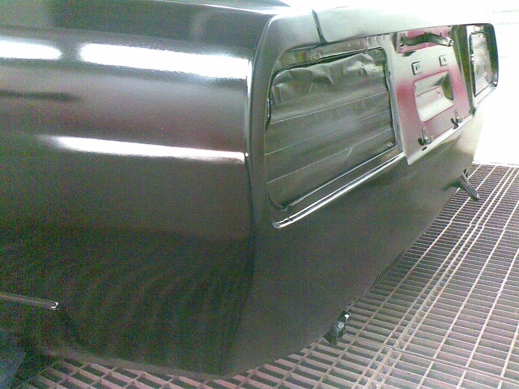

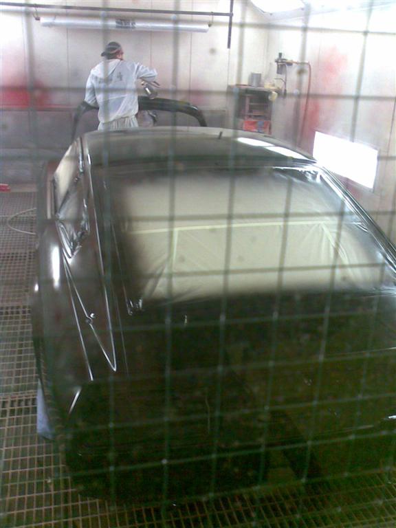

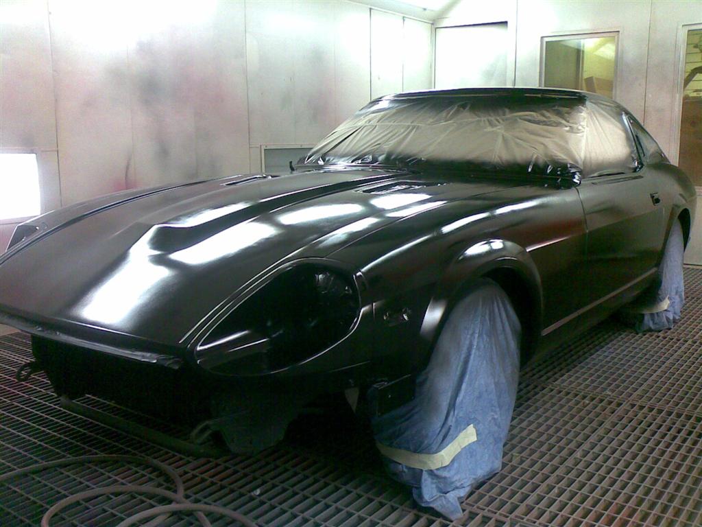

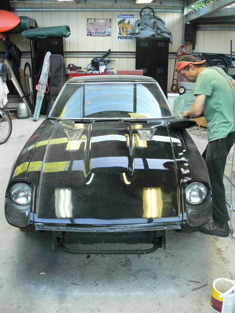

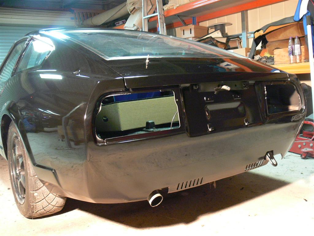

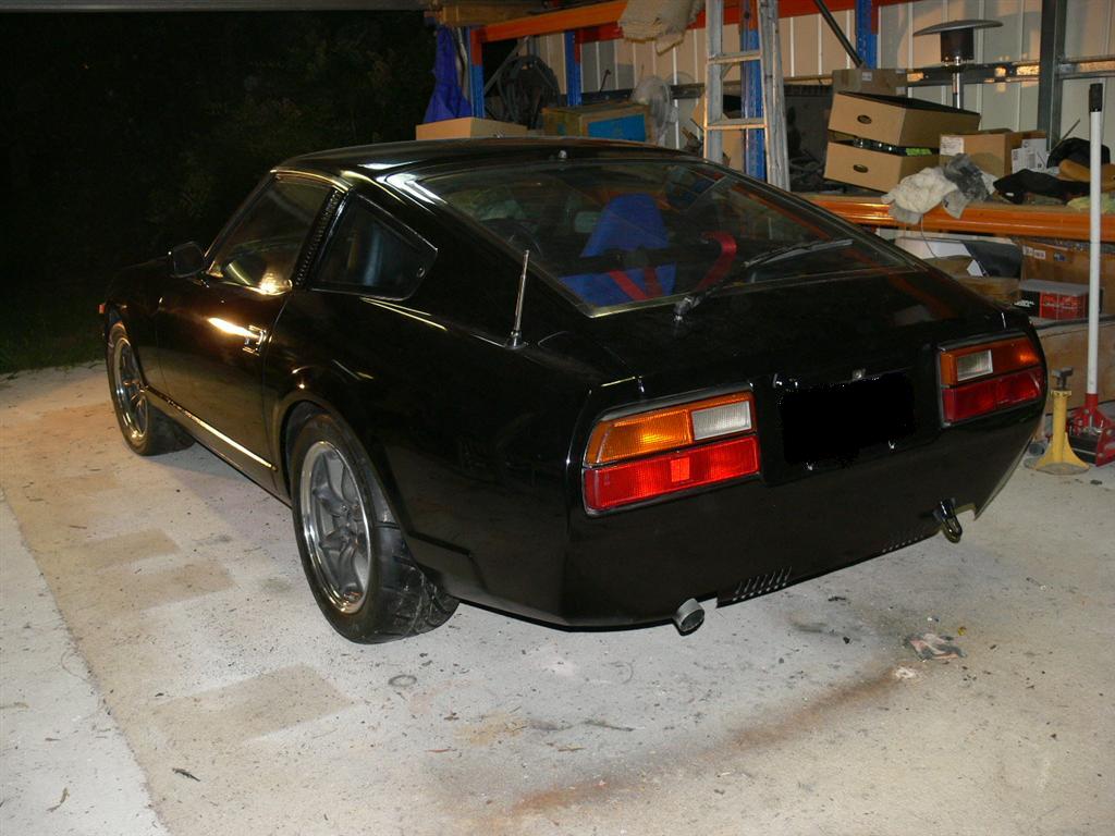

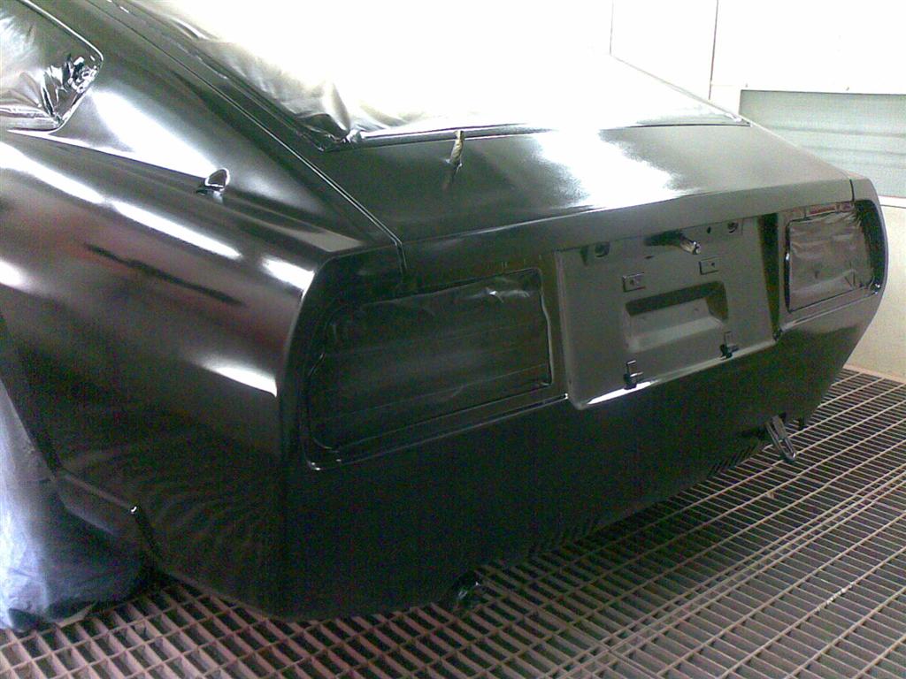

Posted 03 October 2009 - 06:29 PM
The cars home safely in the garage after 4 coats of black and 5 coats of clear.
Next Sunday will be spent giving it a wet rub while watching the Big Race sinking a few quite beers.
Big ups to my mate Stu for painting it for me  :)
Amazing to see how fast and efficient he does it, would have taken me a month of Sundays to do what he did in hours.
