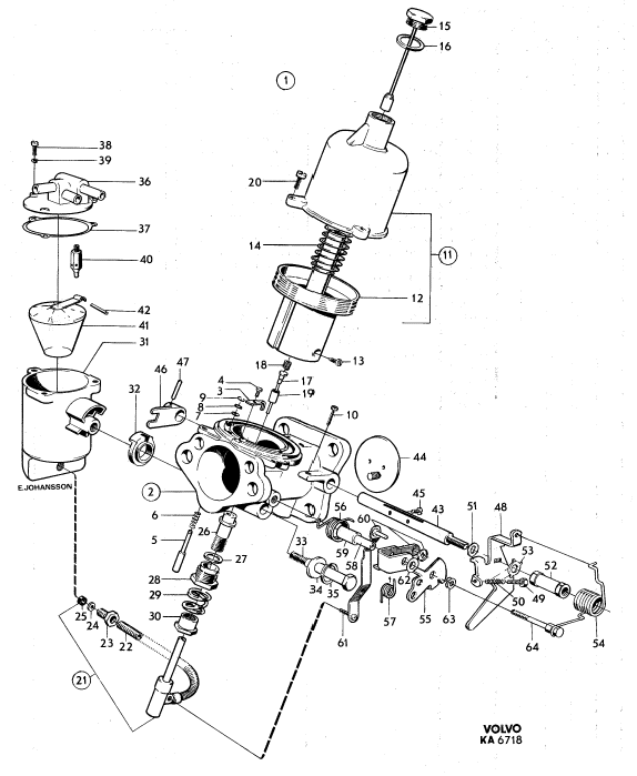

I'll check those out today.  Thanks for the suggestions.  What number is the carb slide on the diagram?

The carb slide I was talking about is no 12 in the diagram. Have you done the clunk test?
That is raise both slides with your fingers and let them drop together, they both should fall at the same rate and make a similar clunk sound when they hit the bottom. If they don't, they are fouling on something.
