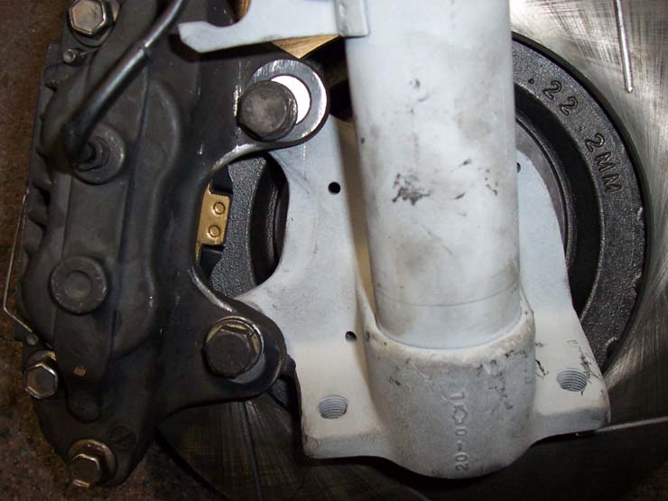

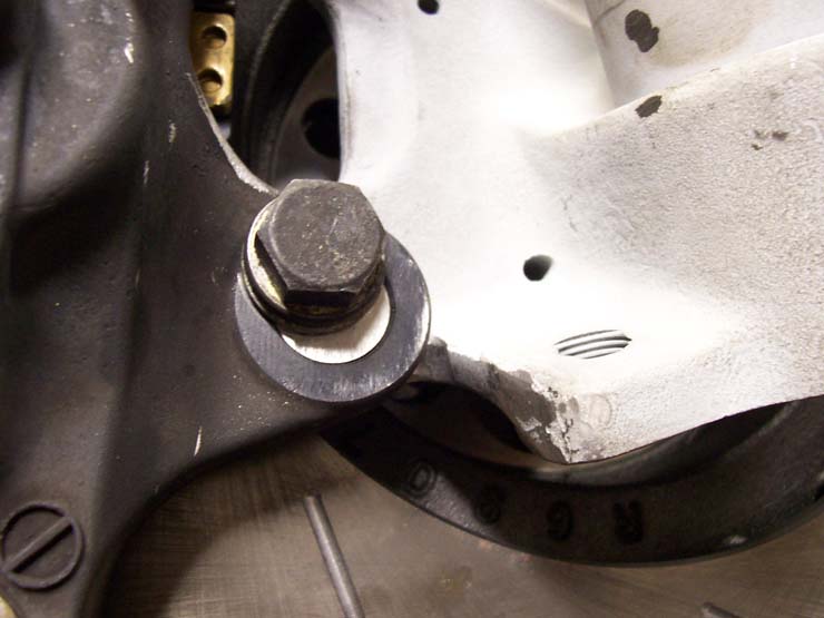

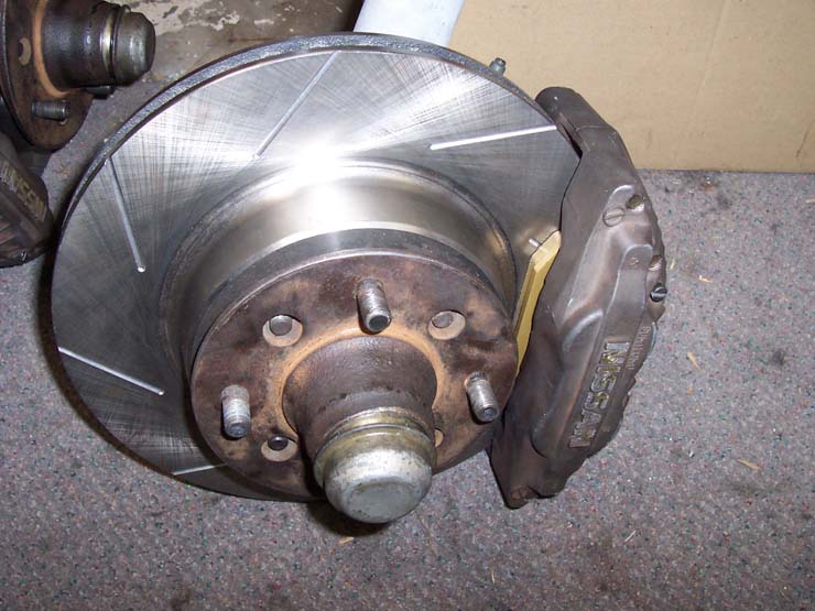

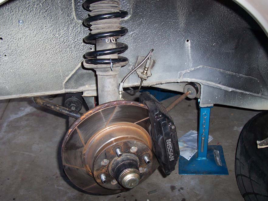

Posted 23 May 2009 - 09:10 PM
Well, here are the pics.. Let me know what you think.
