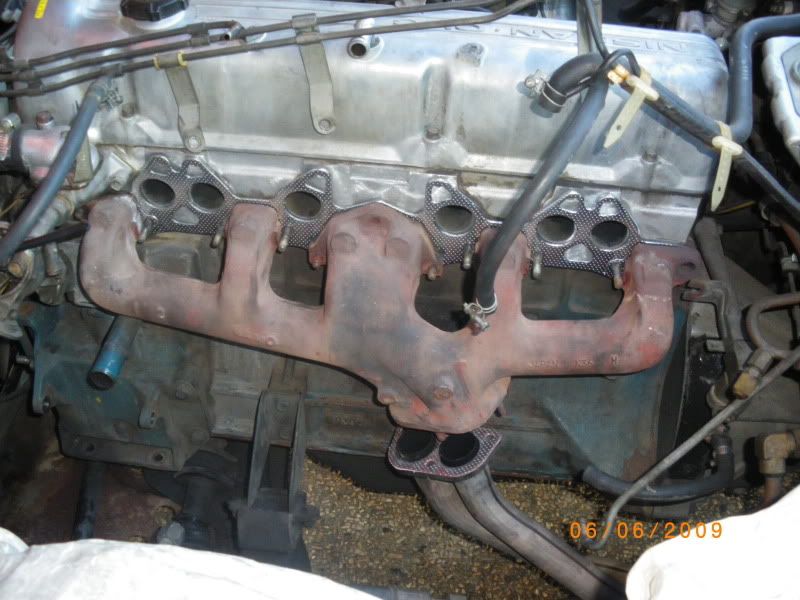

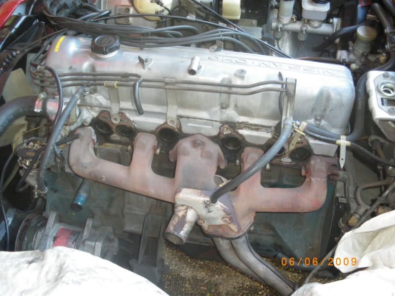

Well here are the pics from Saturday:
Here you can see what I started with, eugh:
Posted Image
Posted Image
Unplugged all relevant hoses and unbolted the carbs to expose the exhaust manifold:

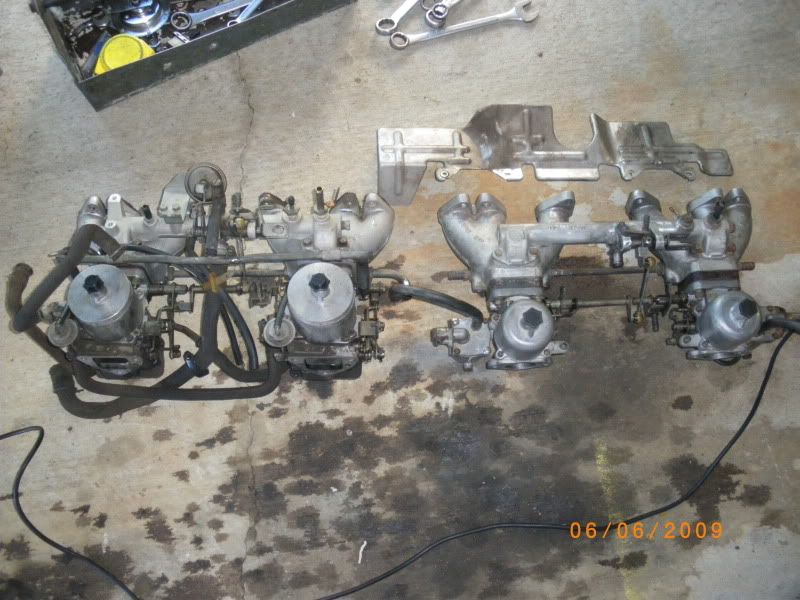

Comparing the two sets of Carbys:
Posted Image

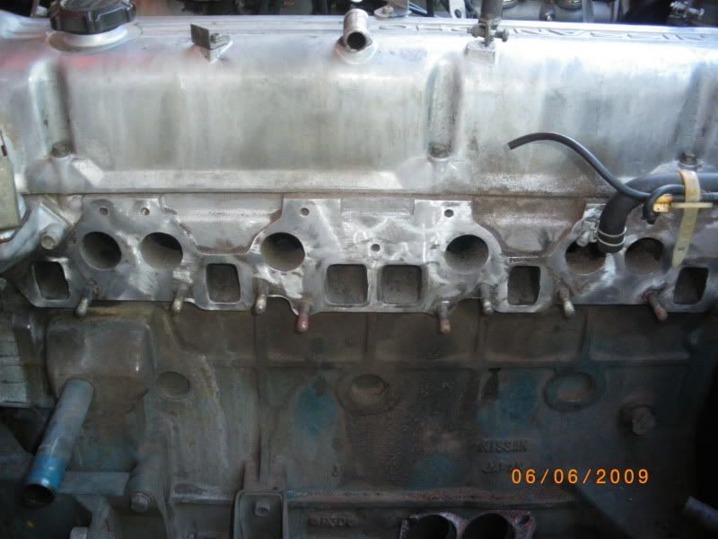

Cleaning the crap from the old manifold gasket:
Posted Image
What we ended up with:
Posted Image

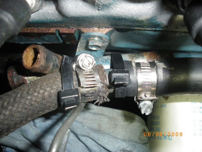

Removed water lines that fed into carbs and created a temporary bypass of the T junction for water:
Posted Image

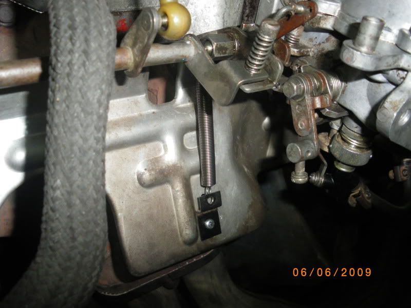

Here are the accelerator linkage springs I bought from repco and installed using a couple bits of metal that I drilled holes into:
Posted Image

Here is what I started with, as a reference:
Posted Image
Most of the emissions stuff is gone, as you can see. I took out the carbon canister and the plastic bottle too as well as heaps of little bits and unnecessary hoses.

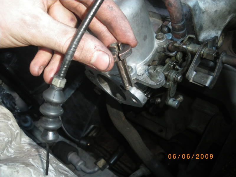

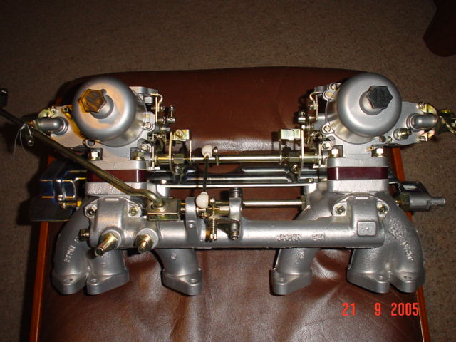

#56 Thomo260
Thomo260
  • 208 posts
  • Location:Ballarat, Vic.
Posted 10 June 2009 - 08:28 PM
When you say you removed the 'plastic bottle' are you referring to the vacuum tank? If so, how well do your demist controls work with it gone? Also here is a pic of my 260 with dome top choke mech. for reference.
#57 stevo_gj
stevo_gj
  • 1,561 posts
  • Location:Brisbane
  • Tagline:Steve
Posted 10 June 2009 - 08:31 PM
When you say you removed the 'plastic bottle' are you reffering to the vacuum tank? If so, how well do your demist controls work with it gone? Also here is a pic of my 260 with dome top choke mech. for reference.
Hmm you could be right, my mates Dad said it was emissions related since it was connected to the solenoids but I haven't tested my demister controls. You're referring to all of the different airflow settings on the aircon? They haven't been working in a while hey. It's sitting in a box atm so worst case I just bolt it back on.
Thanks for the pic, it appear as if the choke cable doesn't connect to any bracket at all, it just sits in that hole.
