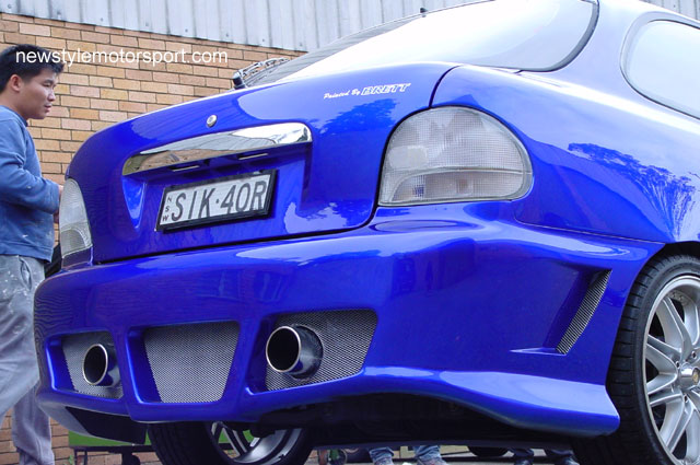

Sir Ricer Posted February 5, 2009 Share Posted February 5, 2009 Hahaha.... Oh Mr Chartoo, me thinks you are right on it, With that nice ricer maker front bar You can cruise with me and all my homies any time bruz. Back in my home land Hyundai build fully sick cars and the big boats as well This picture off my bro's car Fully riced up Quote Link to comment Share on other sites More sharing options...
