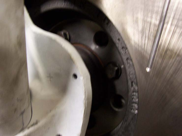

Its been done, and there are many variations to it. This is the DBA106B disc and R32 caliper and machined 260Z hub (not 240). Caliper mounting holes have to be re-drilled though....

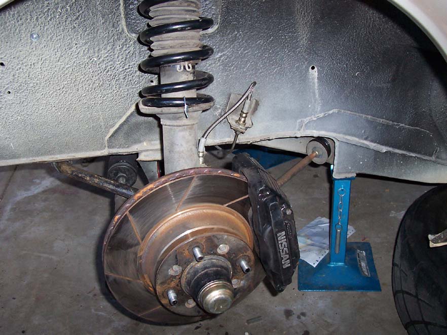

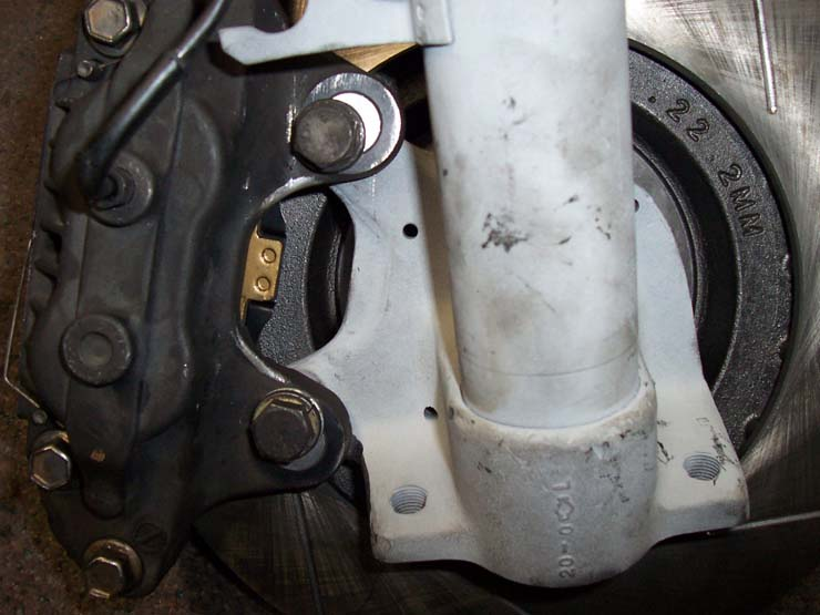

With my conversion, you must use 260Z hubs and machine the face (where the disc mounts to) by about 6-7 mm to center the disc in the caliper, re drill the disc to the same PCD as the hub (which isn't the same as the wheel studs) and machine out the disc hub to again suit the 260 hub. With the caliper, you must remove the threaded inserts in the mounting ears of the caliper and machine some aluminium "slugs" to press fit into the caliper mounts. Then with some careful measuring once you have mounted the disc on the hub and onto the axle, find where to drill the new holes into the caliper mounts. I have some pics which I hope make more sense.
