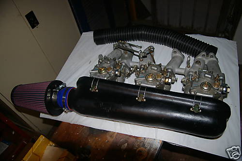

Hello peoples
I had this idea mixing around in my head since before the Apollo Bay cruize, which was to convert a rocker/tappet cover into a cold air intake for the Z.
So this is what i had in mind.
Firstly i went to the local wreckers and picked up a Nissan rocker cover (not sure of the make and model) and then gutted all the baffles and reinforcments out of the inside.
Then it was down to the aluminium supplier where i got a piece of 2mm aluminium plate 700x200 to which i cut to the shape of the rocker cover and then took a template of the carbs (triple dellortos) and copyed it to the plate.
After an hour or so of cutting out the bolt and inlet holes it was only a matter of a good clean and then mounting the custom backing plate to the carbs along with the 2" trumpets.
Then the rocker cover needed to be fitted with a TFI Racing adaptor to fit the memorex flexible hose. It's a tight fit which required a fair amount of modification to the adaptor because of the lack of space.
Then after a clean it was just like bolting a normal rocker cover on and a short trip to the speed shop to pick up the Hose, Pod Filter and one 45 degree 76mm bend.
Cost was
Rocker Cover       $5
Aluminium Plate    $13
Pod Filter            $20
Memorex Hose     $32
Filter adaptor      $20
45 Degree bend   $20
So thats it all up $110 and about six hours work.

Taking it 4 a spin was a real trip after the Mod. The first thing u notice is the sound as it makes a noise that can only be described as Modern. A much more smoother induction sound. Secondly, the 2000-4000 RPM is stronger and it was the first time i had the car sideways through a roundabout in the dry (bear in mind that i run an auto) which was real fun.

I don't think that would be too much to ask as long as you can fit the 3 inch 76mm hose over the air cleaner intake it would be all good.
I took the car on the highway today and then pulled over to feel how cold the carbs were and WOW they are really ice cold and i feel that it really simulates that frosty morning air that just makes Z's run soooo nice.

Took a few more pics of the setup as i had bits off polish'in them today. It's really good to hear such positive responses, as i thought u guys would think i was a friggen idiot.
I was thinkin painting the box Red Metallic as the tube and air pod are red too.

I notice there is some 10mm odd holes in the aluminum backing plate Scoota. Are these a mistake? Do they let un-filtered air into the air box? Or do they allow access to adjustments screws on the carbies?
Looks special by the way.
Those holes are for the fuel over flow just in case the float level goes all haywire.

whats the weight like hanging off the dellortos?
Mike
I didn't weigh the sucker but it's very light and i'm actually wondering about the validity of the soft mounts as with all th carbs joined there's not a lot of movement in the soft mounts.
I thought that the soft mounts were to stop the fuel from foaming more than anything else? They are going to be more rigid now they are connected as one after the soft mounts.
#19 PZG302
PZG302
  • 1,751 posts
Posted 27 October 2008 - 01:09 PM
Don't get of the soft mounts!!!!!
They help a hell of a lot with the overall reliability of your setup, in that the carbies are not shaken to death. A lot of guys using triples on Hemis in Valiants have dramas because most kits don't include the soft mounts.
I have had a couple of 4 cylinder L series powered cars with twin Webers and would never have run them without the softmounts. My Charger will also have the soft mounts fitted when the motor is built and the Webers go on that.
Another way to isolate the cold air box from the carbies to reduce weight would be to mount it to the inner guard and then sealing the trumpets to the plate using some insertion rubber. This will allow the carbies to move with the motor but still provide a resonable seal. Will also take all the weight of the cold air box off the carbies, though from what it looks like the weight shouldn't be too much for them.

scootag : thanks for the weight issue. Been thinking of modding a jaguar xj6 Cold airbox to fit but it is quite heavy.
DONT GET RID OF THE SOFTMOUNTS! Yeh I meant to shout that as well. Fuel frothing issues suck a crapload with dellortos ( cant talk about webers but dellortos work really well with softmounts i found out ! ).  Apparently you can also shake the needles to crap and back as well as hurt the delicate fuel float parts with shaking. I learnt this the hard way.
