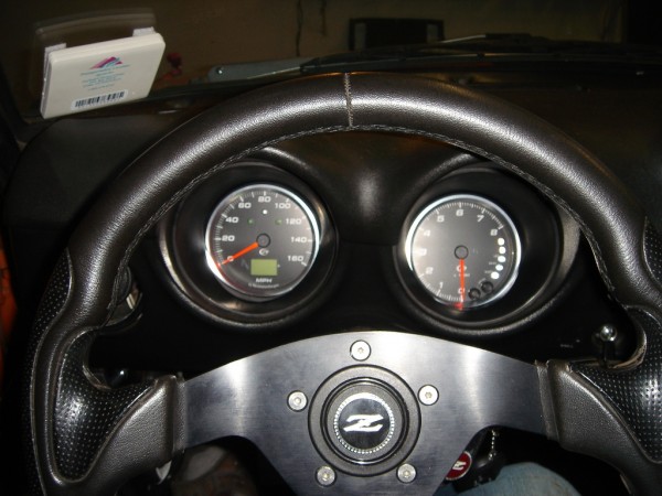

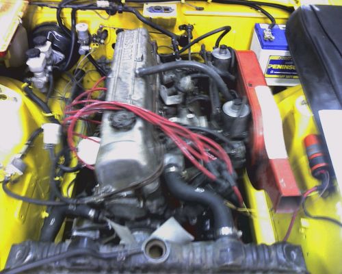

The above is a quote out of a ebay auction. Currently I have a Monster Tacho installed in my 240Z. I have a electronic dizzy and have a coil that does not use a ballast resistor.
Do I have to install a resistor to make the original 240Z tacho work correctly?
Sorry I do not have clearer pics I will try and get some better pics later.

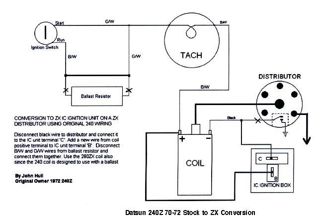

To get the 240 tacho to work with electronic dizzy this is what you need to do....

Posted 20 October 2008 - 05:31 PM
Where is the IC ignition box located?
#10 Scoota G
Scoota G
  • 4,213 posts
  • Location:Ballarat
  • Tagline:Mark
Posted 20 October 2008 - 05:42 PM
That is usually the one on the side of the electronic distributor.

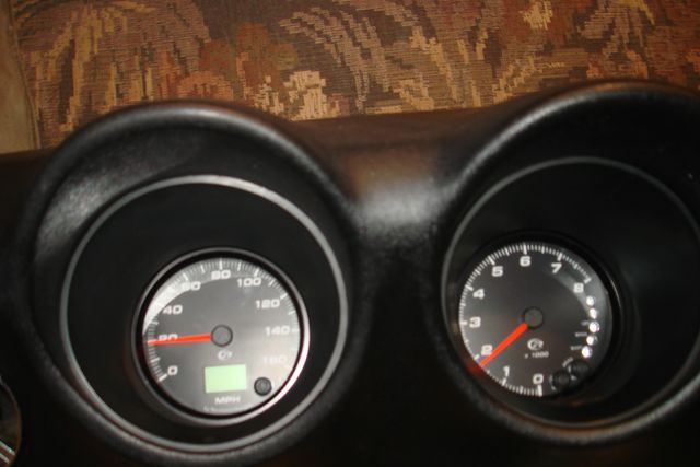

NZeder I have noticed you in a few posts on HybridZ with the Speedhut gauges. I have just upgraded my engine to a RB25det.
I am looking at getting a full set of Speedhut gauges myself, is this the way you will be going? Also for the smaller in dash gauges are you going 2"5/8th or 2"1/16th.
I noticed there is two setups on there one with black bezel rings and one with silver bezel rings.
SE PICS BELOW
Black Bezel 2"5/8th and Silver Bezel 2"1/16th
