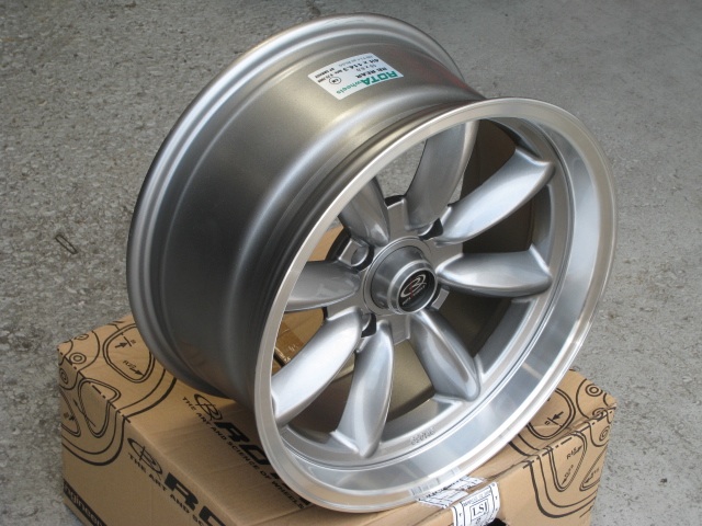

Well for reference - my old 240z road/race car had 298x28 VT front rotors and clearance was not a problem with the Rota RB-R 16x8 that I had on the car. I even installed the rims on a mates 240z race car which has 12.2x1.25 or 309mm x 32mm with a Wilwood type caliper (US Brake F88i = same spec and dimensions as the Wilwood Billet Superlights) and clearance was not an issue and in fact they almost cleared the 15x8 Rota RB's that I had also but the calipers fouled just a little so these would have worked with a smaller rotor ie 298mm x 32mm or 11.75" x 1.25" as the 12.2" were just a little too large for the 15" rims with the caliper on his race car - I am sure with a different caliper the large rotor would have worked in the 15" Rota's but 16" were not a problem at all. So you should be fine.

no sorry I only know this because the guy i got them from was running 16".
I haven't fitted these brakes to my zed yet nor do i have rims that will fit over them

I don't think the RB or the RB-R will have these issues. I say this as the design of the RB/RB-R is one that has more alloy in them, two they have more spokes, three are a lot heavier than rims shown in the pics. Remember the superlite look/style was designed in the 60's and these for years (and still today) are the choice of rim for rallies of all kinds.
I have seen a few rims centre ripped out here at our tracks in NZ most are these skinny type spoke design which the RB/RB-R are not.

We have had no issues with any of the Rota wheels we have sold in the last three years. I think these 'exploded' wheels are the result of damage to the back of the spokes, rather than weakness in the wheel itself. There is usually more to the story than the owner cares to admit in these cases.

Will the 16x8s fit under stock (unrolled) guards?

Stevo, I asked ben that question a while back
16x7 on the fronts 195/55 or 205/55
16x8 on the rears   225/50
Theres some pictures on here or HybirdZ with some zeds with them on
Hope that helps

Pics of my old 240z with rota RB-R 16x8 +10 with stock guards and suspension ie no coil overs (the front will not work with this offset on a 260z front strut as the spring perch will fowl the rim)
tyres are 225/45/16

The Rota Grid 16x8 +10 will fit the front of a Zed with a 4mm spacer, so the 16x8 +4 Rota RB should fit without one. I'll check this on my Zed next week.

Yes, with 205/55 tyres

For those that are interested you can fit RB 16X7 and 16X8 both with a 4mm offset, tyres are 225/50 for the front and 245/45 for the back with no fouling, this is my example 260z 2+2.
