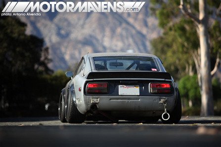

any one know the specs.
sure that's Widest Tyre/Rim combo u can get .
Posted Image

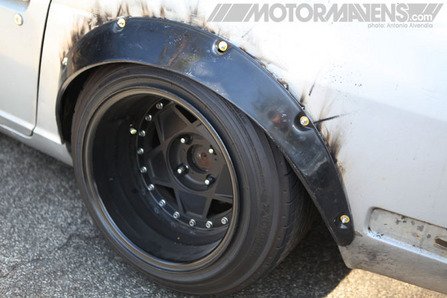

I recognise that car as the "rat rod z"... I remember the wells being cut with a plasma cutter to get those wheels to fit...
Posted Image
Nice bit of feral boso style though... :) FYI the tyres are stretched out 225's so not so much tread amyway :P

That is a little too nuts for me.  Would not be able to get it into my driveway!  Waaaaay to low.
Plasma cutter!?  I am cringing at the idea of chopping the guards already.....
Will stick to Jays dark grey 2+2 for inspiration I reckon.  Seems to have ticked most of the boxes for me and only chopped a little away.
