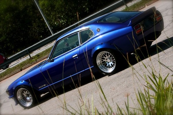

Posted 11 January 2010 - 06:48 PM
pulling up an old post here...
The picture of the 260z 2+2 in the post is exactly the look I want to achieve. Has inspired me to do something very similar.
From my research, this car is "apparently" running 17x10 rear (with 255/40x17 tyre) and 17x9.5 front (with 235/40x17).  Now - I have been reading thru posts...but still getting my head around things.  If I understand - to fit this sort of rubber - it would seem that coil over suspension is the only way?  I see various prices quoted for this, but nothing firm.  Also there's a mention of Fulcrum Suspension who do good work, but they are in QLD.
So..what I need to clarify is the following...
1. To fit 17x9.5 (or 17x10) with bigger 255/40x17 (as per 260z in the post), I must fit coil over suspension (along with the various strut modifications required)?  Am I right?  Or after adding some decent koni classic struts and king springs can you fit that sort of Rim and rubber with std setup?
2. Seems like coil over gives flexibility for more wheel options anyway - can someone point me in the right direction for a contact in MELBOURNE who does this work on Z's?
Appreciate any advice you can offer.

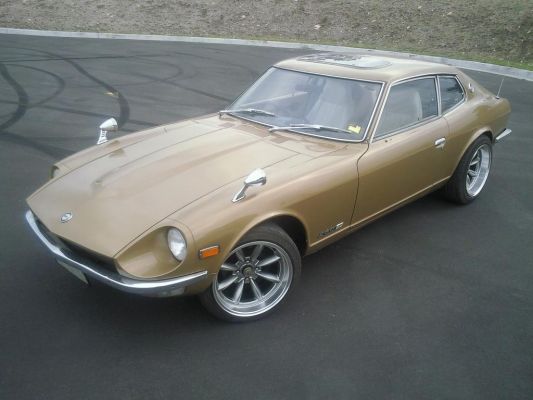

Ok.  I'm am confused.  Easily done.  So need some help.
This photo has rattled me a little.
These are RB's: 17x9.5 -19 rear and 17x9 -13 on the front apparently.
Car looks great, but I thought that 17's, with that particular offset combination, are supposed to "fill out" ZG flares.
Jpav (the owner) indicates that he has rolled the guards in the rear - that's it.  These do not look like they will fill out ZG's at all.  Even with a spacer.
I am missing something quite obvious here aren't I?  I did not think RB 17x9.5 -13 offset were supposed to fit under the rears guards without chopping them.
I also understand that Jays grey zed (that UK 2+2) with the Arrow style wheels (previously mentioned in this post), had very similar wheel size (.5" wider) and same offset as the RB's, yet his fill out ZG's really well.  Look totally different.
What am I missing here?

The only thing you are missing is the offset. I have 17x9's all round and fit under the guards easy. If you want flares then go for it. Then pich a rim/tyre combo with the offset to push the wheel out and fill the guard.

the 2+2 has slightly different offset (i think). The RB's in the offset you quoted will work great for 2 seaters.
The only rims you will find to fill out zgs are wats, roh, arrows, steelies, any cusatom wheels really or some old school jap ones, and maybe performance alloys (http://www.performan...els_classic.asp)

Keep in mind that +2's have a heap more wheel room in the rear than 2 seaters so you will need wheels with a more positive offset to fill out ZG flares if you are fitting them.

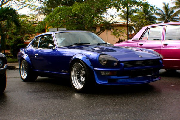

Sorry about all the questions, but since I am close to ordering wheels - really want to make sure I am on the right track...
Also know this has been done to death on the 2 seaters...so apologies.  Figured this may help some others with 2+2 tho.
Been thinking about this some more.....
Jay's 2+2 in previous posts definitely has the following:
"Suspension is Eibach lowering springs and standard shocks and no spacers.
Offset is 17 x 10 -19mm offset and front 17 x 9.5 -13."
EXACTLY same offset as RB Rotas above.
Only diff is half an inch in Width - which is a bit over a 1cm.
Similar dimensions, but they look WAY different to RB's.  Better I think (on a 2+2 anyways).
If you can imagine popping flares on the 2+2 with RB's posted above - I could easily see the RB's getting a bit lost under the extra guard width.
I just can't believe Jays 2+2 and the Blue 2+2 below, have EXACTLY the same offset as the RB's above.  Blue Z has same dimension wheels as Jays Grey 2+2 as well (10" rear and 9.5" front).
Crazy how different they all look....
Same offsets!
Dimitri - not sure going positive will help fill out the ZG's though?  Thought it would be more important (visually at least) to go negative offset?
