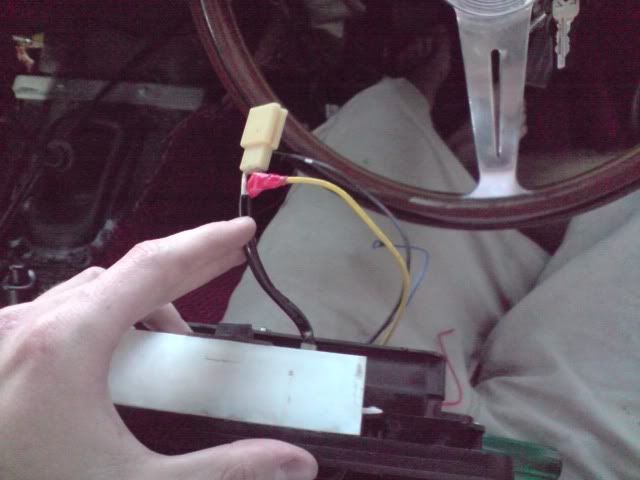

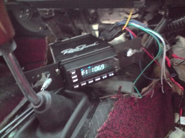

Well I took a risk and bought it without hearing anyone elses experience with the unit. Many thanks to sexual_sushi for his help and tools for this job.
The install was pretty straight forward.
Assemble Retrosound Stereo. The paper template they give is pretty good for the 260. Probably the hardest part of the whole install is taking the square faceplate that they supply and modifying it, as instructed, to be the shape of the 260z one.
Remove Center Console and then remove old stereo.

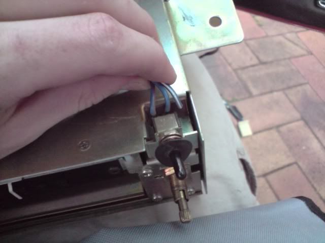

I then detached the wires to the electric motor for my aerial because I'm pretty sure theres no way to make the Retrosound unit integrate it. I plan to plug this into one of my switch blanks in the future.
Posted Image
The U bracket that fastens to either side of the centre console needs a hole drilled in it so that the 'backstrap' part of the head unit can be attached to it. This just provides a bit of extra support for the rear of it.
Mount the head unit into the center console using the supplied screws. The kit I had only contained 6 of 8 nuts of this special american electrical thread. Big f*ck around trying to source these. I found some at Jaycar. Wasted a day visiting supercheap, bunnings, autobarn and a private specialist nut and bolt store. To their credit the private store 'The bolt shop' at enoggera knew what the thread was and told me that Jaycar would have it.

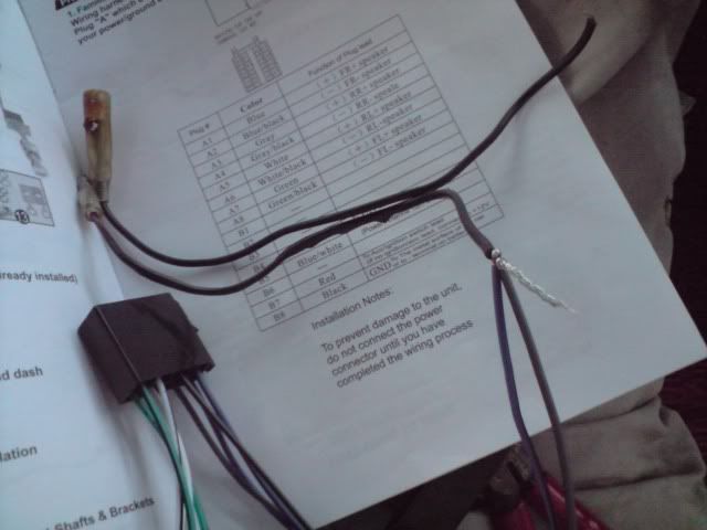

Wiring is pretty straight forward. The unit needs 2 12V supplies, one special independent of ignition to keep the memory and the other is just the standard one that I attached to the old wiring.
I attached the wire to the light above the air vents for constant 12V. Using voltmeter none of the other wires that were easily available had 12V when ignition was off.
Posted Image

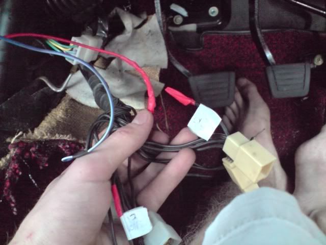

Here is the wire I cut and tagged that was the 12V for the old power supply. I found it using a voltmeter easily enough.
Posted Image
I still have the stock speakers so I connected both channels to the two wires that I had available from the Mono setup. I intend to get a local car audio store to make a copy of sexual_sushi's speakerbox to put into my own Z. Should be cheaper than the ~$500-600 from the states
Mmmm stereo -> mono
Posted Image

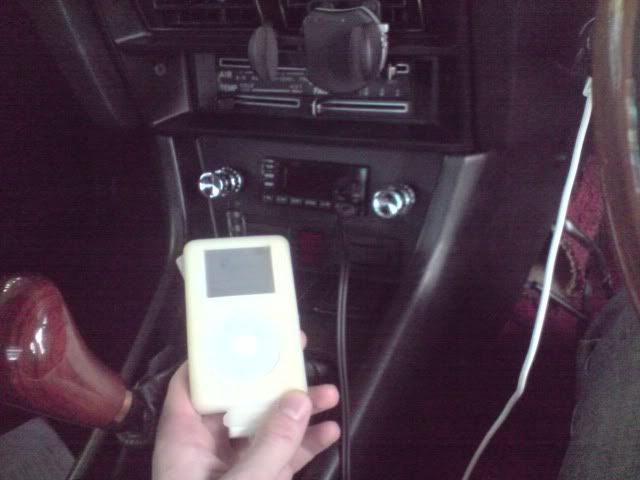

Here is a pic of me testing the setup with a local FM station.
Posted Image
Anyway, once the unit is mounted onto the console, get it almost into position, plug everything in, then bolt it up. Easy
All of this can be seen done by the company in an example 280z here: http://flickr.com/ph...405267593/show/
I haven't got any pics of the completed setup yet, I'll get on it and post them here when I have some good light and remember to do it. My initial impressions of the setup is that it is exactly as described, and several people have commented on its authentic style.

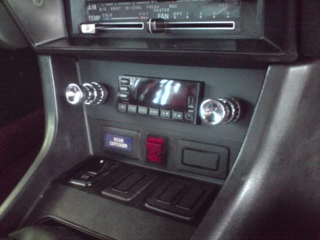

Well here it is:
Posted Image
Posted Image

Posted 29 October 2008 - 10:46 PM
tidy :D
cant even see your fail marks :P haha
how did the wet and dry go? help out?
