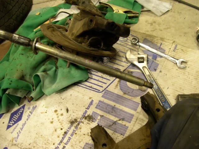

I had the same problem a few months back trying to remove the spindle pins, looked up on the net and found out about the pullers
Took me a trip to bunnings and 4-5hrs to get both pins out, still have the puller I made up sitting in the shed.
I must say tho there is a huge amount of stress put on the puller and found that after pulling my two pin out it's almost a throwaway job, it quickly destroys the nuts and thread

Found a few pictures
Posted Image
Posted Image

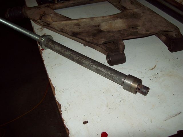

I knocked one up quickly and cheaply that did the trick.
