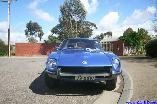

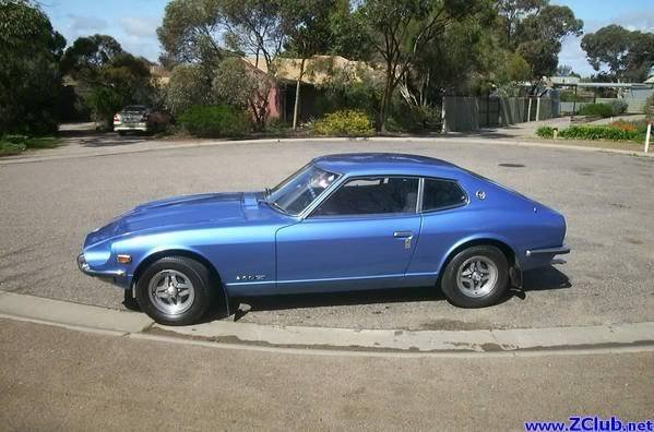

Hi all,
Bought a 260z 2+2 a year ago,  which came from austrailia the year before. was in mint condition with no rust at all.
Just finished doing alot of work on her including a full l28 engine build.
Anyway a couple of pics.  anyone know the car?

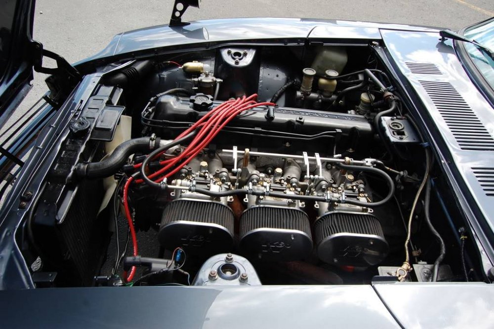

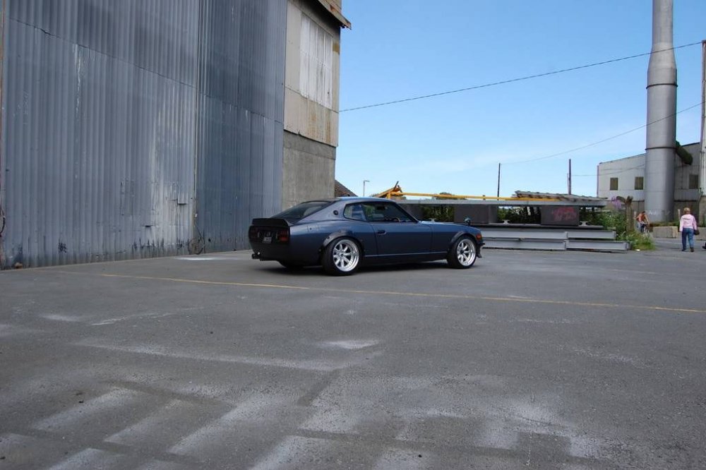

how it looks now

damn you, youve got the deep dish alloys
#5 datsun-jay
datsun-jay
  • 36 posts
  • Location:Wicklow, Ireland
Posted 15 July 2008 - 01:50 AM
haha,  Yeah I had to get the alloys custom made in the UK as I couldn't find anything with a deep dish to fit properly, they were expensive but worth it.

That's a sweet looking Bus you have there ;D
What are the make of the rims?
#8 datsun-jay
datsun-jay
  • 36 posts
Posted 15 July 2008 - 07:31 AM
Thanks for the comments,
The rims are made by Image wheels in the Uk,  they are custom made to whatever size you want.

Thanks for the comments guys, yeah the shaved rear end turned out well, and the blacked out chrome works well with the colour.
the engine spec is
86.1mm flat top pistons
6-1 msa manifold (header)
all new bearings
p90a head shaved 2mm
.495  290  cam
triple dellortos
thats about it,  only have 400 miles on the engine, gonna get a few more on it then get it set up properly on a rolling road.

Wow Jay,
That looks fantastic. It's the wheels that top it off, amazing how good it makes it look when the flares are filled properly.
