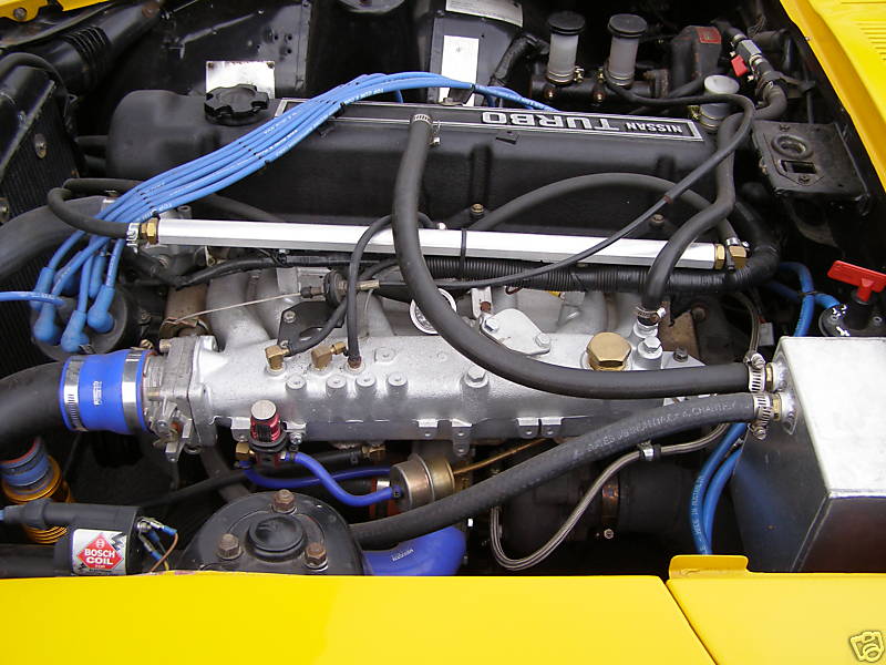

Here are the specs as the car is now
Engine
-F54 block
-P90 head (combustion chamber volume slightly increased, 8.2:1 CR)
-Standard crank
-Standard rods
-CP flat top forged pistons
-B grind cam
-Horrible looking home made log style exhaust manifold, does the job so it's still there :)
-T04 turbo
-Turbosmart dual stage boost controller (normally set around 13psi)
-Tial external wastegate with screamer pipe
-4" dump pipe
-3" mandrel bent exhaust
-Huge custom made intercooler (I don't have any pics of this but it fills up the entire front of the car)
-Turbosmart BOV
-Commodore throttle body
-Modified 280ZX inlet manifold
-Bosch injectors (haven't been touched since i bought the car so I'm not sure on size)
-Custom fuel rail
-Holley Blue lift pump
-Custom surge tank
-Bosch main pump
-Haltech F9 computer
-4 core Torana radiator
-High pressure/volume oil pump
-Oil Cooler (currently fitting)

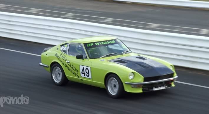

That's all I can think of for now.  Here are a few pics of the car in action.
Posted Image
http://www.circlewor...ssrnd3&start=90
http://www.circlewor...sr2-G1&start=45
http://www.circlewor...ssr2-G2&start=0
I run our state circuit racing series in a class called Targa class.  It's designed for modified street cars on DOT approved tyres with very little rules on modifications as long as you don't get too close to a sports sedan.  It's then split into three classes based on capacity and times (how much money you want to spend  ;D)  I run in the 2nd class (Targa B) which is mainly full of Skylines and Evos.  Sounds a bit dodgey but the class structure works well and it usually draws the most entries to each round of the series.
In my first season last year we had a few relaibility problems but were still very happy with 2nd for the series.  This year the car has been great (touch wood) and I'm just in the lead of the series with two round wins and a third after three rounds.  2nd place is only a handful of points behind me and there's still four rounds to go.  Then there's those Evo's which will be straight back into the game if we get a wet meeting or two  ::)
