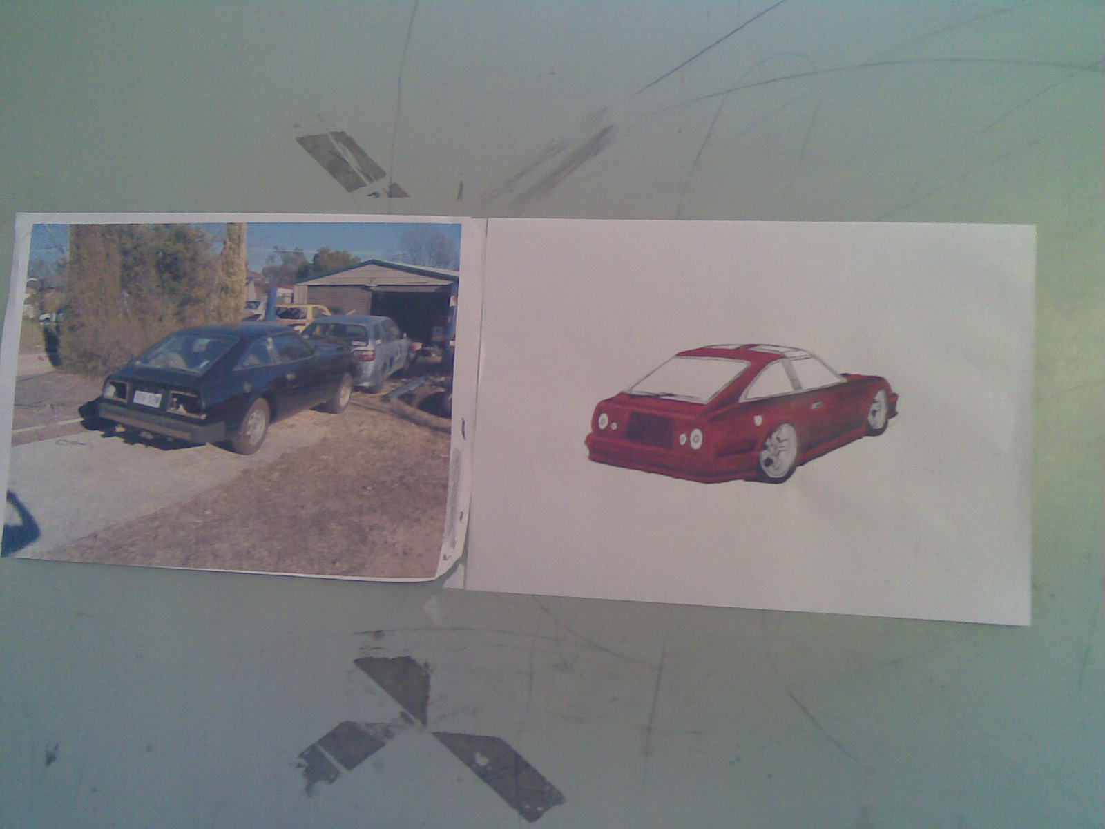

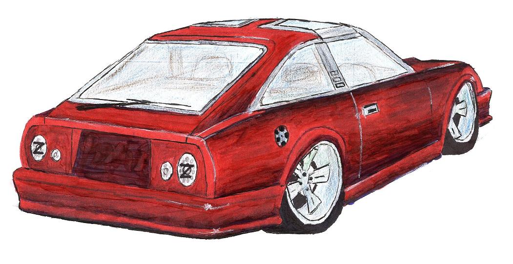

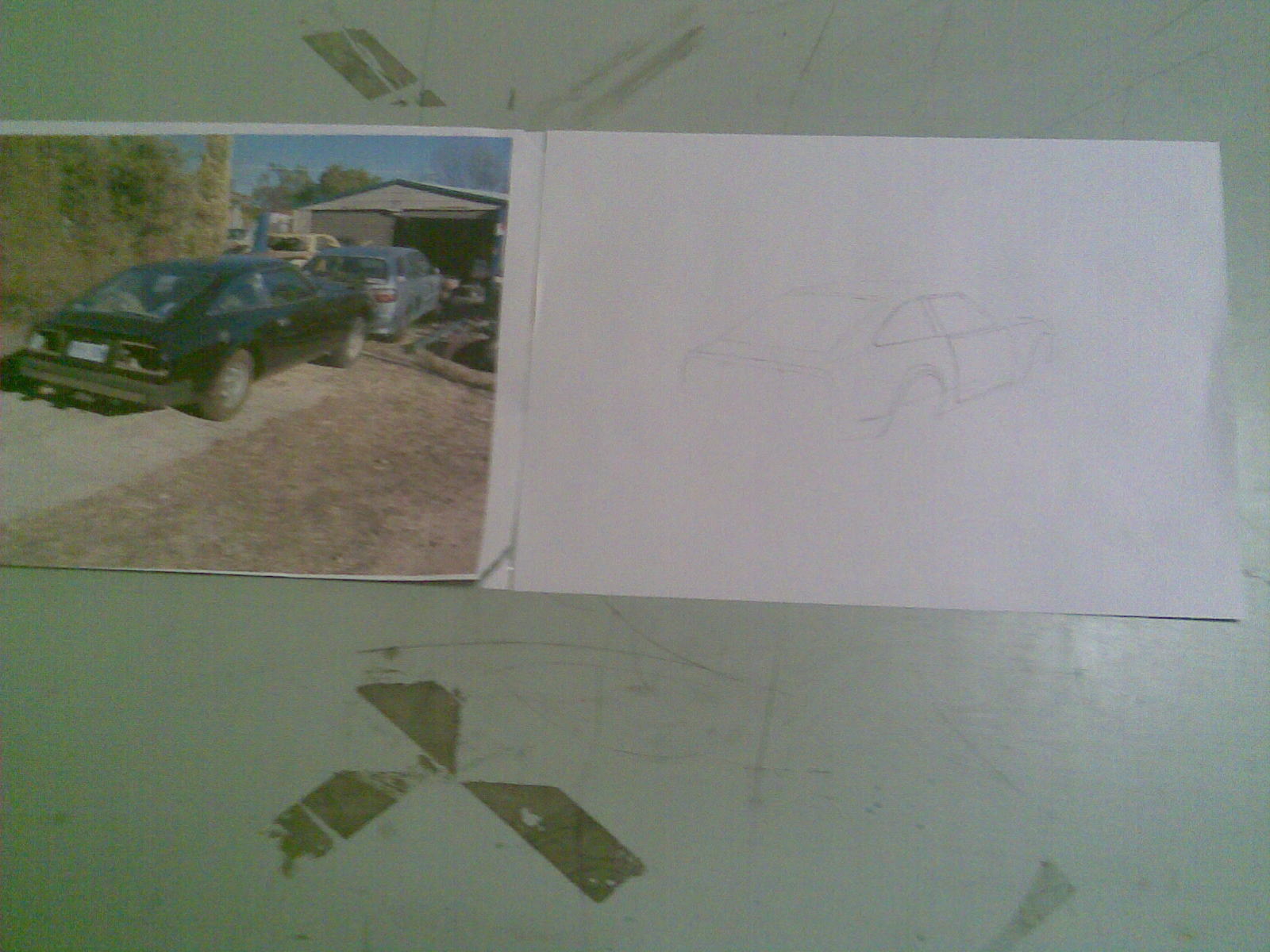

OK so i had the cops called the otherday by a a neighbor complaning i was being to loud for 6:30 on a thursday night. I dont know who. On one side my mate was beating out the pannels on someones car (pannel beater). on the other side the kid was working on his motorbike. next to him was a guy building his rally car. across the road there were several teans experimenting with there cars. Personally i think that i was the quiet one. but the cops turned up told me to quieten it up for the night because there was a complant about my place. so the guys from around the street all came out we had an agument with the cops so the cops told me to pack it up for the night. so i turned the mill and everything in the garage off and as i walked out i could here all the others working on there cars. so pissed off i went inside to my drawing board and sat down to take out my anger with some new tools a friend that manages an art store put me on to. this is the product.

Faark, you idn't tell me bout that one, what a wanker.  It's gonna look the goods though.
what you talking about willis. I showed you that drawing. now i cant wait for it to be done lol.
